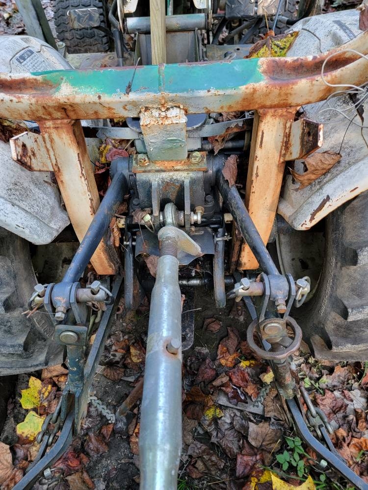

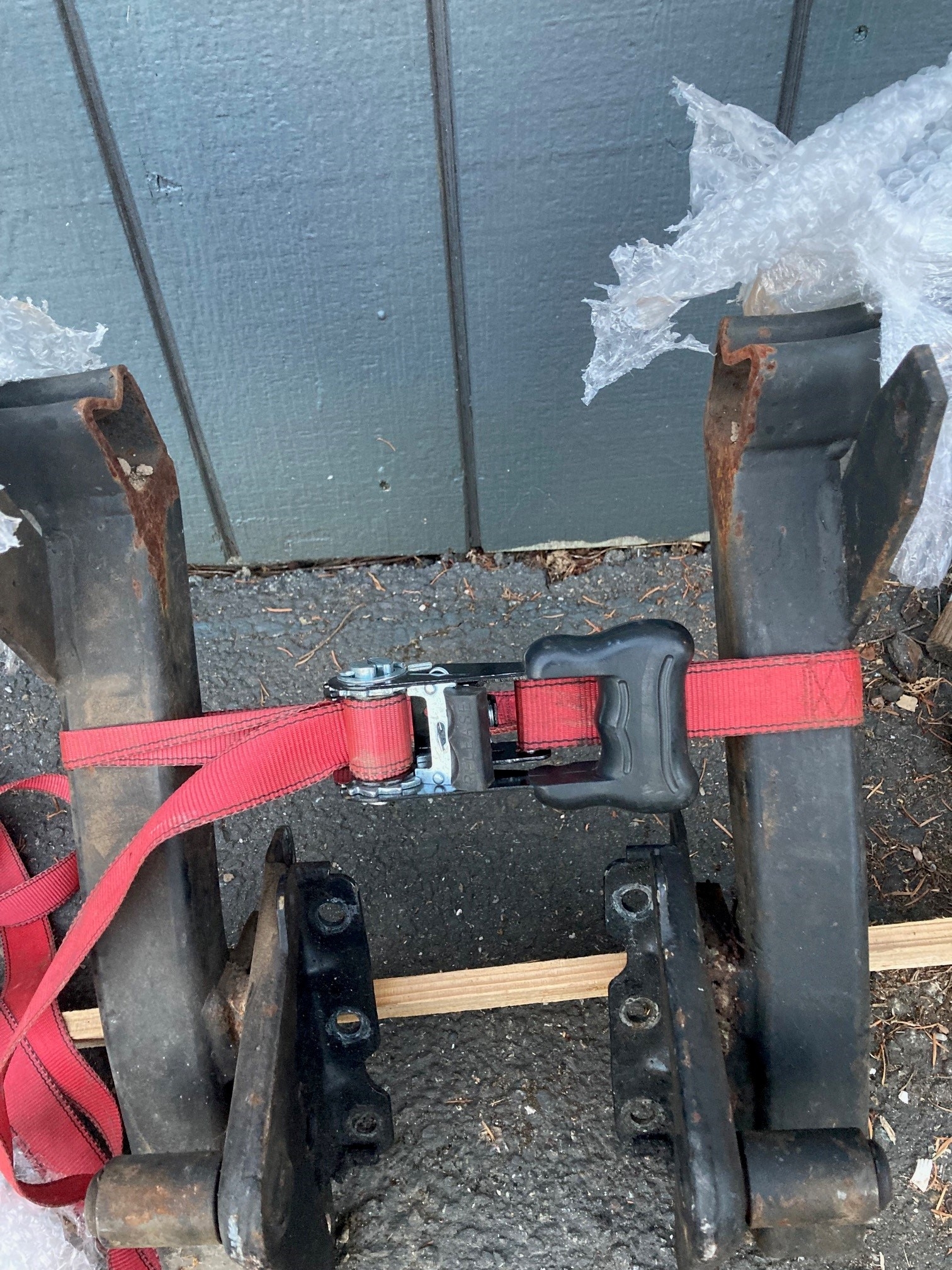

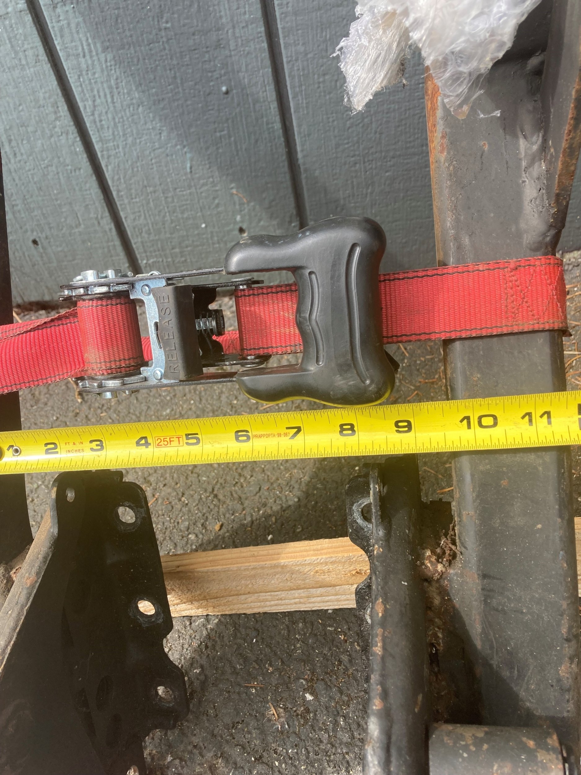

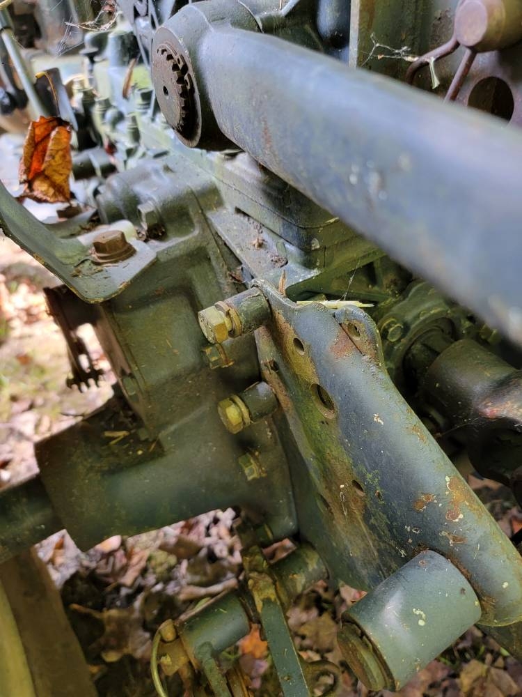

My used ROPS from a White Field Boss 16 arrived. I panicked at first since the side-to-side bolt dimension of the 6-bolt pattern was around 9", but once I pulled them together with a ratchet strap to the approx. 6" spacing my G154 has everything looks to line up. The 3-point arms look to be a tight fit inside the ROPS risers. Clockwork tight. I won't be able to get around to installing these for a few days. If you have or could take a picture of this area of your tractor, I would appreciate it. It certainly would put my mind at ease considering the price of these shipping them out here.

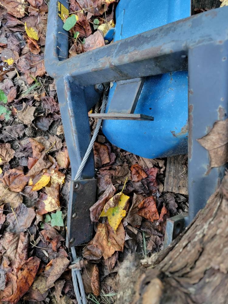

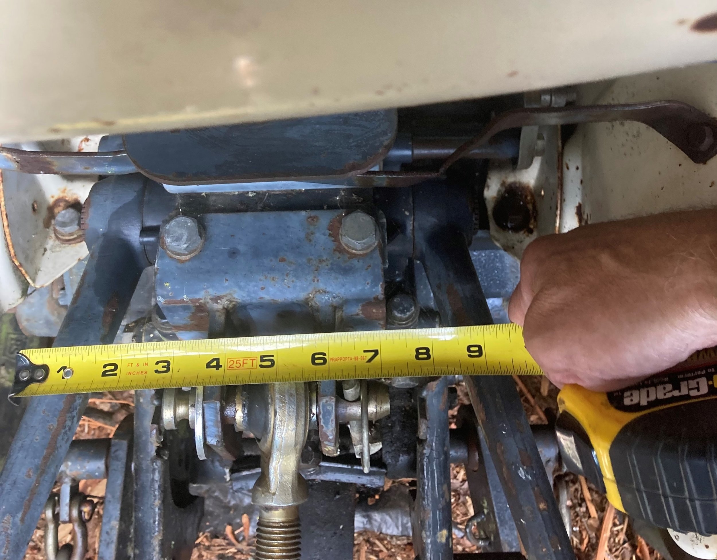

That's a different bolt up then either of mine. Mine bolts on 3 bolts near those plates. Here's a pic of the bolts used. It's the bolts with spacers on them. Will get pic of the roll over and then of the mounted one. Hope this helps at the moment.
   / Bolens G-174 has a side transmission drain plug and two rear axle plugs #37
Here the other pics.

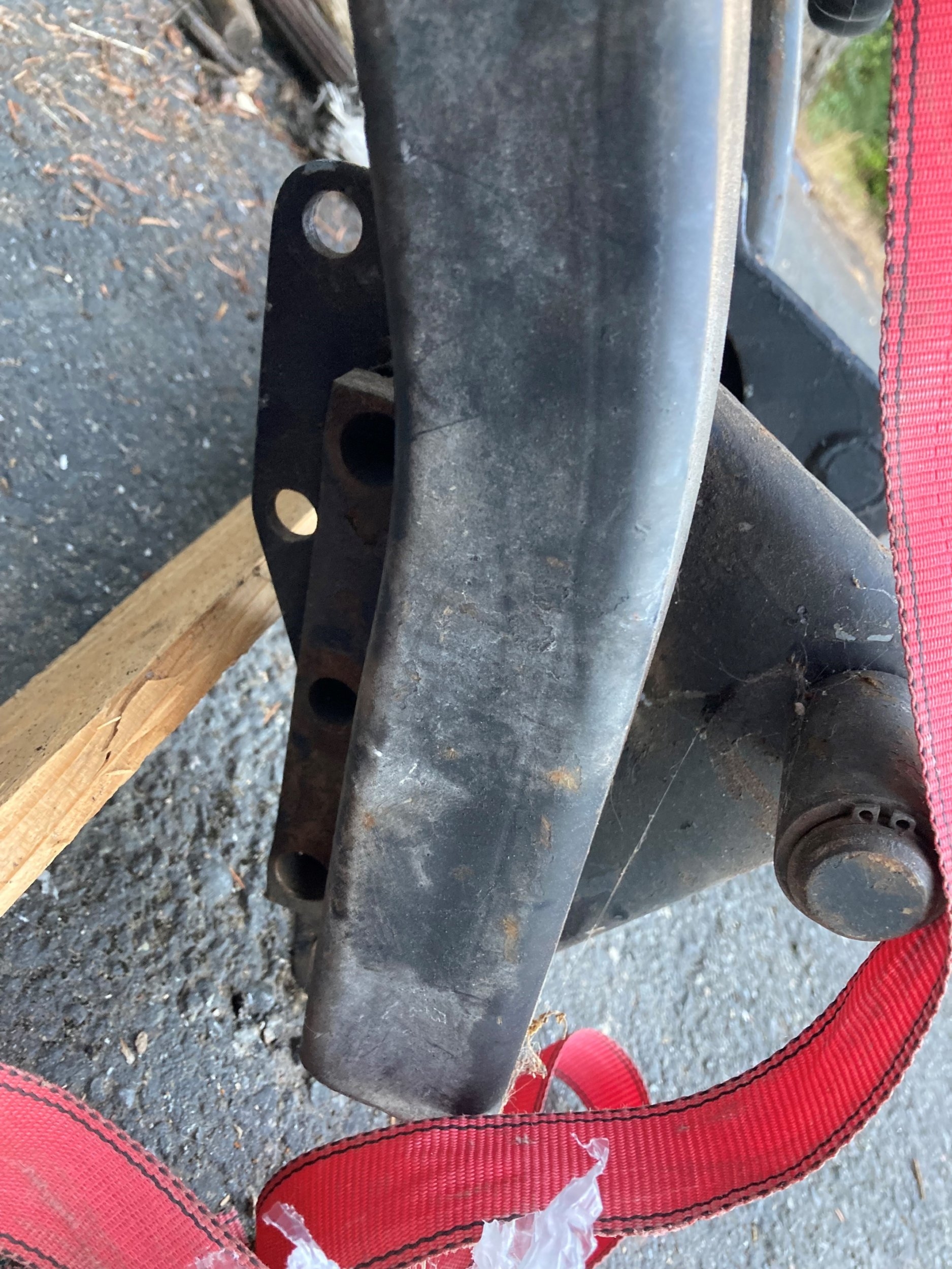

Interesting. Mine are welded onto the "side brackets" on each side of the PTO shaft. Interestingly, it has the 3-bolt pattern on each side of the ROPS riser, but they welded it anyway. I'll see how it goes, maybe this weekend. I could grind the welds off and go back to the bolts, I guess. They cut the center section out for some reason so maybe they had some other attachment that it interfered with. Thanks for the pictures.

They probably cut the center section do to some interference with the seat. Mine will hit it on a good rut! It is what it is. If you have a welder, maybe put something across there for some support and possibly attach to top of the top link mount. That's the way both of mine are. Can't say that I'd really trust them on a rollover anyway! It does make get on and off a bit easier though.
