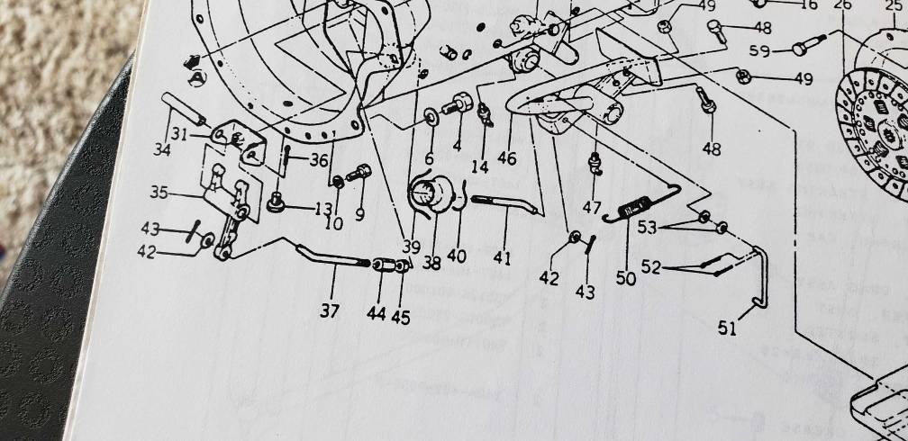

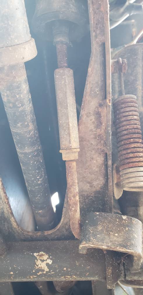

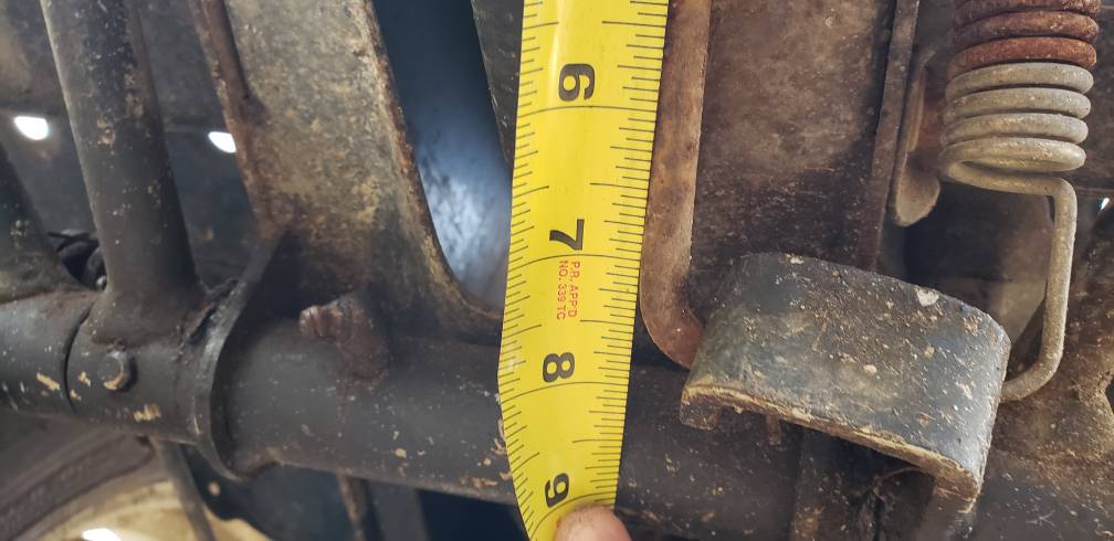

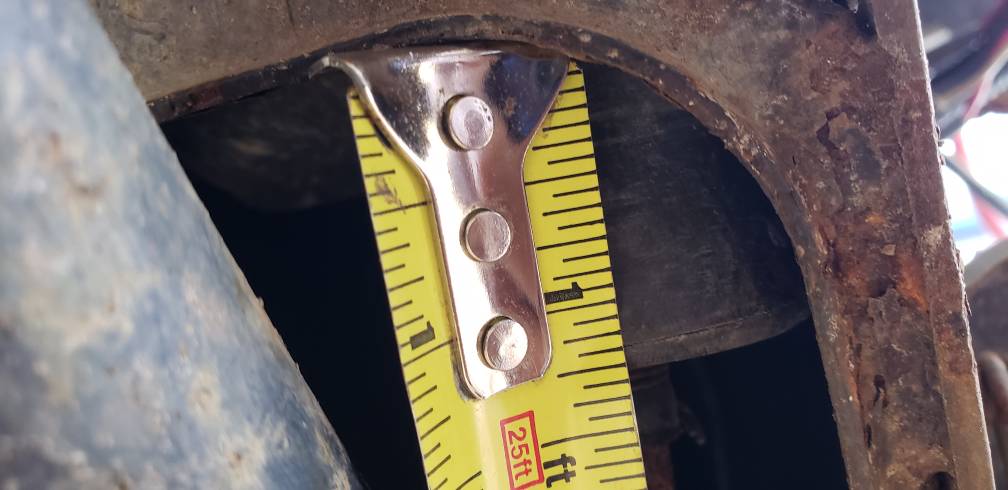

Good morning, went out and got some photos. Adjustment needs to be with clutch pedal up (engaged) there's needs to be little to no play. That way it pulls pivot to full extension to push pressure plate. Hopefully you don't need a clutch pack! Measurement is to case as I can't get beyond boot. You might need to split to do repair correctly. I did just to check other components.

Bolens #'s for clutch rod, 1873965, 1873967(coupler), 1860304 (M8 nut), 1873966 - first rod is left hand.
Do have a Bolens parts manual, but online look up for White Field Boss 16 is updated.
