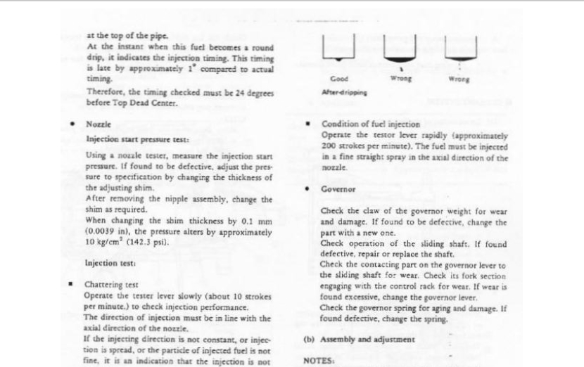

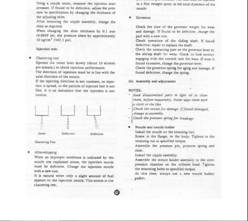

I found these two pages from the service manual that may help. Sorry, it is a bit blurry, It is actually one page, but I had to save it as two:
