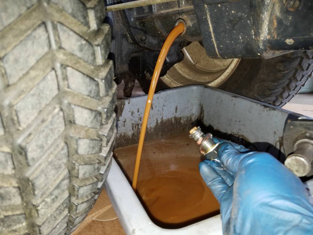

Did the hydro fluid change, all went well. Filter fits nicely, cleaned all 3 screens. I must comment on how brittle they are. Anyone thinking of doing this, treat them like a wet napkin. The one inline near the RF tire was the dirtiest. I did have to remove the LR tire to remove one of the screens. I got probably an extra 2 quarts out of the system by pushing fluid out of the cooler lines, and tipping the tractor towards the right where the drain plug is.
Noise level seems the same, but at least it's maintained better now.
Oh by the way, searching h1502 on YouTube brings up a few cold start up videos and a short ride. I posted those of this tractor.
Anyway thanks for the help and information. This thread has to be the most complete source of info on this topic.
