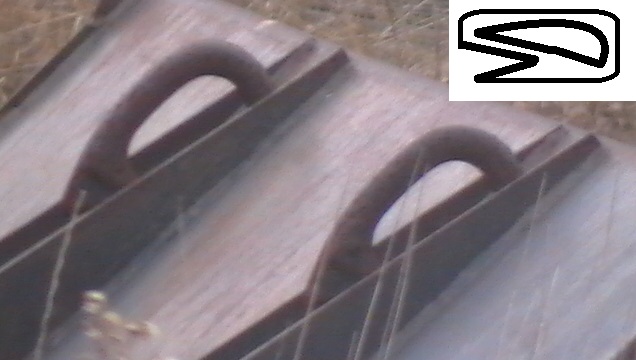

not sure what the name of these hooks are. more of a "handle", and a hook combo.
the V notch, accepts different size chain (it slops / angles) down into the notch. so it really does not matter what type of chain size i have on hand. and the larger D makes it nice for some straps. without binding / pinching the straps up and getting caught up.
have used the hole / D handle part a few times to drop end of a chain into. (to long of a chain and needing to wrap it up, so it is not dangling)
some cases, i may end up tilting bucket in such a way that a hook would allow a chain to come off the hook on the bucket, and end up using the D handle. other times, re using the V notch for chain and say pulling fence post. or dealing with larger tree limbs.
my issue with "pins" is they bend, and may not work a particular chain i have on hand and fit through lines. or hook to pin is to loose and hook keeps wanting to fall off.
