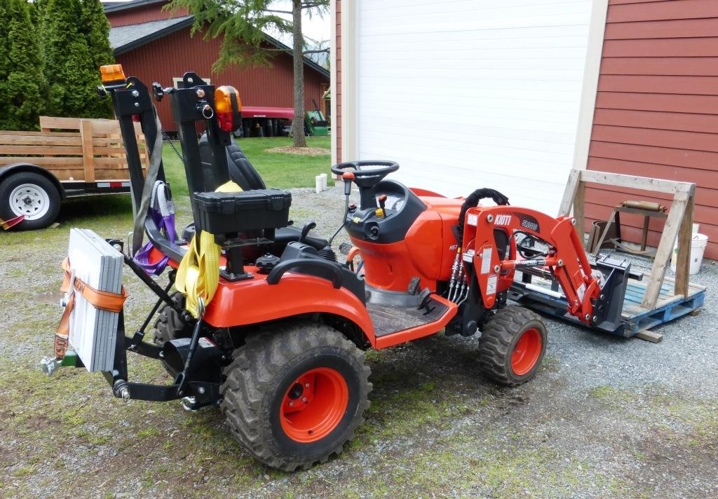

I'll need to move a 700# pallet a few times in mid-April and have sourced a loaner set of forks for when I need them, but I'm wondering if that's a reasonable thing to do. Would 700# on 48" forks extended off the loader be likely to deform the bucket? I can't imagine the cutting edge will hurt but what about the bucket itself?

If you have the usual light duty bucket that most units come with, using bolt on -clamp on forks to move a 700 pound skid of anything will most likely impart a 'smile' in the lower sheet of it because the bottom sheet isn't stout enough to carry the weight on the forks, no matter what the forks are rated at. Why I have both light duty 'material' buckets and heavy duty double bottom sheet excavation buckets, not that I'd use bolt on forks anyway, because I would never use them I use dedicated forks as in forks only, never clamp on anything.
The closer the forks are to the FEL pivot point, the better. 700 pounds of weight on a set of forks far away from the pivot point and installed on a bucket equates to way too much weight on a snigle bottom sheet and will make your bucket 'smile'. Removing the smile is an involved (and expensive) task. I repair quite a few smiling buckets in my fab shop and like I said, it's an involved job that requires cutting the side sheets from the bottom sheet, hydraulically straightening the bottom sheet and then rewelding the side sheets back in place. You have to cut off the side sheets no matter what because when the bottom sheet smiles, it sucks in the side sheets as well so they must be cut off and rewelded. Best bet is to just not use bolt on forks at all or load them well under their rated capacity. Cheaping out on bolt on forks is a recipe for disaster and an expensive fix.

700 lbs, depending on how it is piled on the pallet (vertically) might be close to the limit on lift and stability for a 2000lb tractor.
The farther the load is out in front of the loader/bucket pivot points the greater the stability and lift issues. Forks in front of a bucket is convenient/safe for occasional light stuff, but not great for heavy lifts particularly on irregular surfaces, turns and/or high lifts ....and/or all of these combined.
Also, you will certainly need some rear ballast for stability.
The CK20 specs says it weighs about 400lbs more than my CS2220, but the farther forward load on bucket-mounted forks may offset this tractor weight advantage.
Purpose built pallet forks are always a safer way to move pallets and irregular loads.

I previously owned a CK20s and currently own a CK2510 (same basic tractor) I can confirm you likely wouldn't be able to lift the pallet much off the ground if it moves it at all. It would lift it if you took the bucket off and put on forks. With the CK20 I made a set of pin on forks, so while not as handy it really didn't take me more than a couple minutes to swap back and forth.
With loaded rear tires you can just lift the max capacity without the rears coming off the ground. (assuming you swap bucket for forks) But the rear will be very light.
If you don't have to lift the pallet from a high point (back of a delivery truck) and don't have to place it on a high point another option would be forks on the 3pth - much more lift capacity, much easier on the tractor (not stressing front axle) and easy to swap on/off. The only thing with that is to really make the forks on the rear useful you would benefit having a hydraulic top link if you don't already. I use forks on both rear and front, and when I can I use the rear over the front. Just something else to consider.
