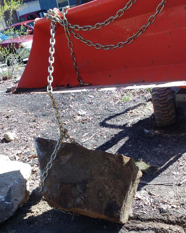

I have putting the Ken's Bolt on hooks to good use on my BX2370.
