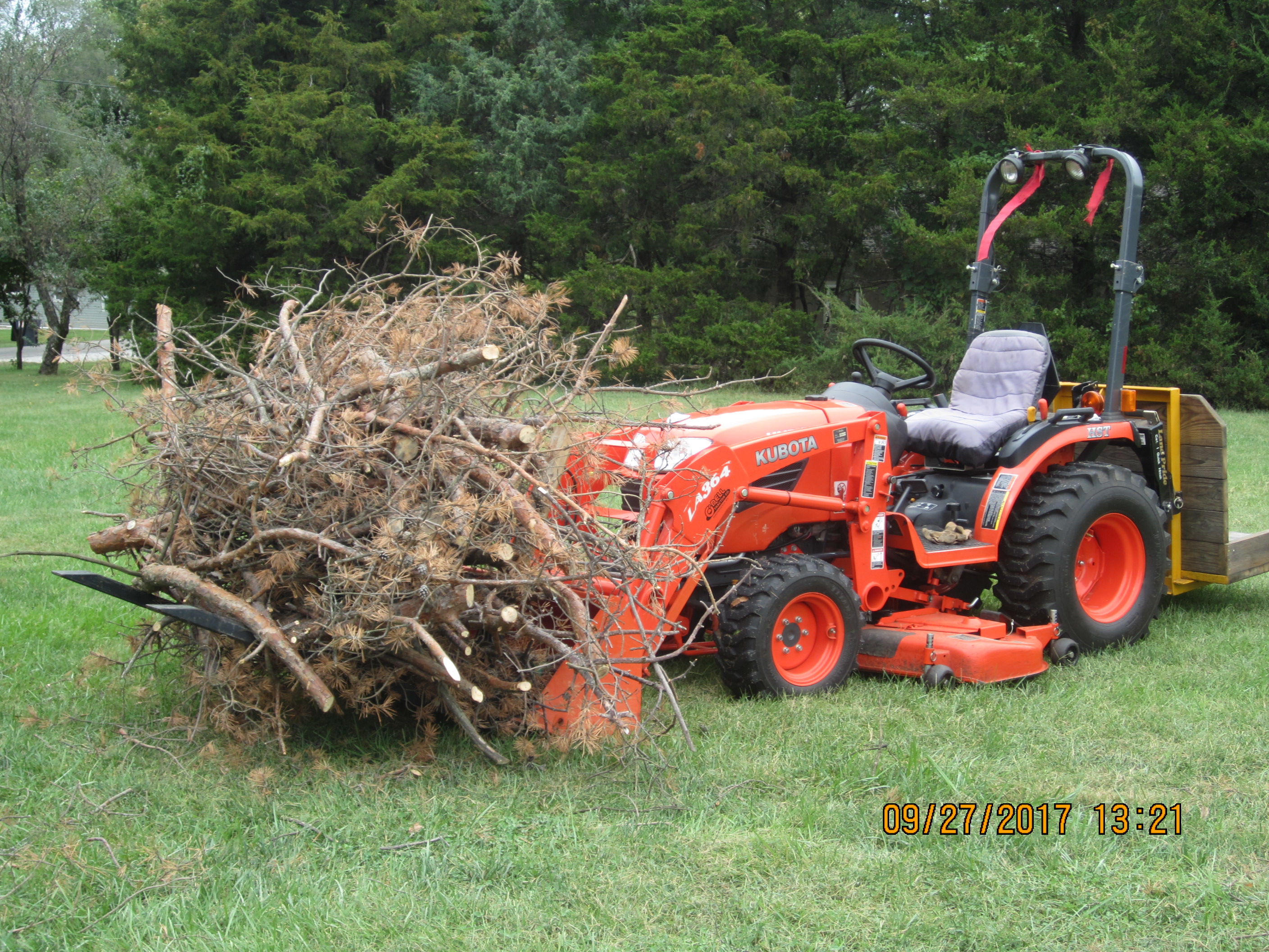

As I was researching the pallets forks I found some debris forks which I thought was better for my use. They were made by Titan
and are well built and very easy to attach to the bucket. After using them for a few days I have found I need some weight on the rear end of this little tractor. So I am now trying to figure out how to add weight to the rear end. Any ideas would be greatly appreciated.

For rear ballast, I have a 55 gallon drum of concrete. Just take a 1 1/8" (if you have Cat II, 7/8" for Cat I) piece of roundbar and put it through the barrel about 1/3 of the way down, and fill with concrete. When you pick up the barrel with the 3 point, the bottom rests against the drawbar. No need for a top link. Some people get technical for a rear ballast box, but the barrel is simple.
