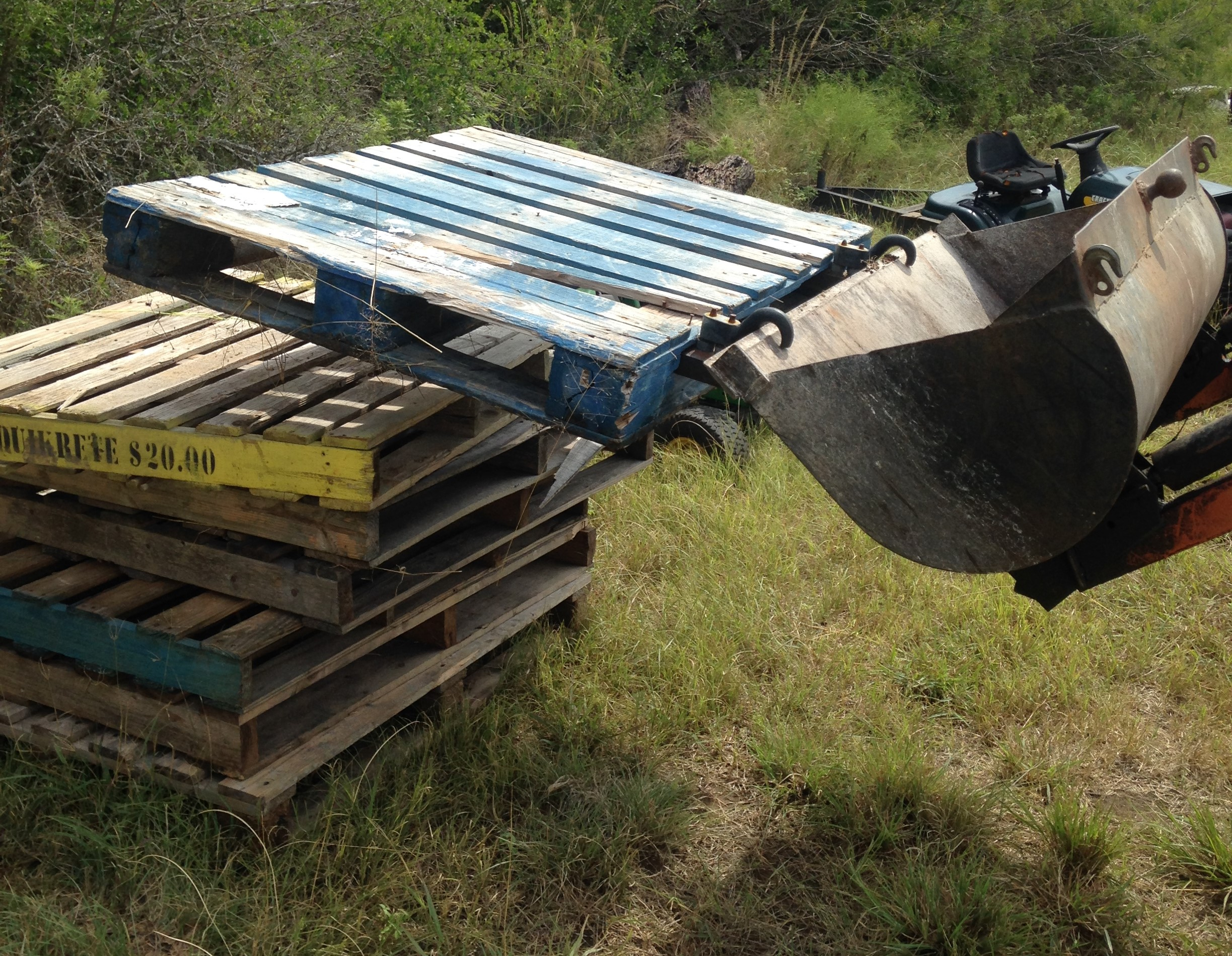

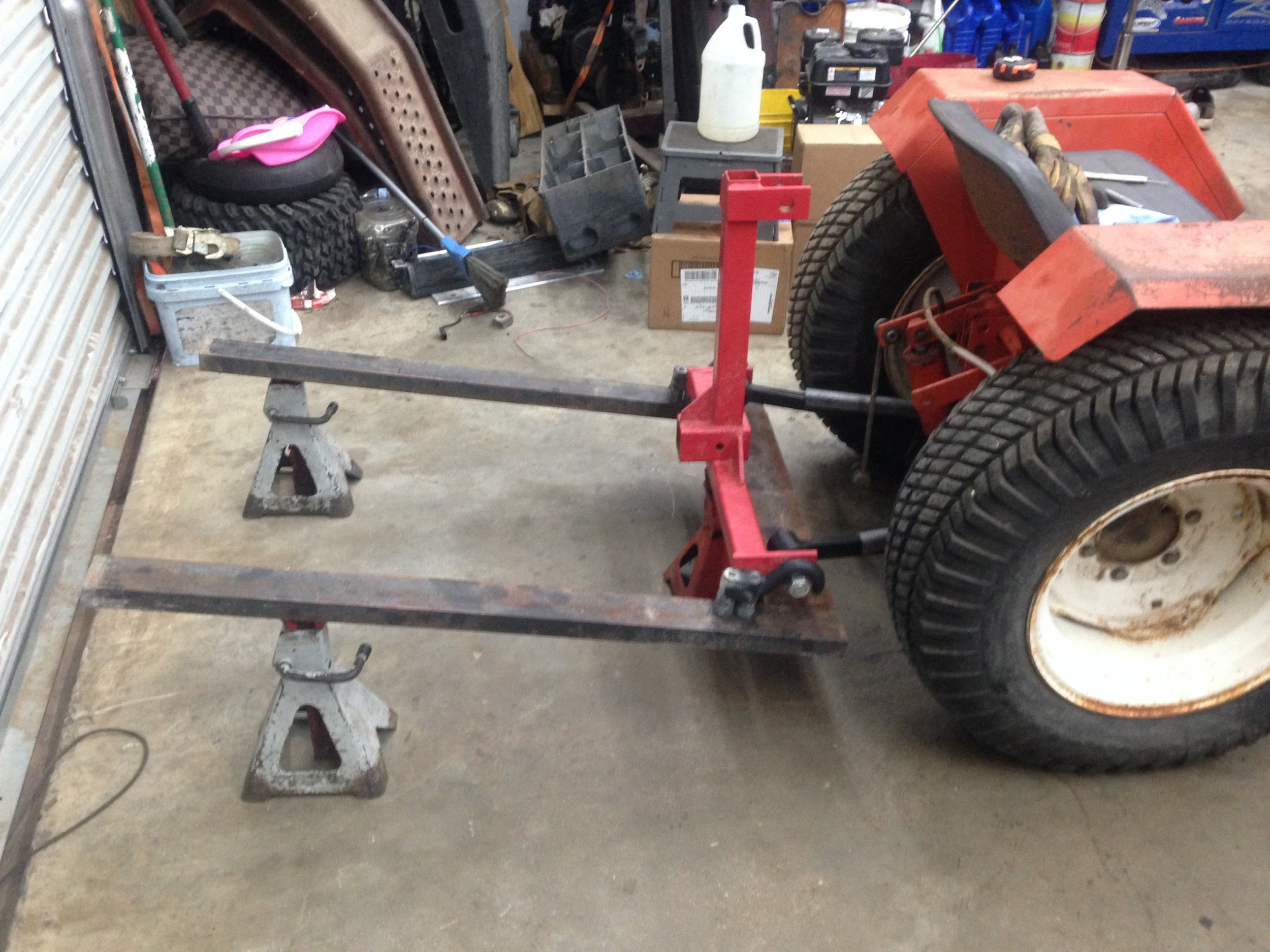

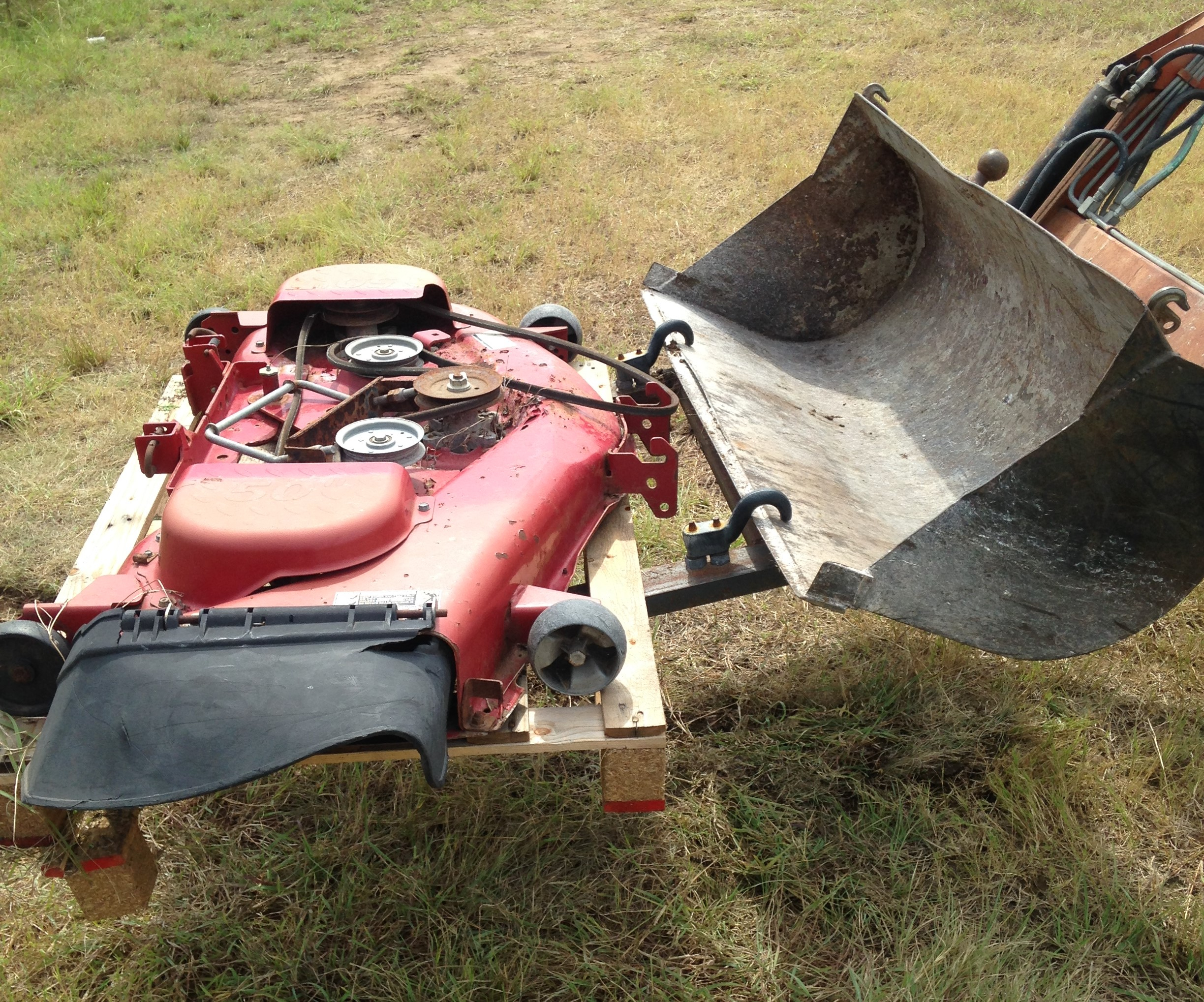

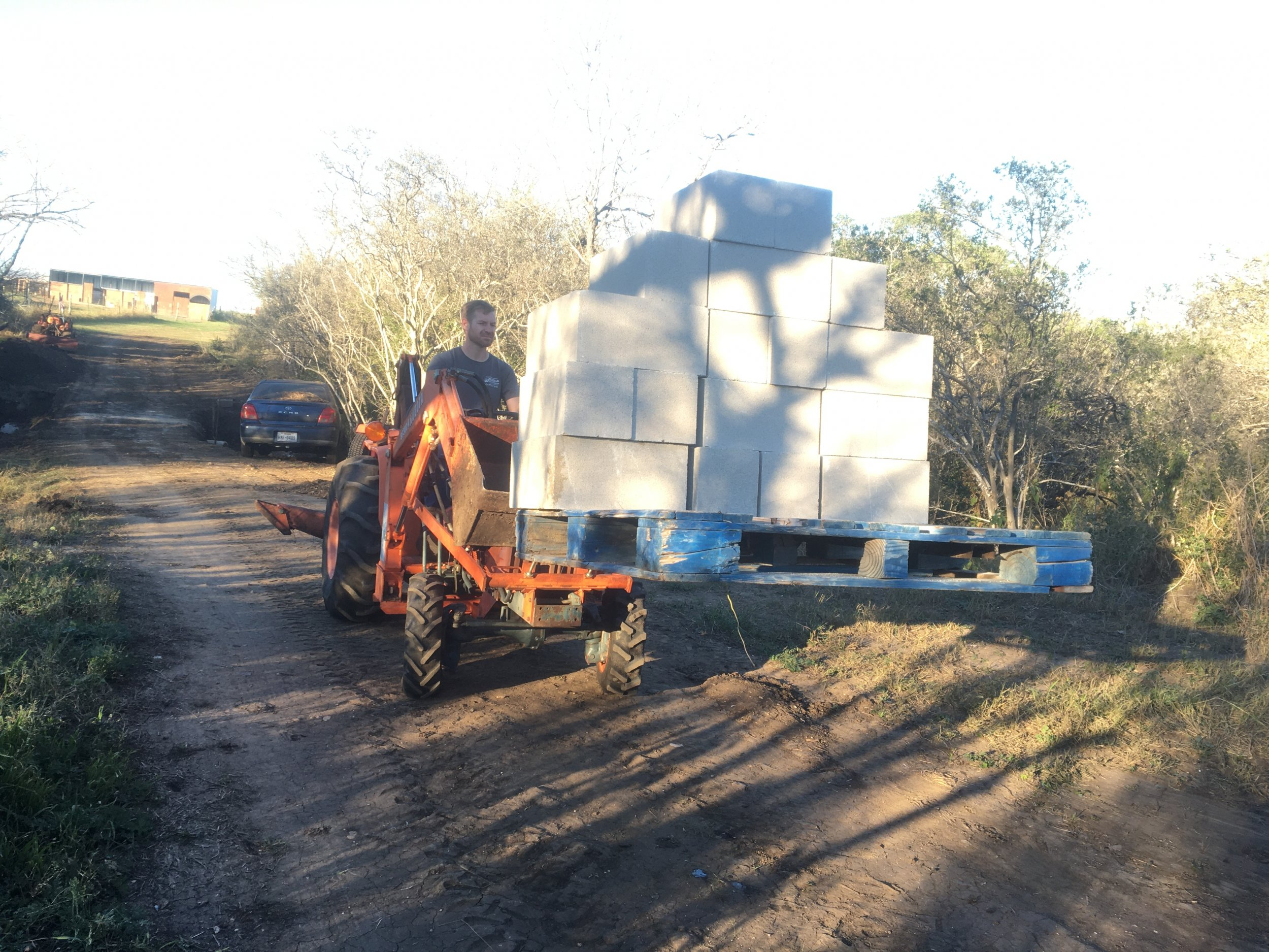

I got a great deal on overstock forks from netforks and made these that I can attach to the 3 point or the bucket. This lets me lift heavy things with the 3 point and stack small hay bales with the bucket.
This works for me now, but "next time" I'm getting a tractor with a quick change bucket.
