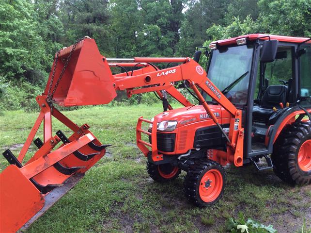

Ken's hooks look great & people who have them seemed to be very satisfied. My generic hooks came from Tractor Supply, before I had heard of Ken's. The bolt on hooks see a lot of use - prefer to work with rope instead of chain, whenever possible, and the hooks make this very convenient. A pair of grab links also lets me use chain, whenever the need arises.

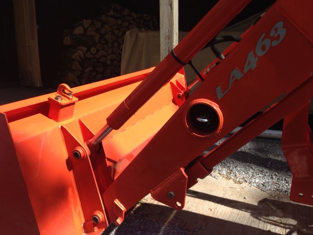

Chill before you drill ... curl your bucket all the way back and make sure you will have clearance between the hooks and the cylinder/pivot parts. By the power of dumb luck, mine have a smidge of clearance.
That bucket steel will harden on you if you don't keep the bit making chips at a good rate, so use a sharp, high quality bit in a powerful drill and some Tap Magic or similar cutting fluid to help manage the heat. My installation included some hefty backing washers and liberal use of anti-seize on the threads, just in case I ever need to remove them.

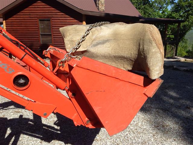

This issue for the OP is the turned up lip on his bucket, it is a complete different design from the one you have. Here is picture of the same loader/bucket combo I believe he has:
There is limited room behind that lip to mount those large tow hooks, and the lip is narrow and will not support the weight the loader can lift-plus the leverage thing I mentioned before.

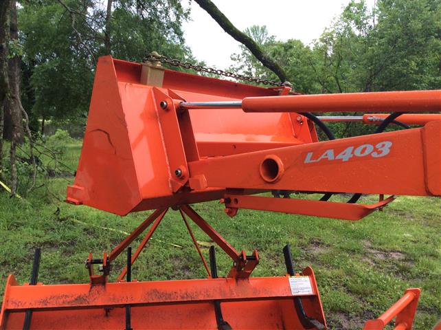

Yup, he has a great point for sure-But this is a non-issue with our setup, there is plenty of clearance:

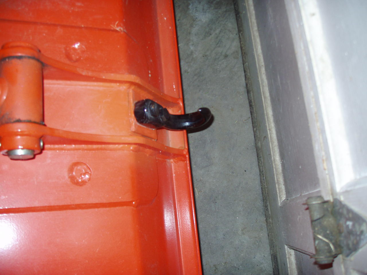

I added some additional stock to the top and inside of the bucket when I bolted a hook on to my BX bucket.
