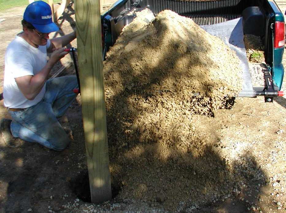

I will tell you what I understand, and hopefully others can follow with evidence. It is not a problem with the concrete itself in contact with the pressure treated pole, it is the moisture that will be trapped inside the concrete. Any wood will last much longer if kept dry. By casting a concrete "cup" around the pole, water will go in and never drain out. So the pole just sets in it till it rots off, probably at ground level, in my experience. Drainage is the key. On my 3 pole buildings, I backfilled with crushed rock (above the concrete collar) for good drainage.
So here's the whole plan: Drill/dig holes, measure depth to ensure below frost, toss in one spade of crushed rock and pack it into the bottom of the hole with a 4" by 7 or 8 foot fence post, drive (maybe pre-drill) landscape spikes into each side of the pole, 8 inches from bottom leaving 3" sticking out and bend them up a little to make the whole thing smaller to fit the 12 inch hole, drop pole into hole, position and brace on two sides, mix some concrete enough to fill hole 1 foot deep around pole, let stand and harden, resist temptation to backfill hole full as long as possible in case you wish to tip poles to line them up better when you girt the walls, when you finally do backfill use crushed rock (3/4" minus), and tamp it in. Get at least one girt on up high before you settle on the poles' positions and backfill. Here's a pic of me and my S10 "dumptruck" backfilling a pole hole with crushed rock from the driveway.

Jim: I understand and agree with the problem of the concrete "cup" and water. I went ahead anyway with this thought in mind: 1) I put a form around the pole so that the concrete cup actually ended up about 4" above grade so that no water would run in between the pole and concrete. 2) The poles actually end up inside the structure after the girts and siding are put on so they are not exposed to any rain hitting them and running down the poles into the cup.

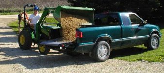

Yes, the Loadhandler is a great tool. I bought it just for this project. I found it a local Checker auto on closeout for 26 bucks! After using it, I was tempted to go back and buy the other one. Here I am loading the dumptruck...
