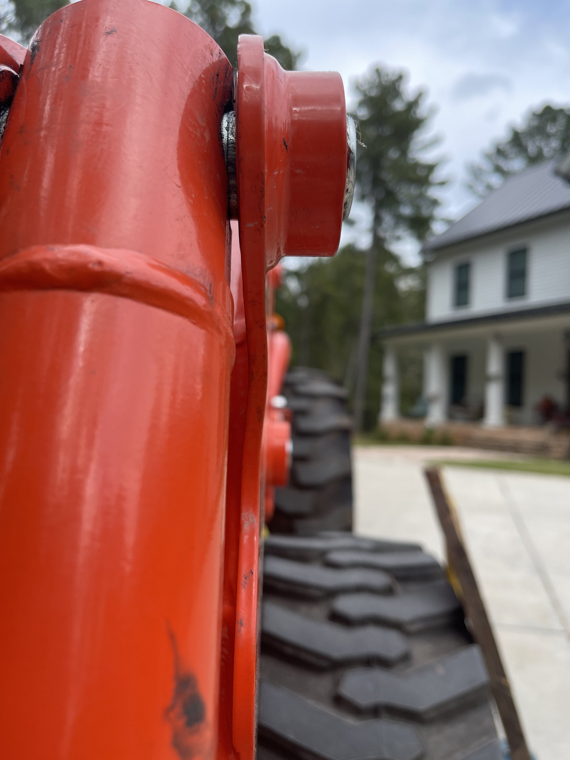

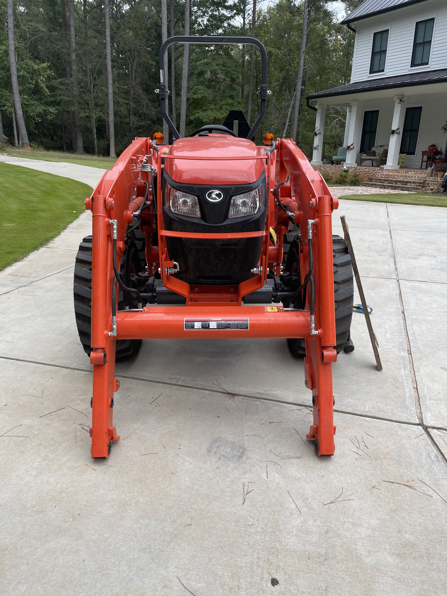

Thank you all for the great feedback and suggestions. I think I've located the issue. Starting starting to wonder if I really caused this or if I just happened to notice it recently. For reference, the tractor is basically brand new. I'm paranoid by nature and just assumed I had done something to break it, but this looks more like something that would happen if the loader was strapped incorrectly...
I took the SSQA off. It goes on/off relatively easily. No major misalignment from what I can tell. Of course, it's hard to tell when dealing with something that massive, but I didn't have to use any hammers or anything to get it off or on (ignore the sledge and the board in the pic... I grabbed them just in case). Pins came out with some initial knocks with the back end of a socket wrench and then I could pull them out by hand (using a rag for grip). Excluding the driver's left side cylinder, the loader arms slide easily into the SSQA.

I'm with LD1 on this....I cannot tell from the photos if it is bent or made that way or even maybe OK. But the first step is to figure that out.
And since it comes off easily I'd follow his suggestion to see if the various bushings and mounting points line up. Best way I can think of to do that is get some nice straight 5 and ten foot lengths of EMT 1/2 and 3/4" metal tubing at Home Depot. They are straight and cheap....then take the loader off, and put those lengths of EMT through the bushings from side to side and then stand back and see if you can determine if and where the bend is.
You aren't going to rest until you know if and where it is bent. But I'd bet you either have something you can fix easily, or use as is. As you suspect, a lot of the time it involves how the loader is bolted to the frame.
But whatever it is, you need to line up those mounting points in a perpendicular plane in order to see it better. Some long straight metal tubing rods will do that.

I can say with certainty that the curl cylinder attach lug is bent. The one on my MX doesn't have that kink in it. Not sure how I would fix that. Probably a lot of heat, a prybar and a big hammer.

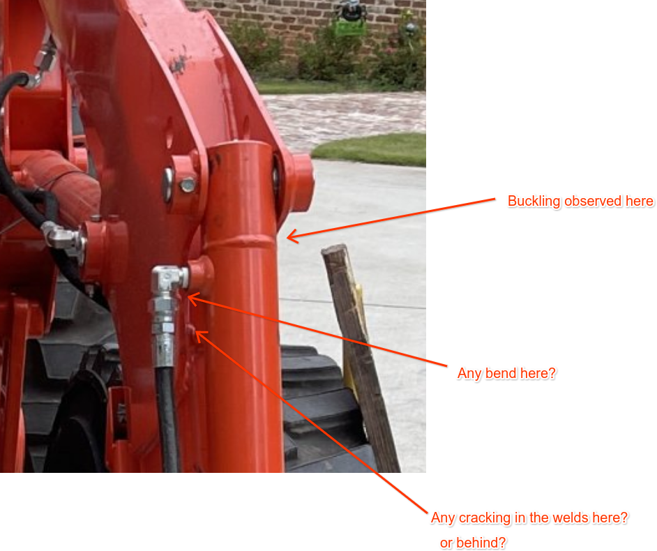

It looks to me like this could've happened via some serious stress was placed on the left side boom while dragging backwards. Basically the bend in the boom was slightly straightened, causing a slight buckling on the reinforcement web.
Is there a similar buckling on the inside web? Are there any sides of stress in that joint behind the web, or in any of the welds attaching it?
If there's any such signs, I'd look at having it repaired/strengthened.
If not, and things go back together easy enough, I'd use it as-is, but keep an eye out for further signs on either side.
Too bad we we dont have a view showing the other portion of that ear. I think it may be bowed inward a little. What I conjecture visually from your catch is that the ear is effectively twisted slightly CCW. That pin is probably in a bind. - Is it? Even if not quite, the alignment offset referenced from the other ear turns out to be enuf to cause the cyl skew observed. If deemed necessary I believe that micro kink could be taken out using two cheater augmented 24" "crescents" from HF. Careful control of action - reaction to select the position where bending takes place. Mild steel or brass shims on their jaws to prevent marring the ear.
