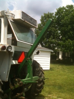

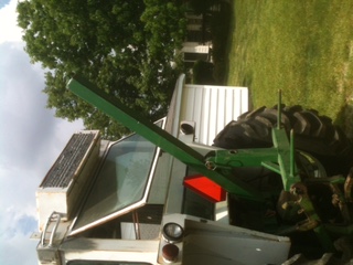

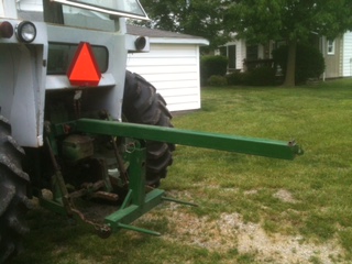

I built this a few years ago. I can put install a bale spear and use a top link for moving round bales, also. It's made from 4" X 1/4" square tubing. That is an Oliver 1555 53HP tractor and I've lifted some pretty heavy things with it. Full height is around 11 feet. I don't know why I can't remove that rotated picture. I can make the pictures larger if anyone is interested. :)
   / Boom lift.
You did the third class lever style, that's what I'm leaning towards.
