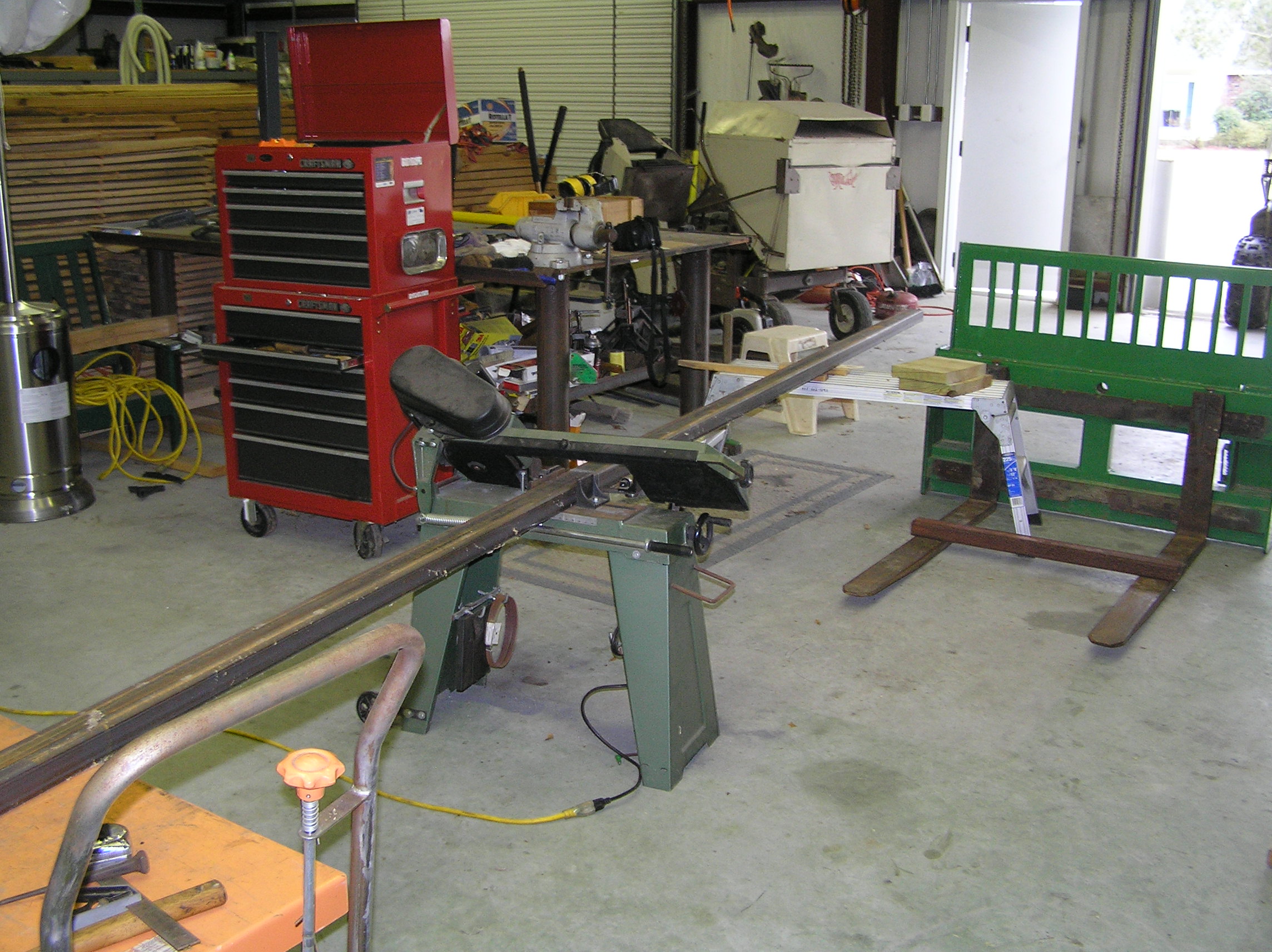

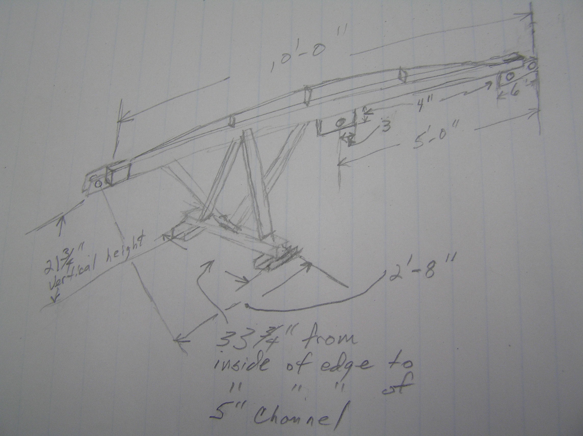

With the weather starting to get nicer, I just had to start getting into my shop and do something. I am going to build a boom pole to fit on my pallet forks. I have sketched up a design and am open for suggestions on doing this properly.

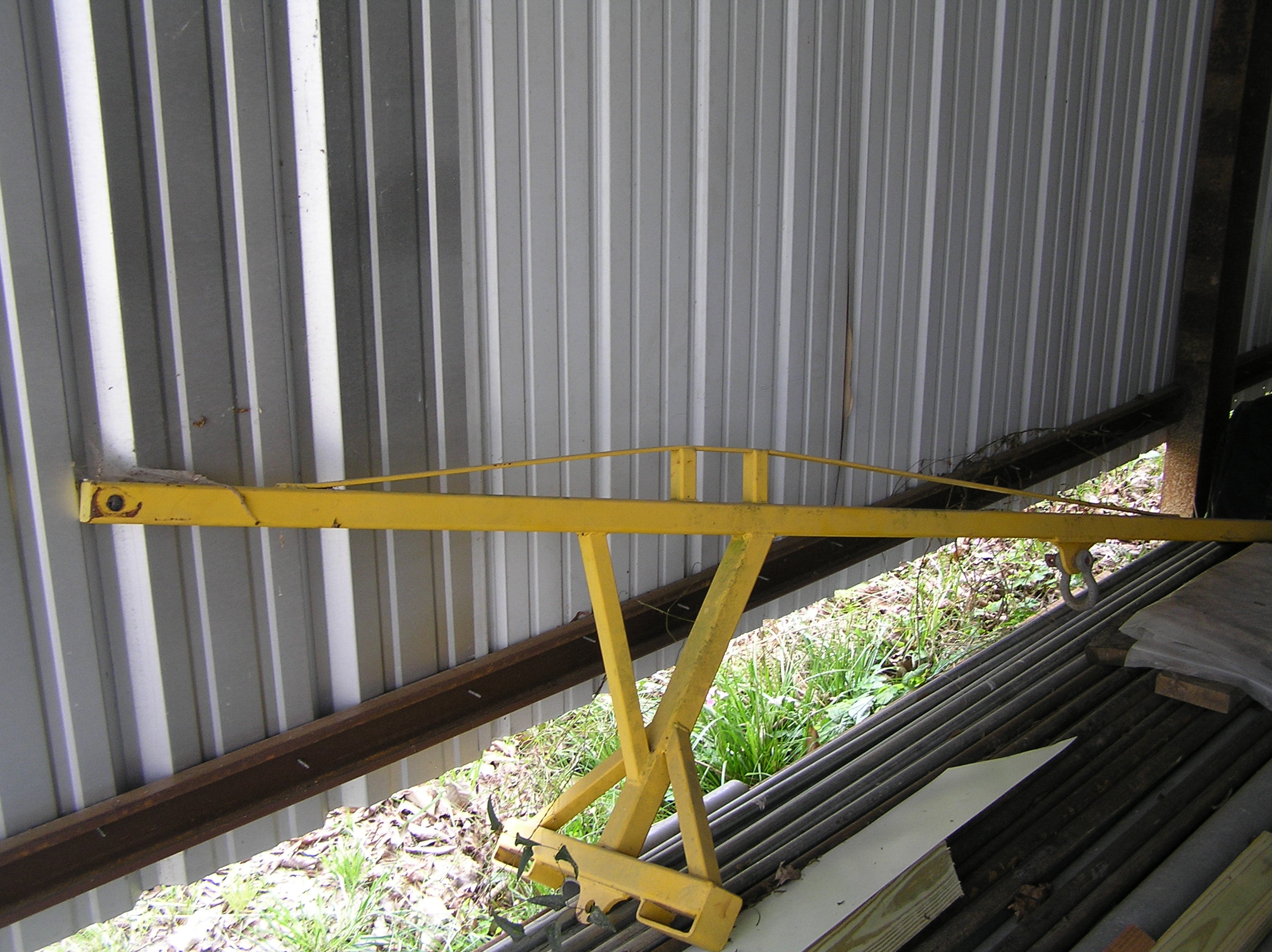

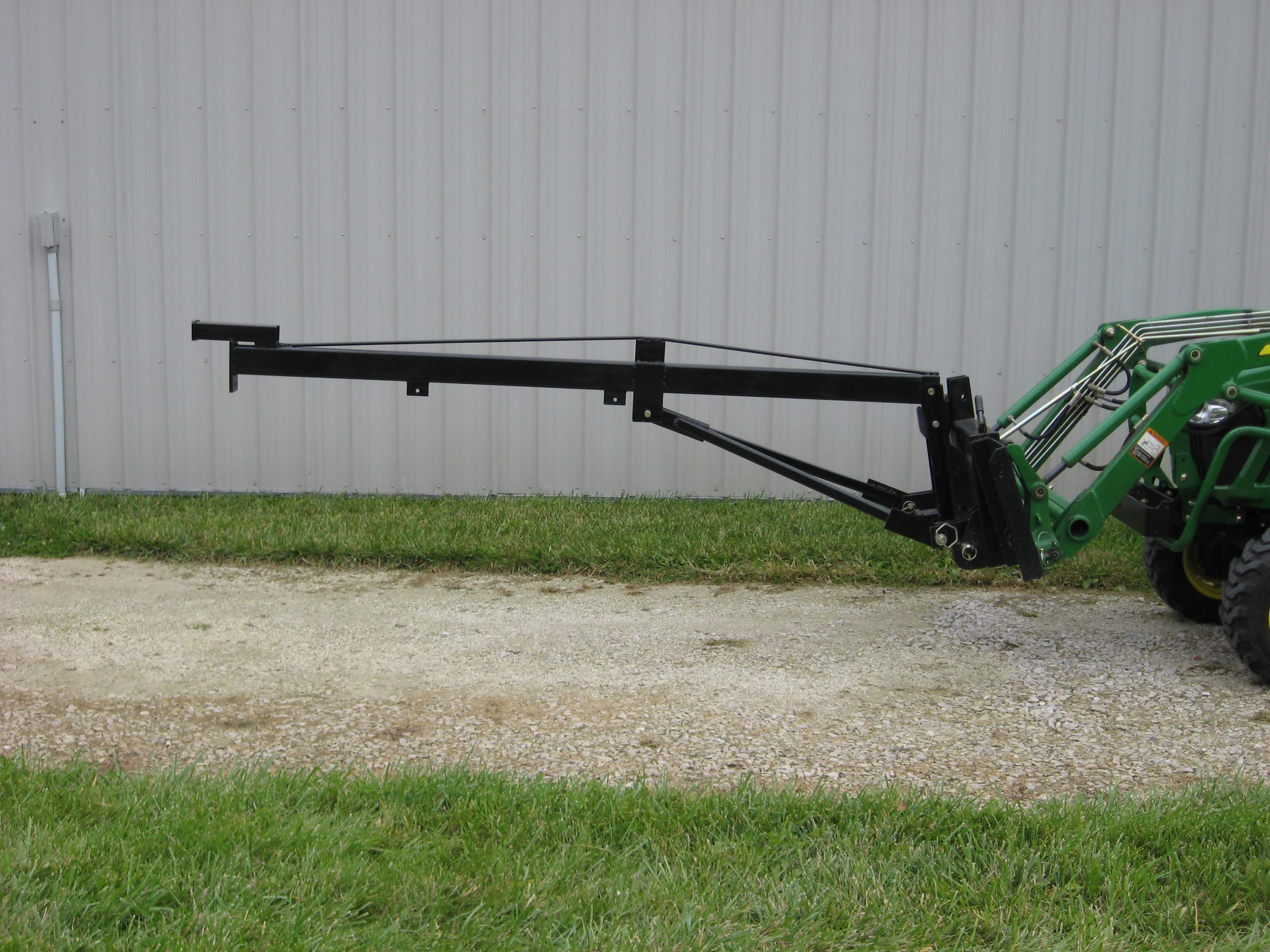

To give you some background, I have a JD-2640 with a Bush Hog loader. I am basing my design on a friend of mines boom pole.
My very rough sketch:
My friend's boom pole:

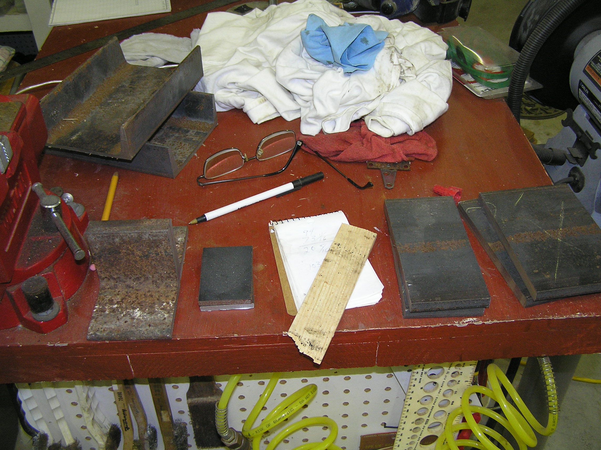

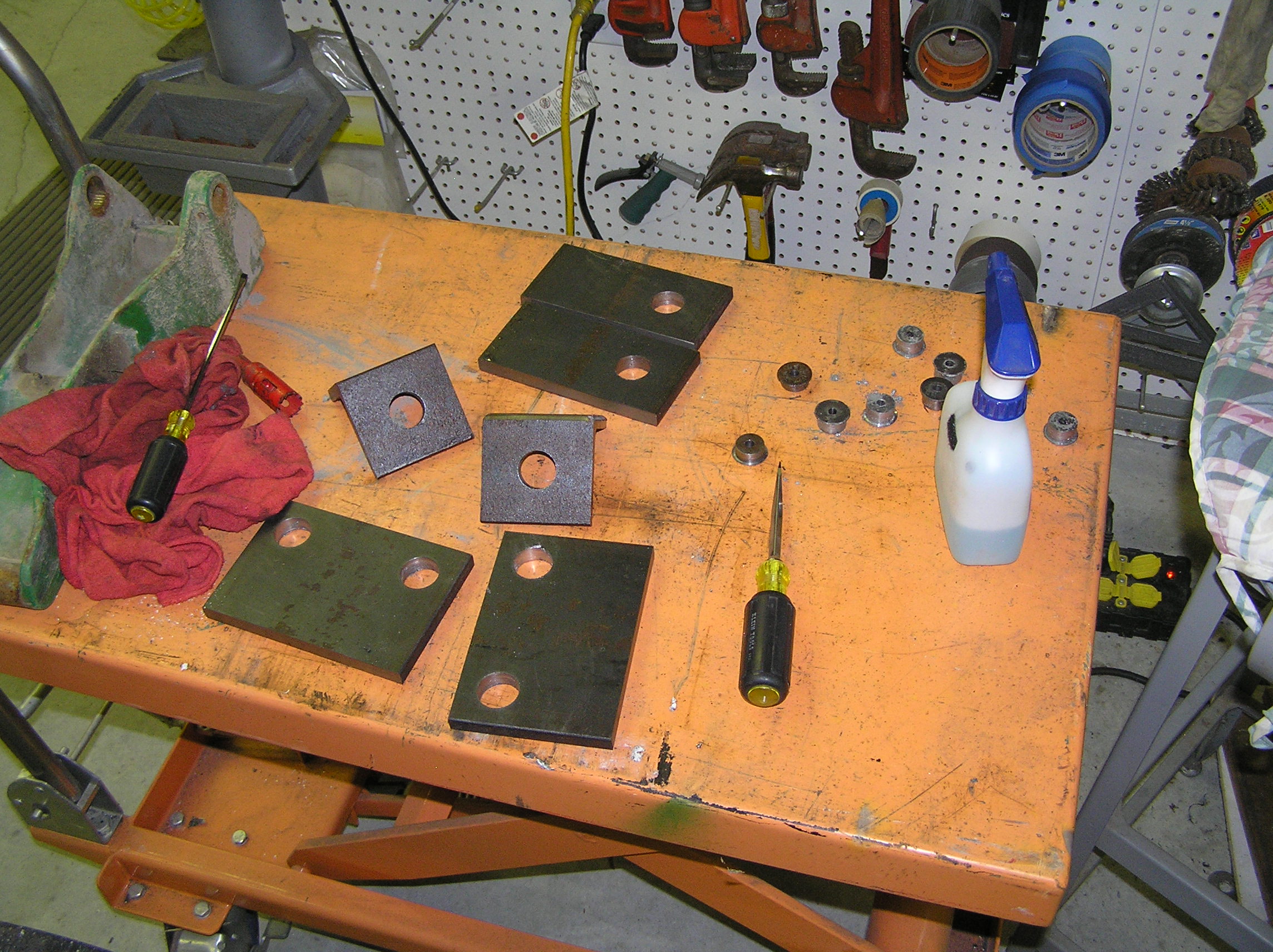

The next two pictures show cutting the 2" x 3" x 1/4" box tubing and the various pieces I have already cut out for brackets, to pin the boom to my fork frame, visible in one picture.
What do you think?

One question I have about the boom pole, is do I need to use some sort of stiffeners on the two sides of the pole? If you are lifting something and happen to be on an incline, the weight would tend to pull to that side. May be a moot point, since I don't think I could lift anything over 500 lbs out at the tip.

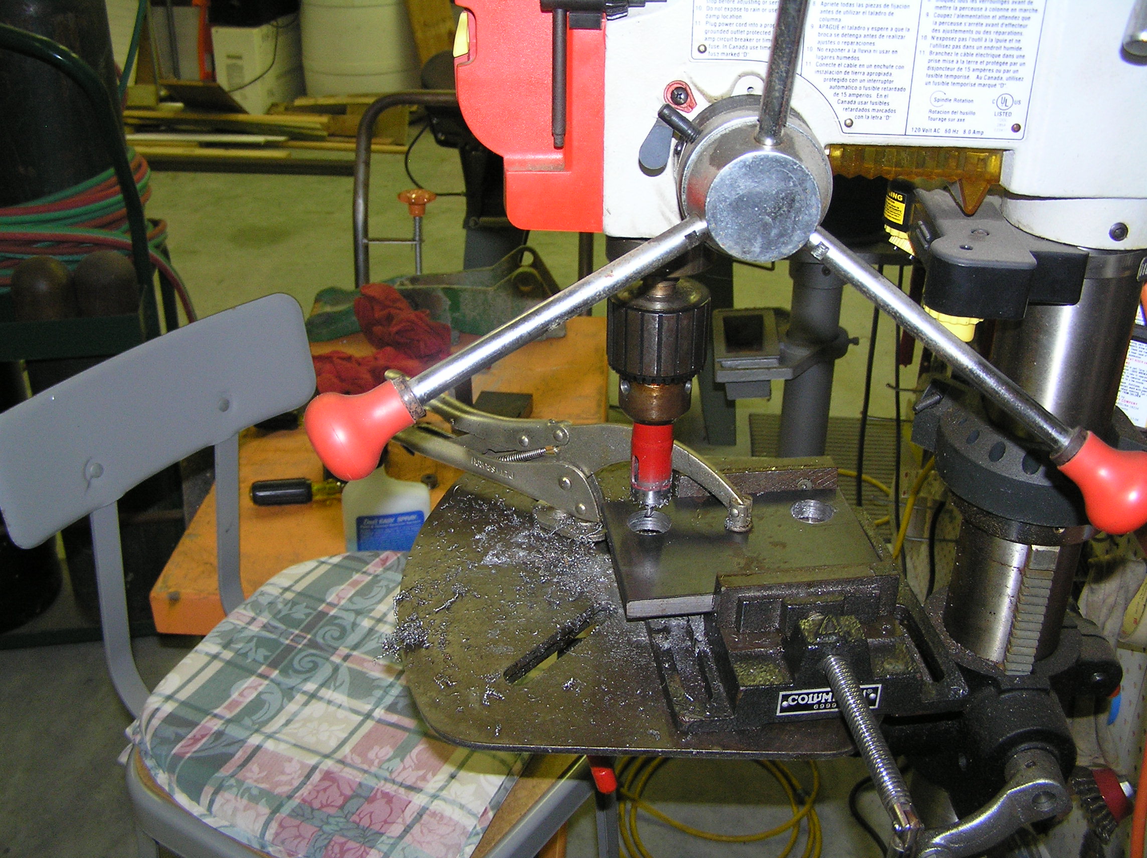

I will post additional pictures as I make progress. I did finish drilling 8 ea holes, 1" diameter, using a hole saw on my drill press. These were the pieces that will enable me to pin the end of the boom to my fork carriage and the two lift point tabs. I had read that on TBN and boy does it work well!

Nice design.
I doubt you'd be tempted to use it on more than a 10degree incline. Your 2x3x1/4 tubing should be plenty stout.

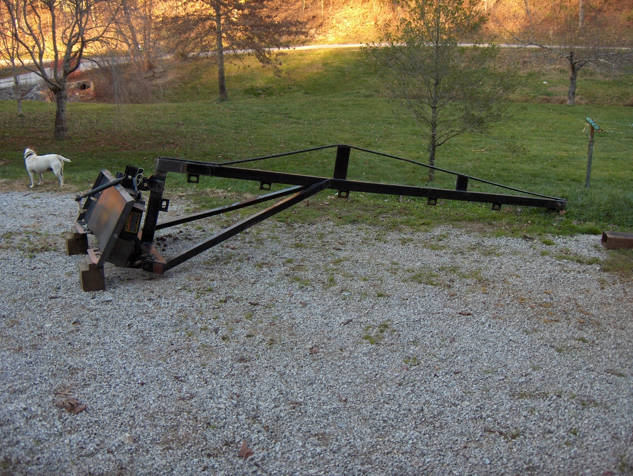

i made a SSQA by 3PH adapter so that I could use my boom pole on the front or back. I will differ from the other opinions here and say that you should put bracing on the pole. I will not pretend to be an expert on the subject
(though I have stayed at a Holiday Inn):D but most look similar for a reason and with a lifting device it pays to err on the side of caution. I am probably over thinking but I would put 2 forward angled pieces instead of 1 and tie them in to the base of the other angled braces. Here is a pic of the one I have cobbled together.

I don't understand the purpose of the two angled supports that come up from the where the lift arms attach. I think they are redundant. I also think you should consider having an angle on the pole so that when the boom support is verticle the pole is at an angle to the horizontal by about 30 degrees.

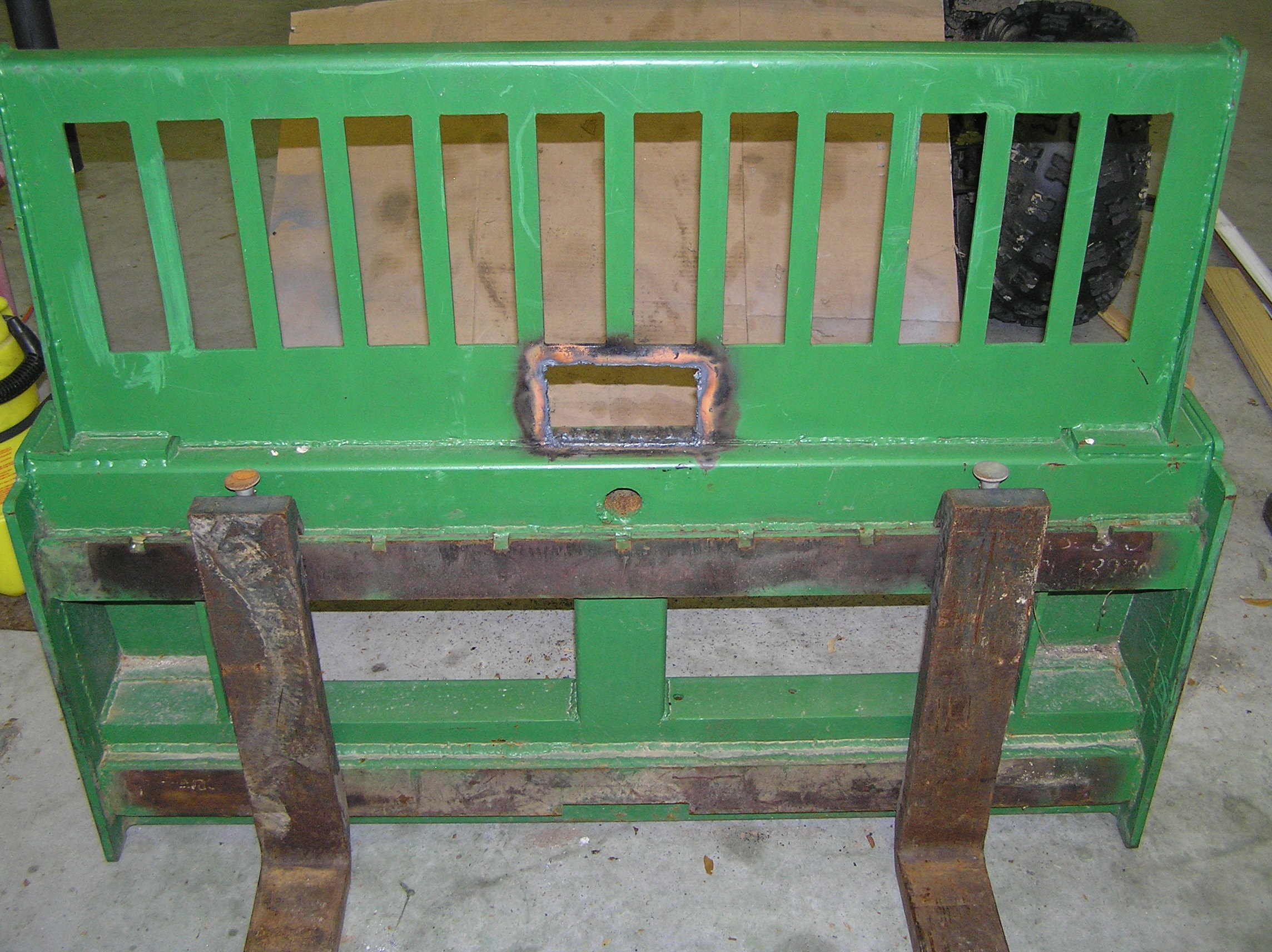

Didn't get to take pictures of the forks in the raised position and full curl. Ended up cutting out the slot, on the fork lift frame, to be able to pin the boom pole to the backrest, this evening.
Still have to weld the angle iron clips in place, just behind the backrest, to accept the boom pole. The other three pictures show the set-up I used to drill the 1" holes and the other two show the finished product.
