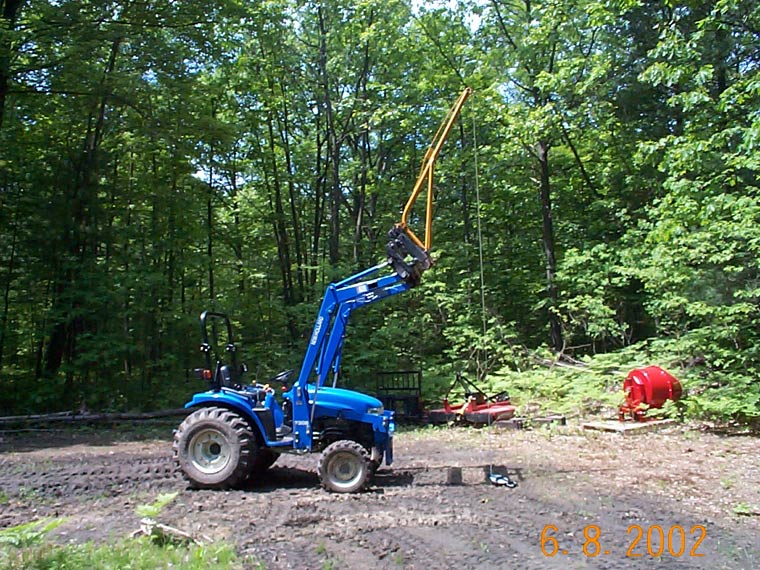

I finally bought a boom pole to hook up to my Kasco Switch-Hitch. I already talked about the Switch-Hitch previousely in two different threads.
<A target="_blank" HREF=http://www.tractorbynet.com/cgi-bin/compact/showflat.pl?Cat=&Board=implement&Number=145669&page=&view=&sb=&o=&vc=1>1st Thread</A>
<A target="_blank" HREF=http://www.tractorbynet.com/cgi-bin/compact/showflat.pl?Cat=&Board=projects&Number=153770&page=&view=&sb=&o=&vc=1>2nd Thread</A>
I hooked a tape up to the boom pole and raised it to a reasonalbe position and it measuered 16 feet to the ground. I plan on using this to set the poles and maybe even the trusses on my pole barn project.

Are you going to rig some kind of winch? It might be helpful up there in the stratosphere.
   / Boom Pole Lifts Up To 16 Feet
Yes Slamfire I am thinking of hooking up a winch to it. I was just telling Wroughtn_Harv in that I have been looking for a deal on one. Although I had already thought of a boom pole/winch setup, <A target="_blank" HREF=http://www.tractorbynet.com/cgi-bin/compact/showflat.pl?Cat=&Board=buildit&Number=148098&page=&view=&sb=&o=&vc=1>this post by Wroughtn_Harv convinced me that it was a worthwhile venture. Check out Harv's <A target="_blank" HREF=http://photos.yahoo.com/bc/wroughtnharv/lst?.dir=/Iris&.src=ph&.order=&.view=t&.done=http%3a//photos.yahoo.com/>website</A>, I found it very interesting.
   / Boom Pole Lifts Up To 16 Feet #4
Man, Spence, that Switch-Hitch sure opens up some possibilities, don't it? Talk about reach!
What're you gonna use for rear ballast when you're hoisting stuff out at the end of that huge lever? Looks like you could get tippy real fast if you're not careful, but then I'm guessing you already have that figured out, haven't you?
Betcha you could get quite a pendulum thing going out there, too.
Can't wait to see some "action" shots.
   / Boom Pole Lifts Up To 16 Feet #5
I have a gin pole that mounts in my truck bed for normal use. When I need it at home I mount it on my carry all. For use in setting poles when I build the barn, I have purchased a triangular tower that was originally designed to serve as a safety pole for a truck lift. I put a 2000 lb winch on the end of the boom and it is really handy.

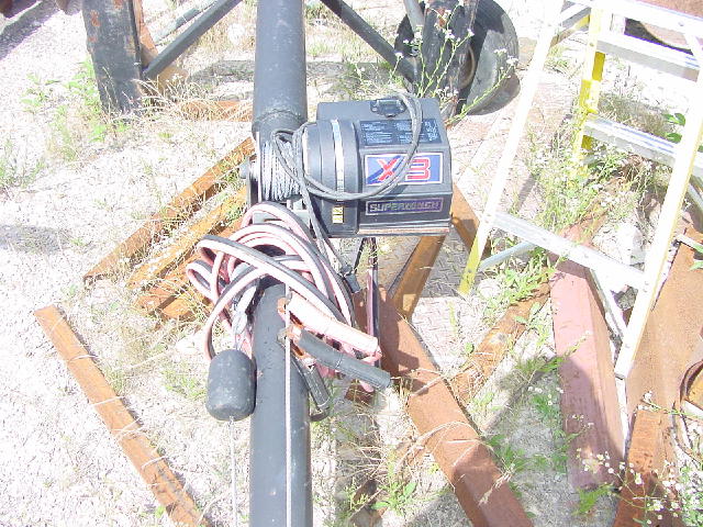

Evening spence, we had a long hard one, lot of those lately. I haven't had a day off in about three weeks.
This morning down at the shop I took these close ups of my boom rig. It's of the winch and mount.
The way mine works is I slide it onto the forks for my JCB165HF. Then I use a short piece of chain as a safety device to hold the boom rig to the forks. My innner sleave slides out six feet and the main tube is ten feet. So dead on the ground I have the potential for sixteen feet and with the forks all the way up I have twenty six feet off the ground for the pulley.
Something to keep in mind is to be sure and have a weight to bring the the hook down. Mine is lead. But heck a piece of bar stock after some quality time in the drill press would do just as good if not better.
I've thought about mounting my boom to a quick attach instead of using the forks. But for me the forks offer a real viable option for my purposes. They allow me to have the best of both worlds, forklift and crane with sandline.
One thing I don't do with the boom fully extended with a load is move the tractor. The weight and footprint is awful small with a twenty six foot lever up and out there.
