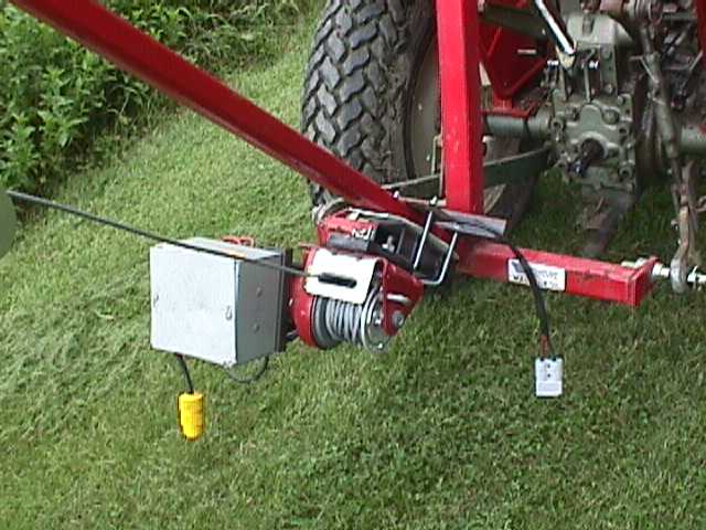

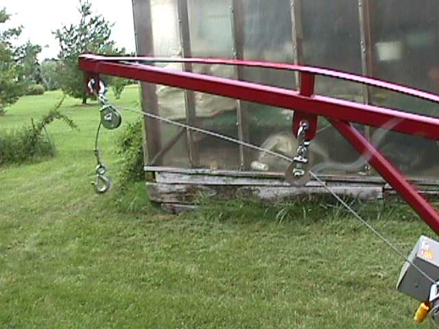

Finally got around to being on the tractor and having a camera available at the same time.
Here's the boom pole that I rigged a winch on. I'll try to explain whats in the picture.
The pole seems to be very well constructed with 2 places to hook chains or in my case pulleys. I mounted the winch on the angled support. The cable runs up and through the 2 pulleys. You'll notice 2 cords coming out of the gray box. The Gray connector is for battery power. I have a #6awg cable with the matching connector on one end and jumper cable clamps on the other end. The Yello connector is a twist-lock connector that I plug the switch into for forward and reverse. Now the gray box.........well this particular winch had no reverse option(except for a $120 solenoid kit) and when I used to load my rider into the truck I felt I wanted to do it by way of winch in and out. So I got 6x6x4 SC electrical junction box and mounted 4 Ford starter solenoids in it. 2 work for in and 2 work for out along with the low amperage control switch with 25' cable to make it work. If you don't count the pieces and parts I already had laying around for the switch/solenoid combo the solenoids and box cost me about $40.

Solenoid box

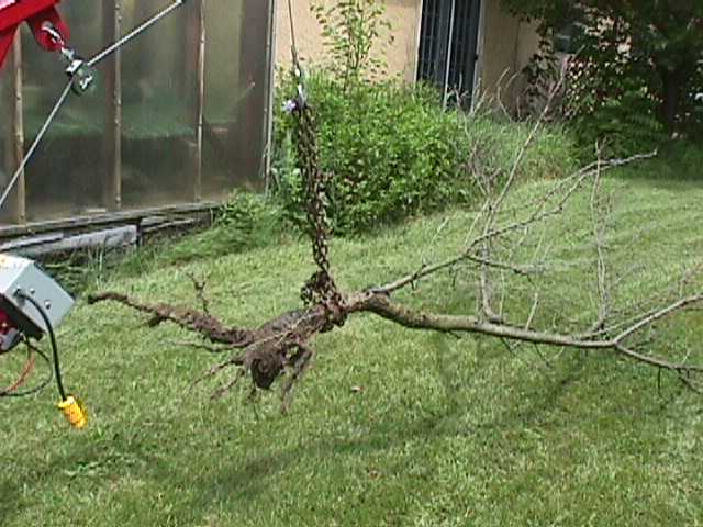

Darn you PJ,
Since I had the pole all hooked up, there was a dead fruit tree that either needed knocked over or......hey maybe it needs uprooted by a winch/boom pole.
