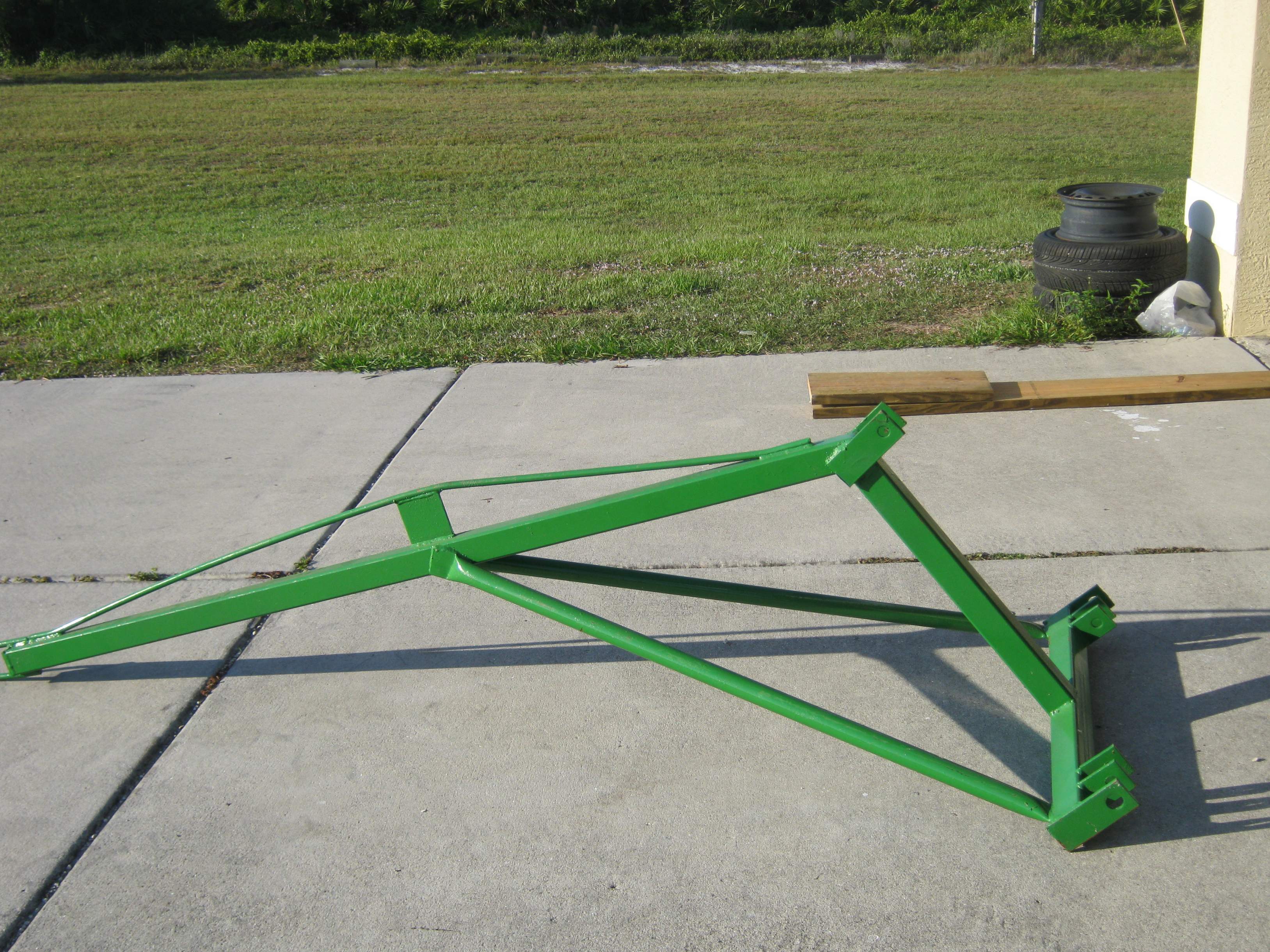

   / BOOM POLE PICS #14

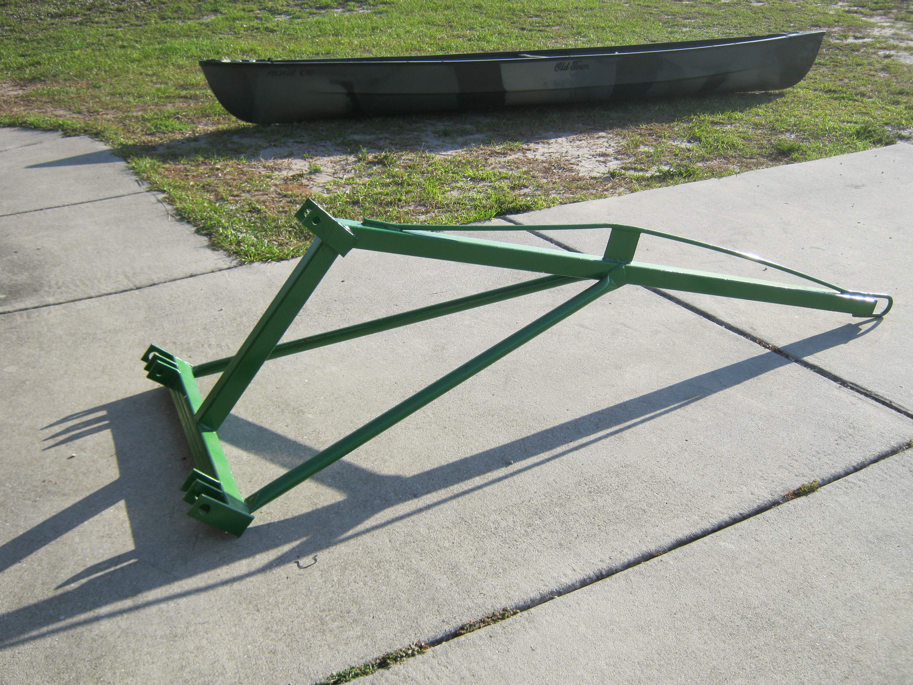

before paint
We'll be using this 8' boom pole to set some 500 gallon diesel and kerosene tanks on an 11' tall stand.

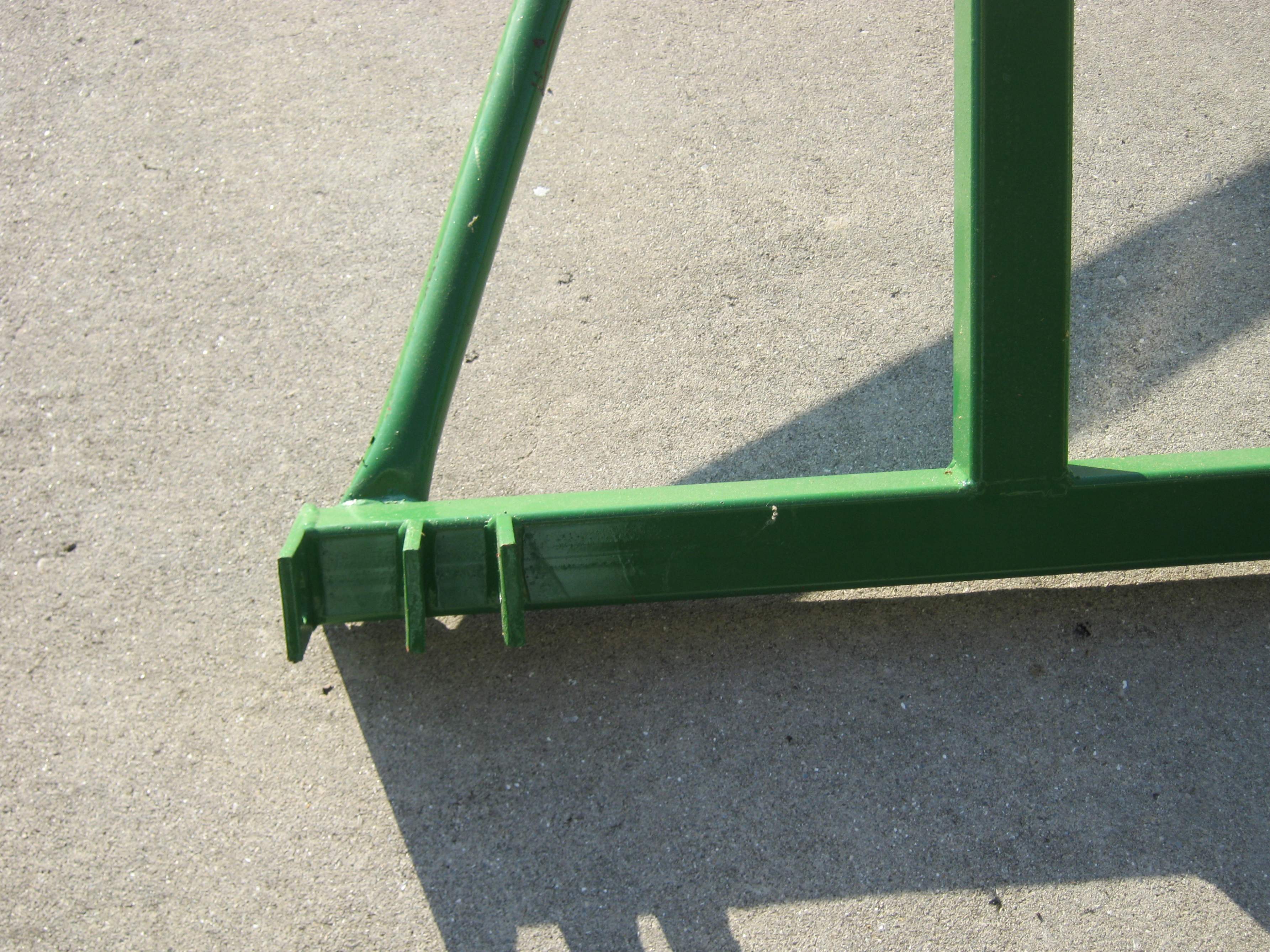

   / BOOM POLE PICS #15
before paint
That looks nice, but I would be concerned about using the flat stock for bracing instead of something more ridged, like tubing, barstock, etc. If the boom pole starts to bend, the flat stock has a lot of movement to take up before it comes in to play. Just my opinion, but I'd change it. Nice job otherwise!
X2

The flat bar will be under tension, so it doesn't need to be rigid. A cable or chain could be used. The problem is that it is curved, and those curves will have to straighten before the flat bar will add much strength.

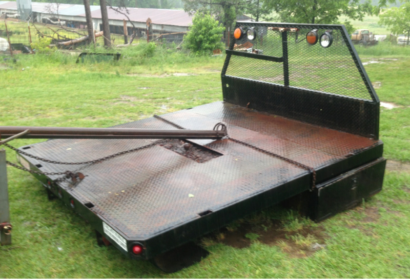

Here's my 3 point one . On my 135 best pics I have right now . Part of a old auger cut off a piece of drill stem and some angle iron 2 horse shoes a chain hook . . Has been working for years my dad build it in the early '80's .
Guess now I will have to build one for the front of the Kubota.
Sent from my iPhone 5 using TractorByNet

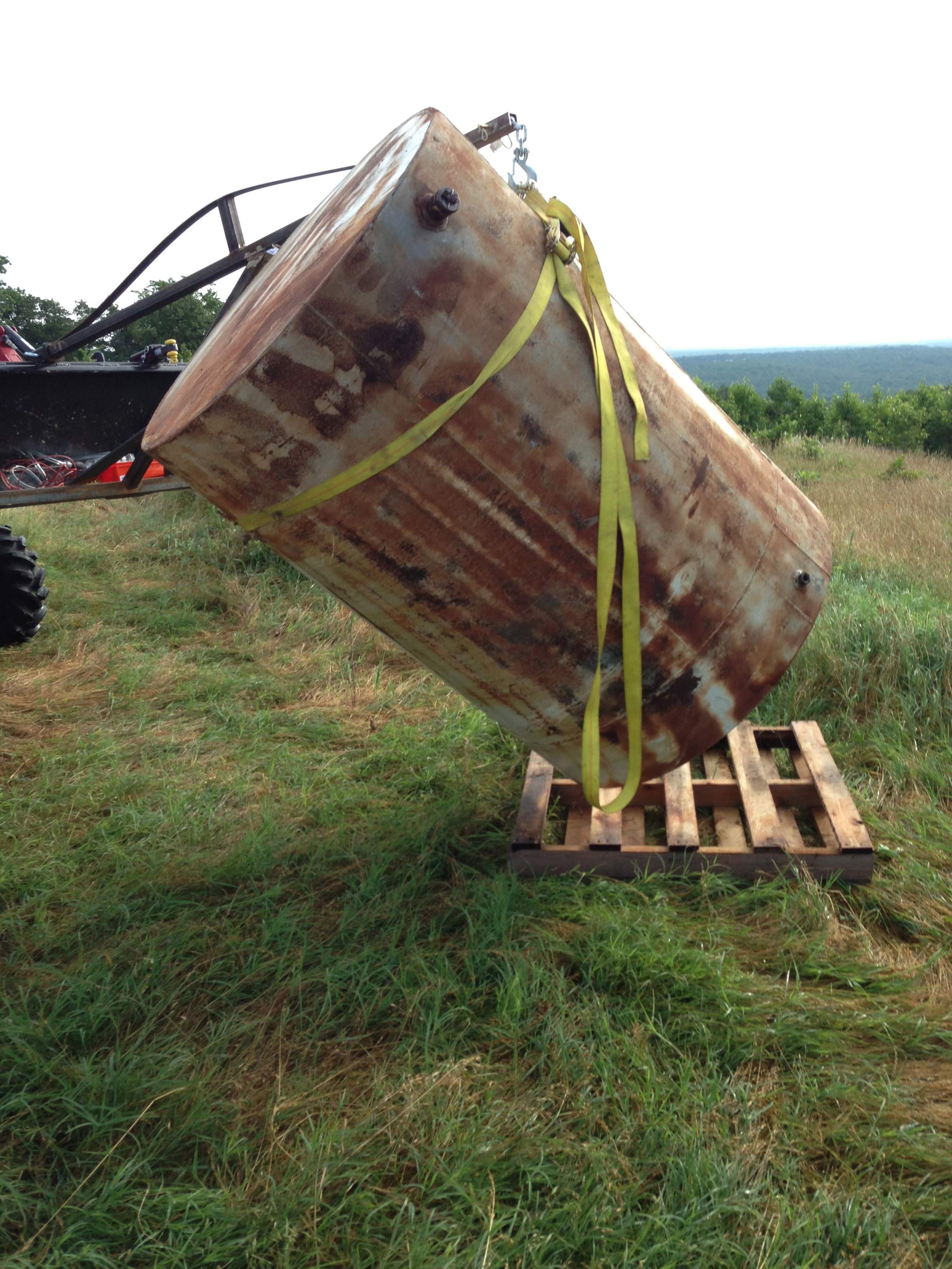

We set one of the 500-gallon tanks on a pallet yesterday with the new boom pole so we can prep and paint it. Worked like a charm and the extra 8' of reach will enable us to set the tanks in their 11' tall stands.
