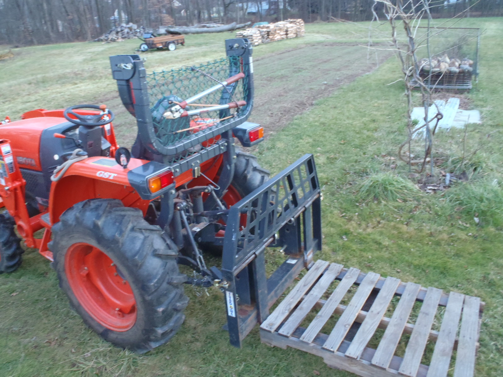

Baby Grand......That Boom Pole made your day. Sometimes I forget that I have one. You told us in another tread as to why you have the chain link attached to the ROPS, but I forgot. So, what was it?
   / Boom Pole used for Vehicle Recovery
#15
When pulling ropes and chains I get a deep, uneasy feeling - something along the lines of "what if that rope snaps and it comes at my head like a freight train?". I noticed that many of the logging winches now come with a screen up top to protect the operator and decided that even if I couldn't afford a new logging winch, I could knock together a serviceable screen. I also use it to carry my loppers and spare bungie cords:
   / Boom Pole used for Vehicle Recovery #16
That chain gives you alot of range and is quick to adjust too. I like it. :thumbsup:
#17
Thanks, Gordon. That was a bonus that I hadn't anticipated - large adjustments can be made much more quickly than with a turnbuckle type of toplink.
Willl brought up a good point about safety. In using this arrangement I took into account that there is some risk to using it, in that the boom can swing back at the operator unchecked. Something to keep in mind.
