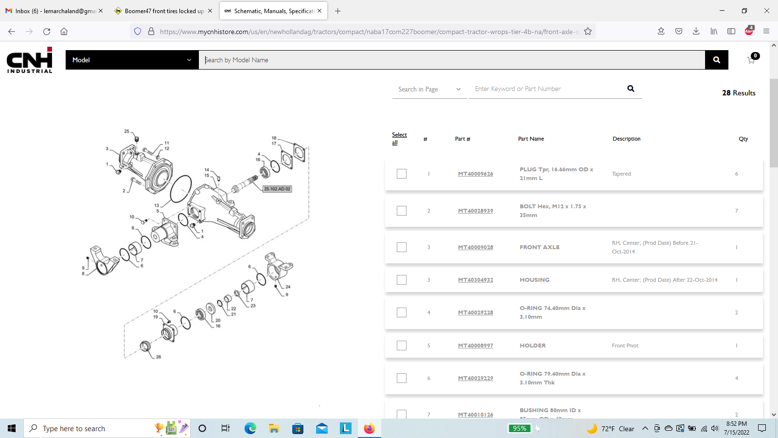

I'm afraid that you will not find it as easy as pulling a pan to check it out,
You will need to remove the entire axle from the tractor to split it and separate the halves.
I'm not sure if this will link to it for you, if it doesn't look you can find New Holland parts breakdowns and search for your Boomer.
Schematic, Manuals, Specifications and Diagrams for Front axle housing, center, boomer 41, 47 | New Holland AG | MyCNHi US Store
   / Boomer47 front tires locked up #26
Ouch! That's not what I was thinking it looked like. :cautious:
