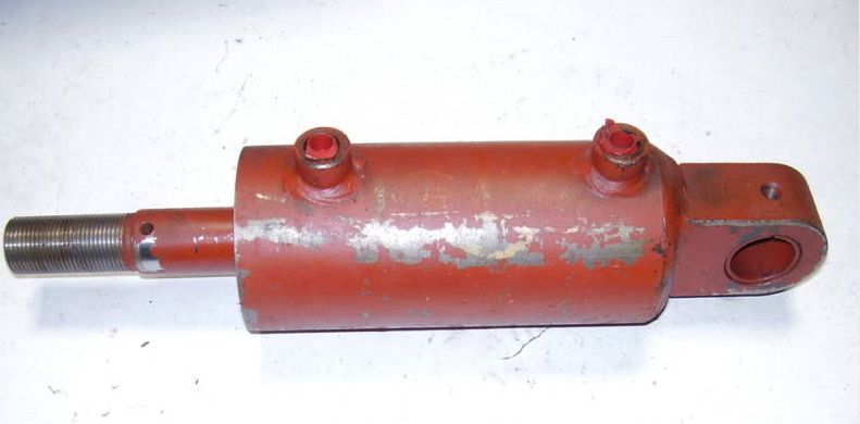

sort of an update...
Wondering what you guys think about these cylinders...
They were originally intended as "tilt cylinders" for a fork lift...(they are new regardless of the scratched up paint)...I bought 2 of them $20 each...for that much money I couldn't pass them up...
My (manual) sidelink adjusts from about 14" to 19" which is 5" and these cylinders only have a 3.375" stroke...but for what I will be using it for I think this will work out for me...I bought the second one just as an option of having HSLs on both sides...I've read all the pros-cons...it's just an option..
I think I can modify one of these cylinders so the retracted (or mostly retracted) length will be the same length as the (current left side) solid sidelink...
3.00 inch bore
3.375 inch stroke
1.25 inch diadeter rod
Rod extends 4.75 inches from the case when retracted
3.5 inch outside diameter
Mounting lug on case end has 1.25 inch diameter hole. Lug is 1.5 inches wide
15 inches from the end of the rod to the center of the hole in the mounting lug with the rod retracted

First, got any more??? or a place I can order a couple?
Second, I don't think you need that much tilt... and if you move your adjustable link to the other side, it will still give you 5" when you have to have it....
Third, Nice buy!!!

...I don't think you need that much tilt...
I don't either...seems like 3" is more than enough for what I do...

I'm not as concerned about the lifting power of the cylinder as I am about the (possible) abuse the rod may take...especially when one of the heavier attachments is connected...
Richard,
As you may already know, Hydraulic cylinders are at their most vulnerable to side loads when fully extended. As long as you're operating somewhere in the middle of the stroke, a 2 inch cylinder would have, likely, been fine. Those cylinders are awesome.:thumbsup:
