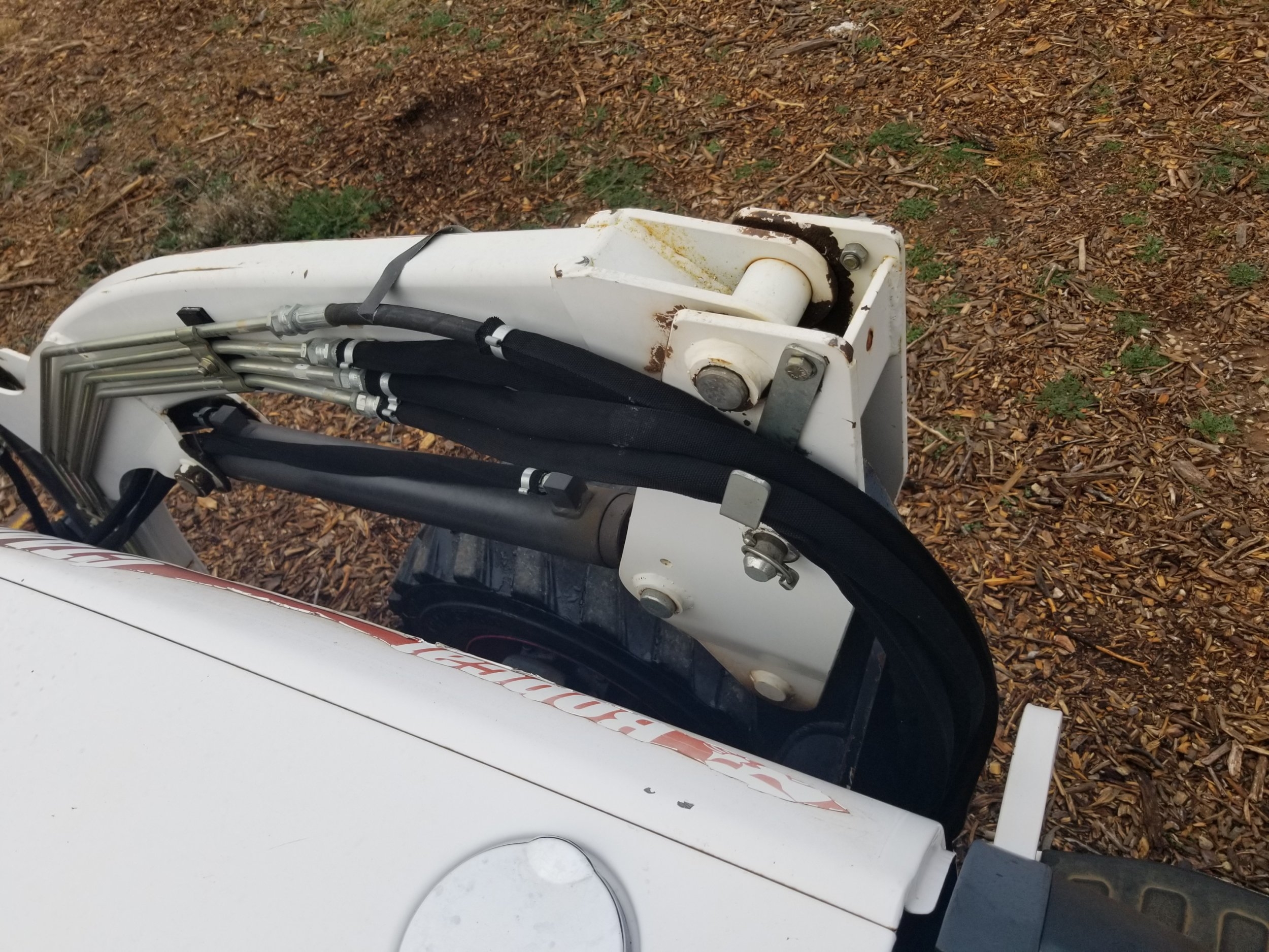

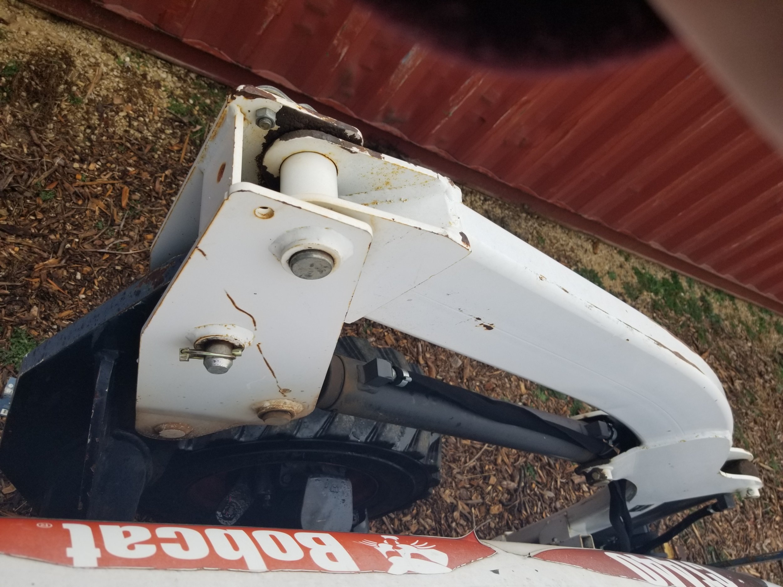

My guess is that you've had a slow leak for quite some time.
Your hydraulic cylinder rods look mighty dirty. Of course we're only seeing an inch or so of the rods.
But the first thing I might do is clean the visible part of the rods (up to that rib of grease). Use a good degreaser?? If you can extend them a bit, all the better.
The rods should have a mirror chrome finish.
If they don't clean up, then you have bigger problems.

Unfortunately, I don't know if they were leaking while lifting, because my dad is not good at paying attention to those things. I do know it was spraying in a stream while holding steady and after I dropped it down and shut it off.

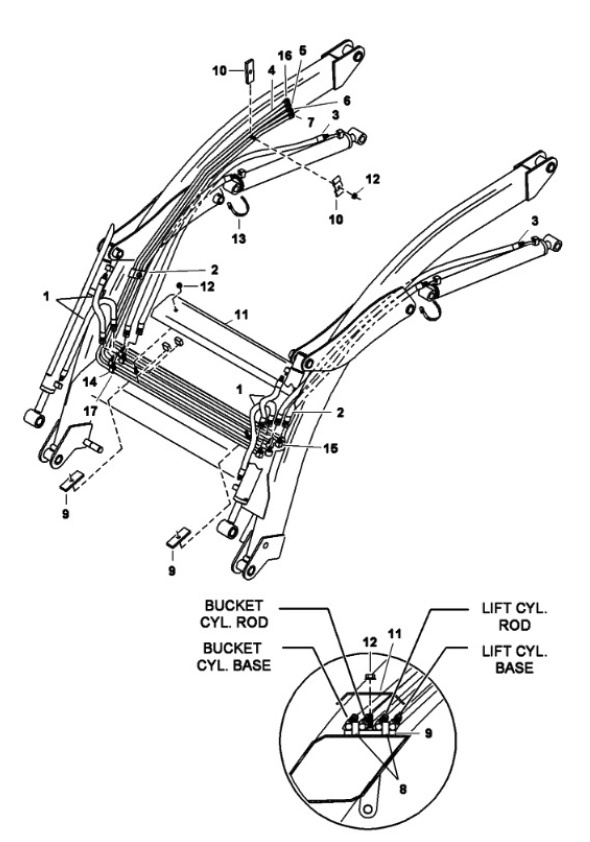

Sorry, it's too dark and cold to go outside, there's a junction unit thing under the floor where all of the hoses, um, "initiate" from, I think it has quick connects on the back but I can't remember the front. It's either near to that main valve or on the opposite side I think. That's the thing you're talking about, right? (Am I asking a stupid question, are quick connects standard and that's exactly what you're talking about?)
You are not asking stupid questions. Yes typically the quick disconnects are close to the main directional control valve on the tractor. They allow removing the loader with minimal oil loss and no tools.
You can see from the pictures that there's not a quick connect at the actual rod ends, I remember looking for their ends and thinking they'd be hard to disconnect from wherever they go to, but unscrewing them from the cylinders didn't look too fun either. Thank you for the "why", I really appreciate that.

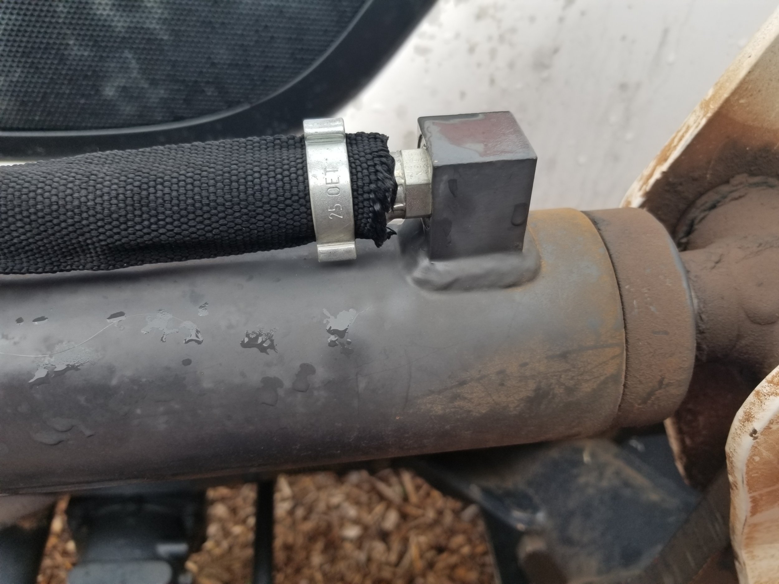

  • So, should I remove the hose at the quick connect (long and secured in multiple places) or at the cylinder (fittings look hard to put a wrench on and don't look like they swivel). Those front ones look like I can't get them off until I release the cylinder from the frame. And I don't think they terminate in quick connects after looking at the diagram.
  • Is covering the loose hose connections with a baggie wrapped with electrical tape good enough to protect them from dirt?
  • When things get reinstalled: Loctite, anti-seize, plumber's tape, or just clean?

The quick connects have a valve to stop the flow of oil. That will make working with them easier.
However, eventually a shop will want to strip down the cylinder. I probably wouldn't leave my hoses with a hydraulic shop.

It would be good if you could extend the cylinders for a better view of the chrome rods. The pictures you have look fairly dry , where did the fluid appear to be from when you checked? Did you dry it any before taking the pictures, the cylinder ends look dry in the picture. ?. The dirt behind the pin boss could have worked its' way into the gland packing creating a leak. Both cylinders do not normally begin to leak suddenly and at the same time. That is the reason I mentioned the dirt and gland packing. If the bucket drifts down slowly as it sets it could be an indication of wear to the piston packing . the reason I asked for pictures for the cylinders to to see if there is any rust or "dings" on the rod which would also allow oil to escape past the gland packing. I have rebuilt many cylinders in the past and always check these things before beginning to dismantle the cylinder.
