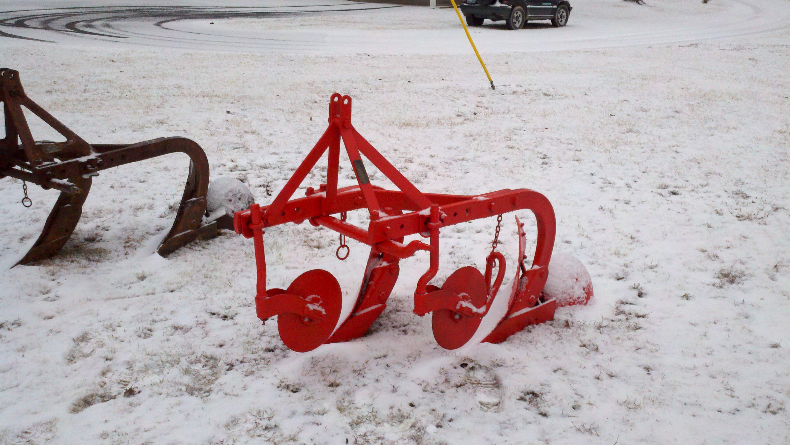

I just last weekend broke what was essentially virgin ground (hadn't been broken in decades at least) which was covered in rough grass. I used an old two bottom Ferguson plow (14 AO 28) I picked up a few weeks ago. It did great, but there were a few times I ran out of traction with my MF 1742 (42 engine horsepower and approximately 3700 pounds in weight w/o FEL). Although I removed two small walnut trees before starting , there were no roots to speak of-the land was just grass. It helped when I put a load of dirt in the FEL and raised it up so it was centered over the front tires. The point for the OP is that you'll likely not move a two or three bottom plow in the soil conditions your describing. I think you'll have at least occasional traction problems with even a one bottom-especially if it's a 14 or 16. Attached is a photograph of the Ferguson plow sitting at the place where I bought it.
