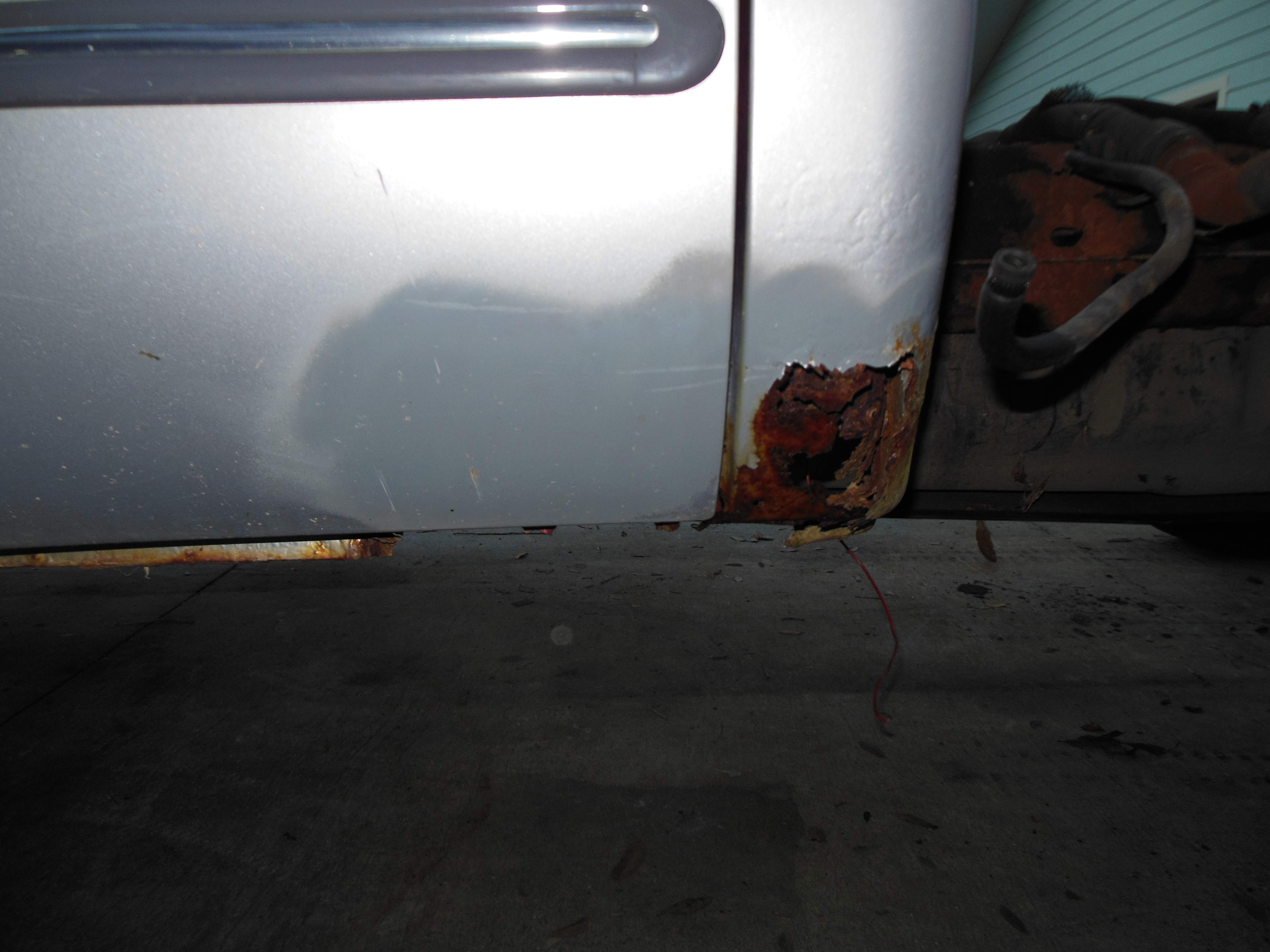

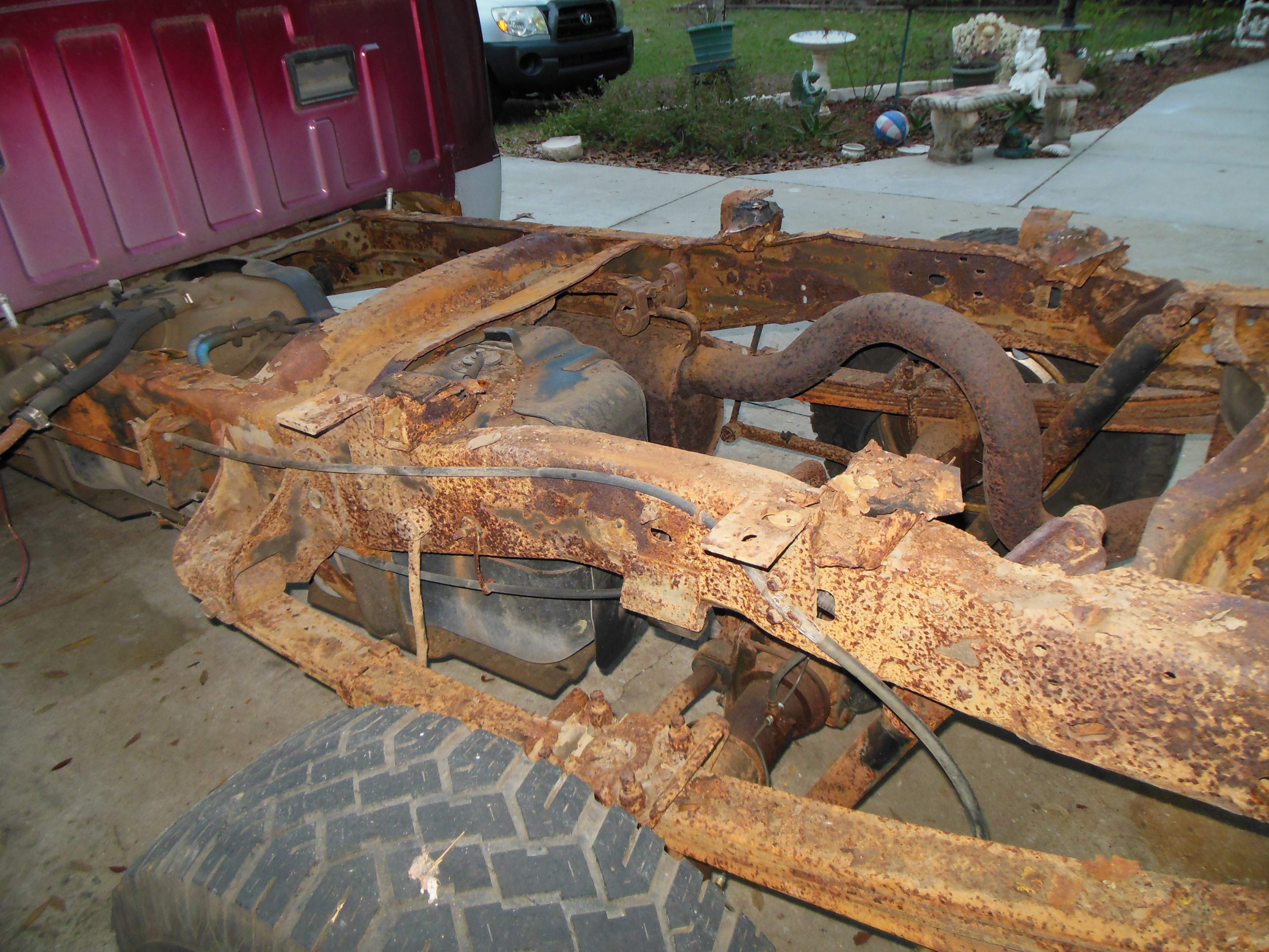

DSCN0008.jpgMy son and I took the bed off last night. We cut the heads off of the bolts that hold it on, took out the tail lights, filler neck, and aux fuel tank.
After we had everything disconnected my other two sons helped us roll it off the frame onto the ground. It was easier than I thought.
The good news is that the rust damage was about what I suspected. It is mostly scale that comes off of the frame easily. The spare tire lifting mechanism is shot but that is no big deal. It also has new brake lines on the rear end. He told me that he had all new brakes put on it before he put it up for sale.
Looking under the truck the rust from the front to the rear is much different. At about the rear of the cab you can still see the color of the frame and the farther forward you go, the less rust there is.
Both rear bottom corners of the bed have rust damage that I will get fixed before I put a new bed on it.
Mechanically I think he took pretty good care of the truck. He told me he changed the oil every 5k. He gave me part of a galln of of shell oil and said that was all that had ever been in it. He also gave me two bottle of diesel additive and told me he always put it in when he filled it up.
He also told me when he had the transmission fluid changed but I don't remember what he said. I think I will go back and ask him about the transmission and when, if ever he had the radiator flushed. If he hasn't I will flush it and follow the above recommendations.
My son says I should have the muffler taken out and just run straight exhaust like he has on his truck. Would I gain anything if I do that? Thanks again for all of the help

Now that the bed's off it's a good time to check the gas tank straps (prone to rot and break), change the rear diff fluid (easy access), the rear shocks and mounts (might as well replace the shocks), the leaf spring shackles (prone to rot and cracking), and exhaust. A straight pipe vs the muffler won't add a ton of power or even be very noticeable unless you replace the entire turbo back exhaust with a larger 3". Here in NH the turbo counts as a muffler so you don't need a muffler for state inspection. Your state may allow that as well.

Thanks Dmace. I don't think I am worried about adding power, although I would take it. I would be more interested in adding fuel economy. I don't think I will be driving this enough to justify spending a lot on the exhaust. There is a good muffler shop near me. I will stop by one day and get some prices.
Like you said about the other items now is a good time to look at the exhaust while the bed is off. I am going to meet my wife at the tag agency tomorrow and put plates on it so I can start driving it around as I work on it.
