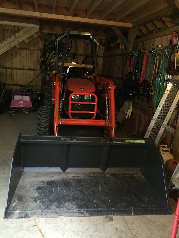

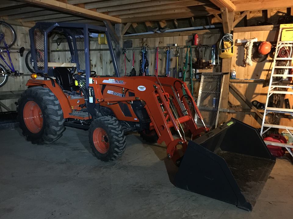

I just want to comment that "light" construction vs "standard" or "heavy" construction is all relative. I don't know about your snow bucket. My snow bucket weighs ~500 which is roughly twice what my "standard" OEM bucket weighs. The snow bucket has a much thicker cutting edge (3/4" x 6") than the standard bucket (1/2" x 4"). It has more reinforcement. There is really no comparison in the construction. The snow bucket is built much stronger yet the manufacturer calls it "light" construction. This is because these are made to withstand 70hp skid steers and they are comparing them to the heavy duty digging buckets that type of equipment requires. My point is that nobody buying one of these for a CUT should consider them "light" in construction or in terms of how the bucket weight affects your lift capacity.
I'm really anxious to try mine in snow. I think it is going to work great and save met a lot of time but I won't know for sure until it snows - of course it is also great for moving all those things that wont fit in a standard bucket (gas grill, large trash cans, lots of firewood and anything else that is "light")

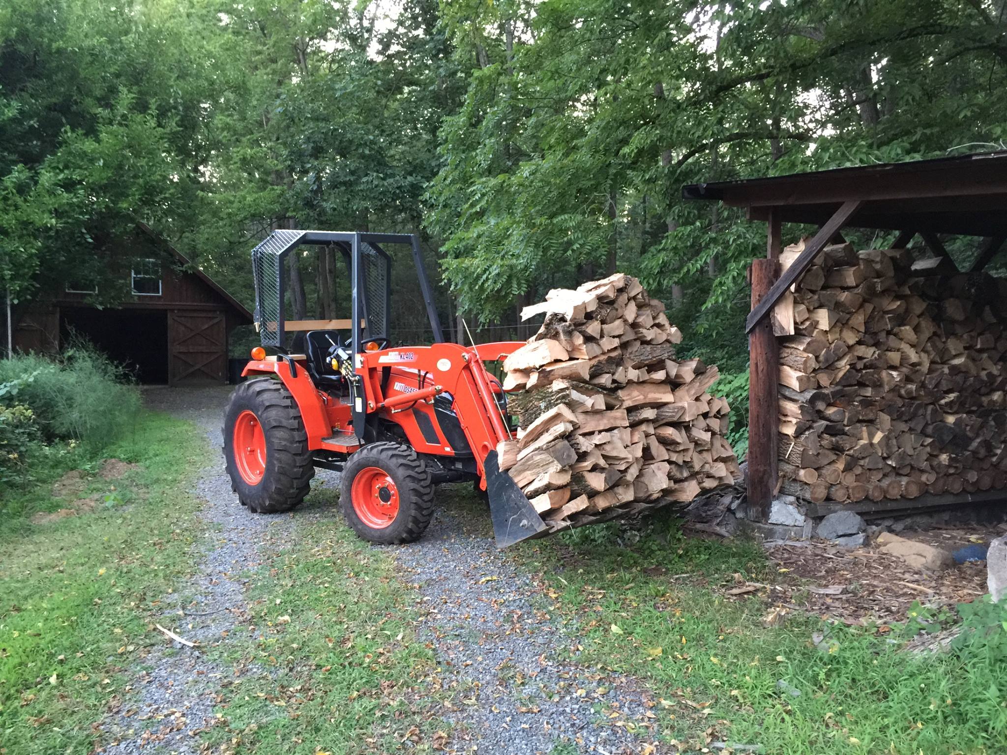

I will definitely be using mine for firewood. I try to fit as much firewood as possible in my stock bucket but it is a balancing act as you can see from the picture below.
For those considering one of these, just be aware of the extra bucket weight, the impact of the extra bucket length on your loader (especially the curl function), and that with a high volume bucket you can get a lot of weight in there fast.

Interesting thread... but Gladehound, surely you don't really move a stack of firewood like that in the photo... I don't think I could get 20' before it was falling all over the place- even in L speed.
   / Bought a new snow bucket... #20
I did drive with it. Only ~150 feet from my splitting area to the wood shed. Did not drop a single piece. I was going about 1.1 - 1.5 mph but it never felt like the pile would spill. I did this because my log splitter doesn't have an off switch so I keep stacking (if I can) until it runs out of gas. I rarely can get it all stacked in one bucket trip. The stack usually starts to get unstable and I then throwing the splits on the ground and make 2 trips. But a few times I've been able to just keep stacking it and it felt real solid so I just went with it. With the new bucket, I'll never have to throw split wood on the ground so I can eliminate all the bending over to pick it up again! :thumbsup:
