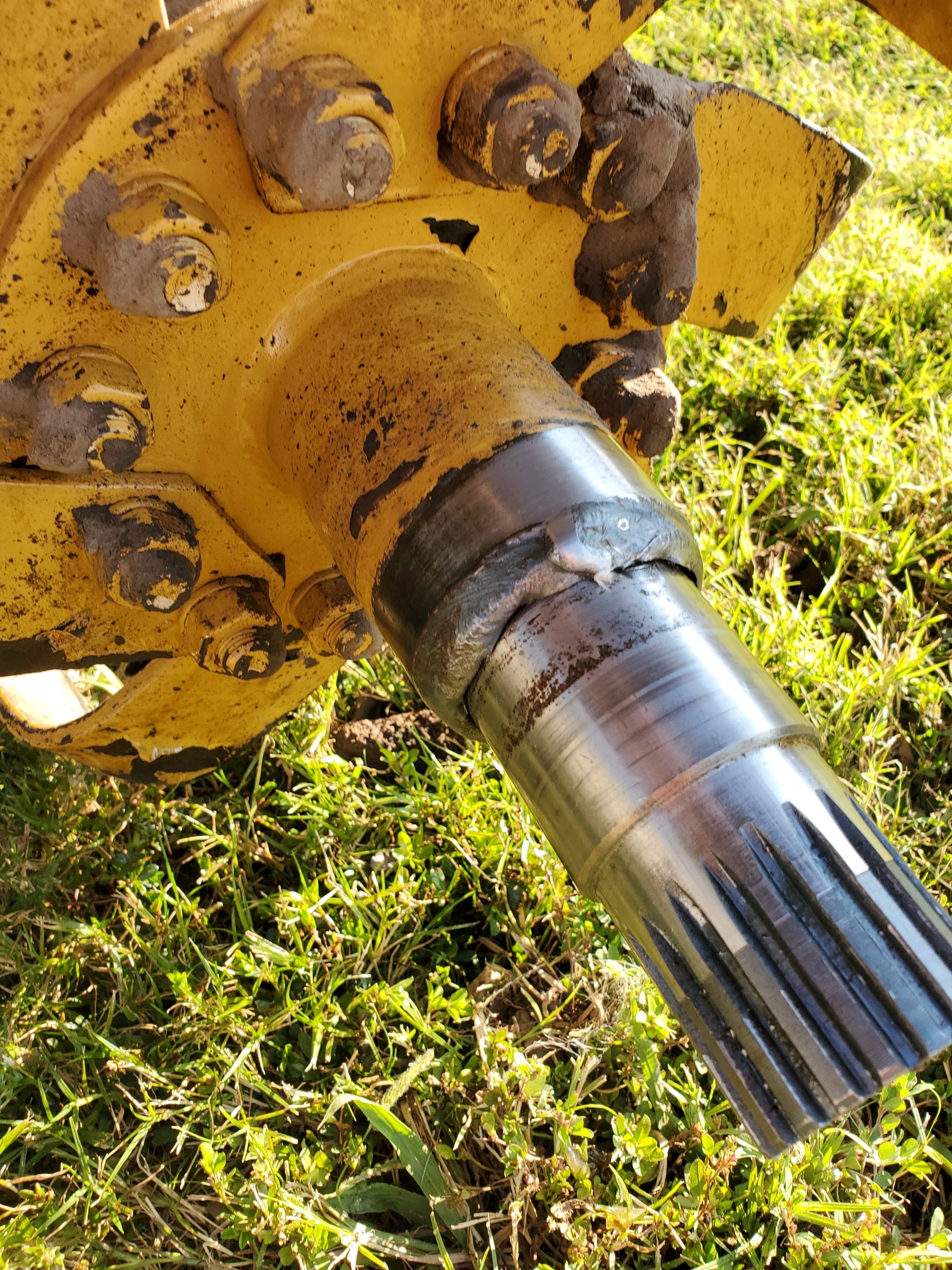

If it didn’t come out if a tube, then maybe it was some kind of thick flexible rod that was bent around the shaft and then heated with a torch. I just don’t see any sign of the puddling and flow that a welder would produce.
Very strange.

I can get a better picture. It is likely a machine weld or not welded by a human!
Saw a couple videos also about changing the grease seal there and those tillers were welded also so seems to be how KK does it.

Can you pull the stub shaft out of the tiller tube? Grinding down much of the old weld before welding would allow a nice small and strong bead. I'm thinking that the stub shaft may be a dissimilar metal which may have been some of the issue. Or, maybe the stub was ice cold and that could also be part of it. I would use a rod that is for dissimilar metals.
   / Bought A Used King Kutter 60" Tiller And It Broke. #14
That's not a weld - it's a Decorative Edge Bead!
I'm with others - No sign of any heat in the shaft. Something ain't right. Unless the place it was welded on is now hidden inside the yellow part so we can't see it??

Yea, KK got back to me and said they see this and it is usually related to an improperly adjusted slip clutch.
Can't deny that logic but I think this would have broke over time anyway.

Looks more like a bead of something squeezed out of a tube. JB Weld maybe? I don't really see how a welder could produce that.
A friend had a little 110 volt flux-core mig machine that would produce nice looking welds, but had virutally no penetration. That would be my guess on that weld.
   / Bought A Used King Kutter 60" Tiller And It Broke. #19
OK. But that's not a "nice looking weld." Doesn't even show signs of the material being melted.

Year ago we would say that came out of a can labeled CS or Chicken Sh--.
