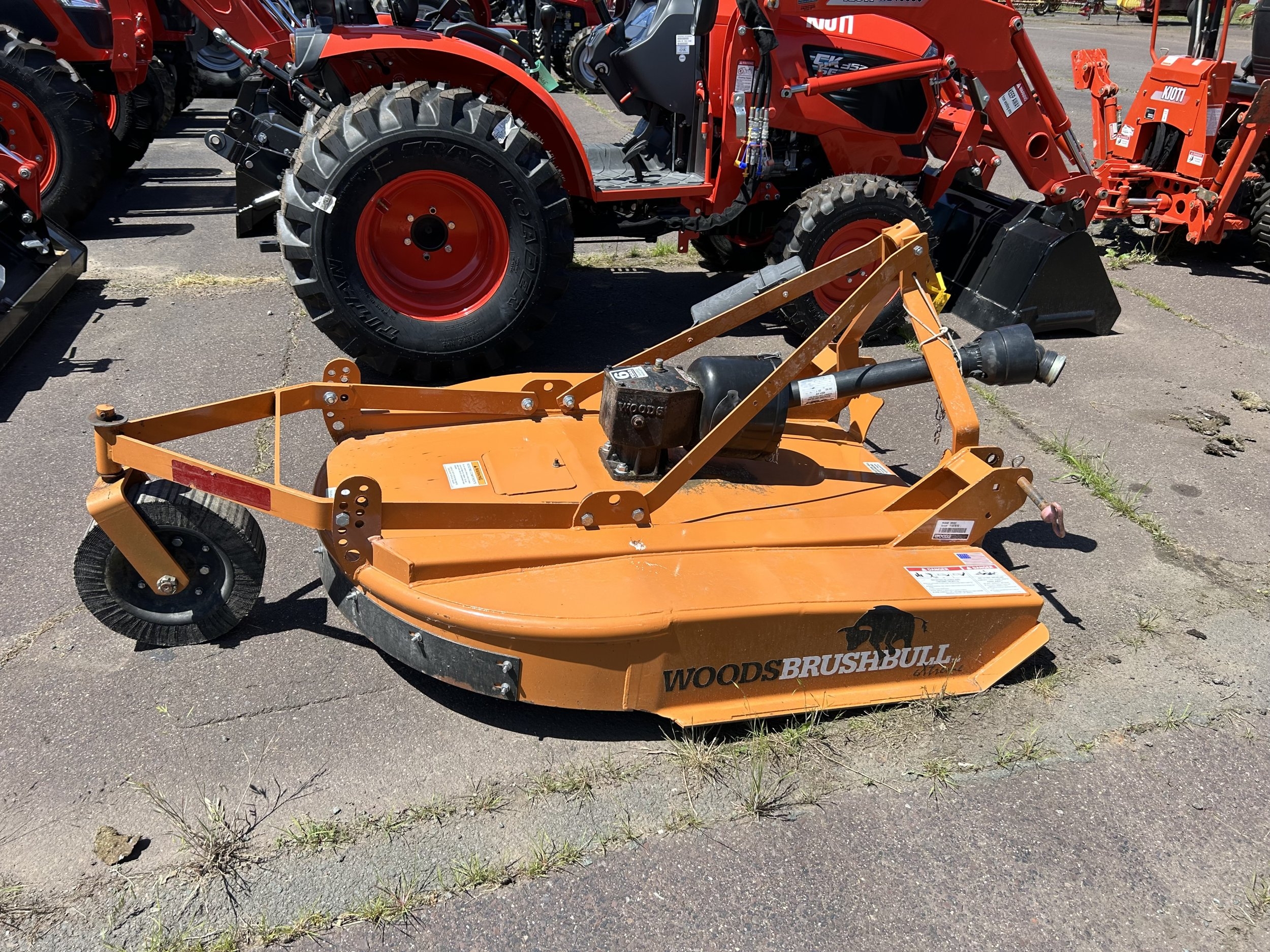

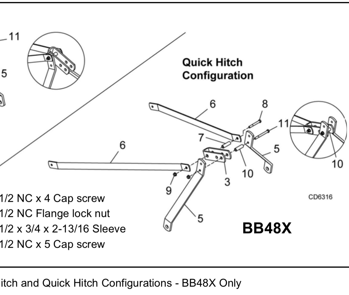

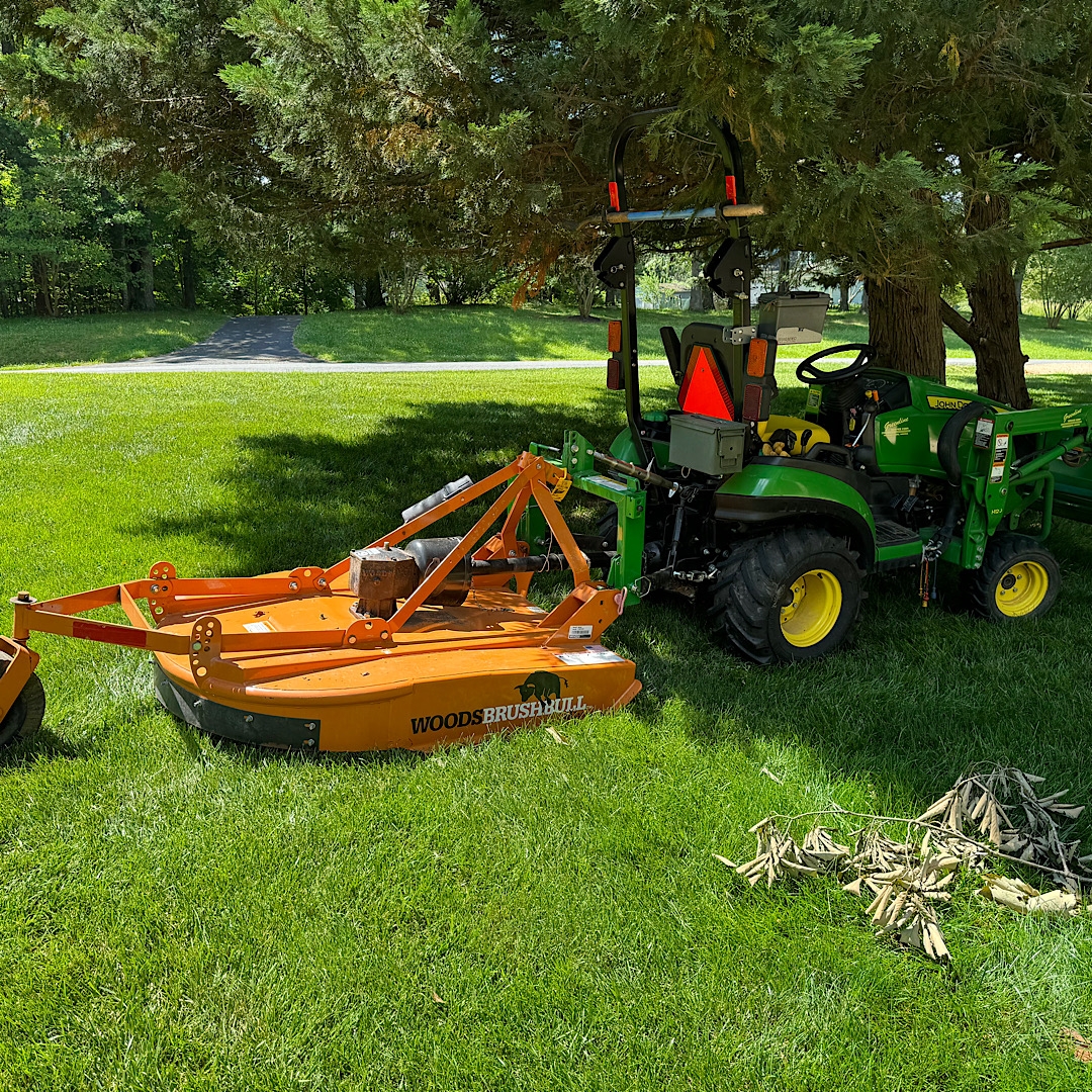

Been looking for months; lots of expensive scrap, lots of expensive new ones. Five foot models are plentiful! Happened to call the local New Holland shop and they had just gotten in a BB48X on consignment @ $1200. Woods and Bush Hog were my picks - so I bought it. One owner, light use, great shape!
The top link does not engage when I set up the cutter per the manual for my iMatch quick hitch. It seems I might need a longer hook such as the one from Bolt On Hooks?

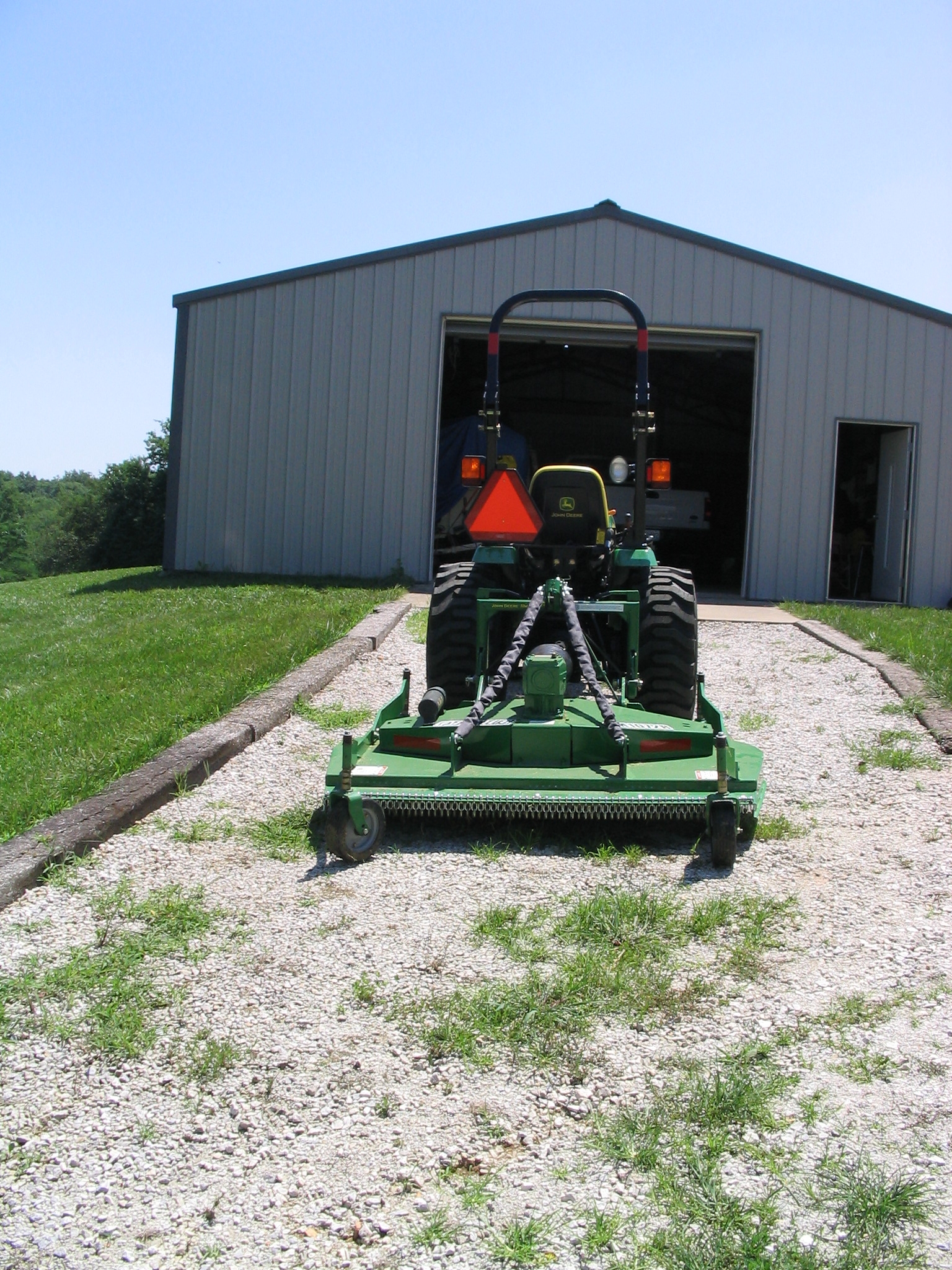

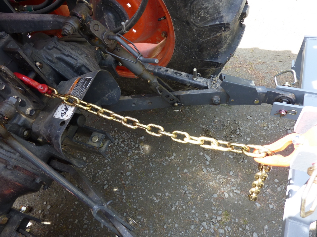

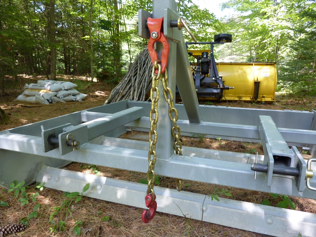

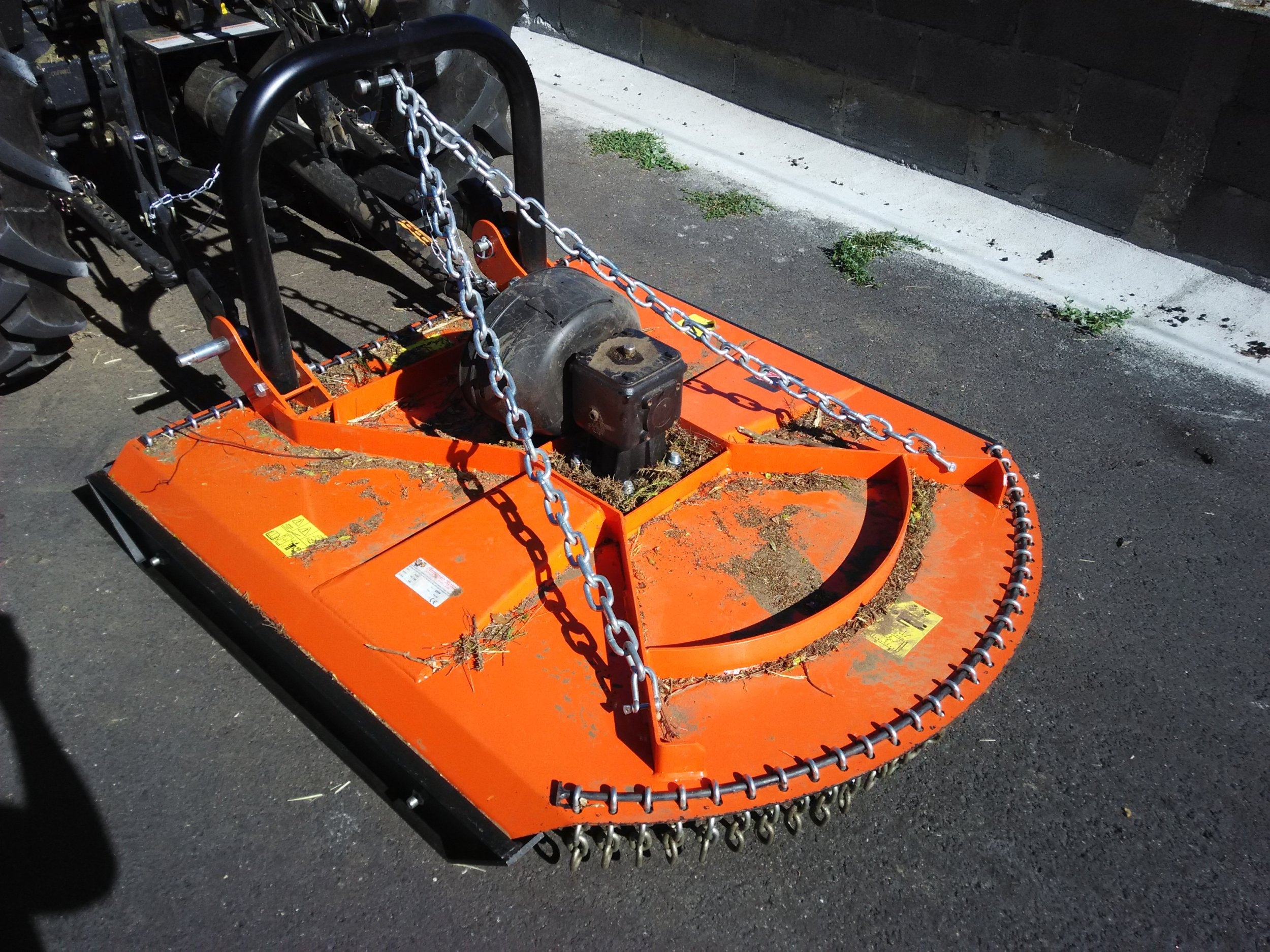

Use a chain instead:
Oops, you said quick hitch, that means you would have to hook up manually.

Many rotary cutters won't catch the top hook on a quick hitch. I need to take off the quick hitch to use mine. The chain "top link" looks like a great idea!

Would the quick hitch hit the “A” frame on the mower if going through a ditch? Certainly looks like it would.

Why don't the manufacturers just ditch those flimsy bars and run chains instead? So much better in so many ways.
   / Bought a Woods BB48X Rotary Cutter for my 1025R / Top Link Help #8
They do. This is the factory "quick hitch adapter kit" for my Frontier (Woods) GM1072R.
