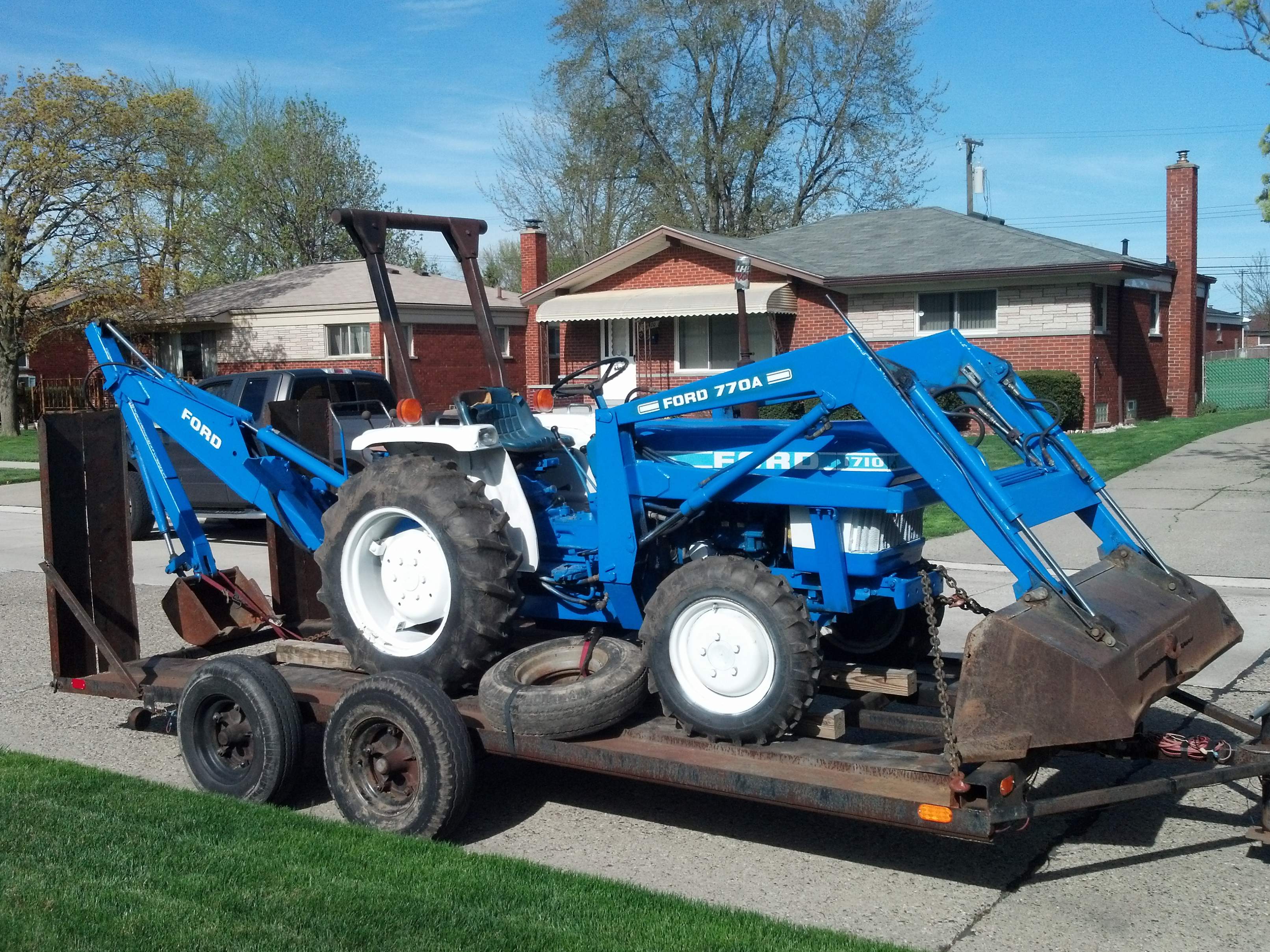

Cash, make sure those 6:00x16 front tires have plenty of air in them. They will bulge, a lot, with a full bucket. Also, right under the Ford emblem, there should be a brace for the loader, it connects the two sides and keeps the loader rigid. It looks like your brace is missing.
   / Bought my first tractor Ford 1710 4x4
#12
Yeah the brace is off in the picture as I just had the hood up. I will be sure to check the the tires also.

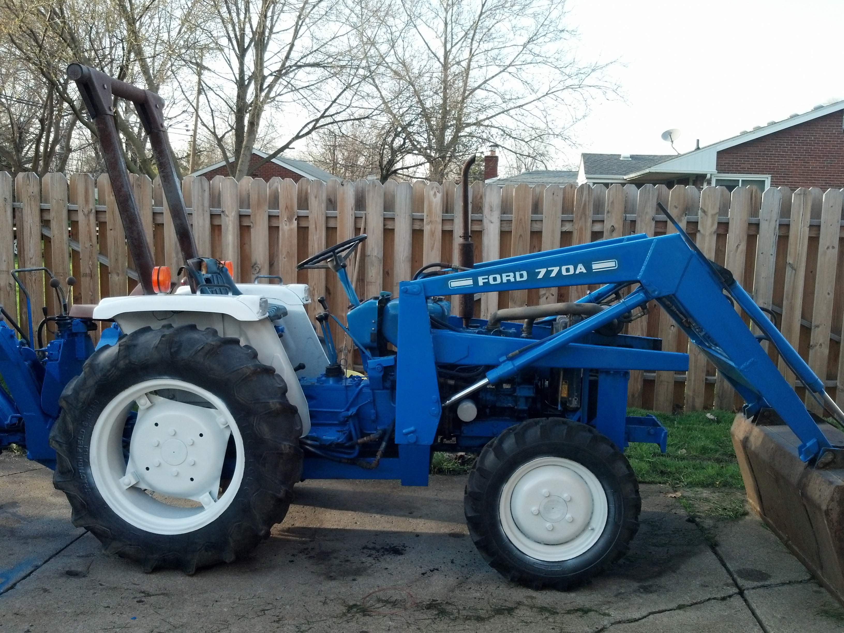

#15
Spent a little more time yesterday cleaning, painting and finished changing the rest of the fluids. Will be putting the hood back on today after I get it back from my dad. He bumped out some good size dents, fixed the grill and painted it.

Well here she is all cleaned up just before heading to the property to be put to work
