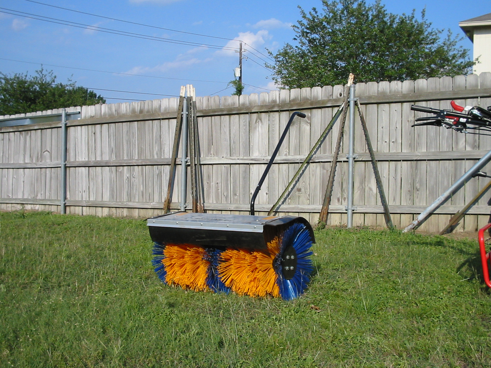

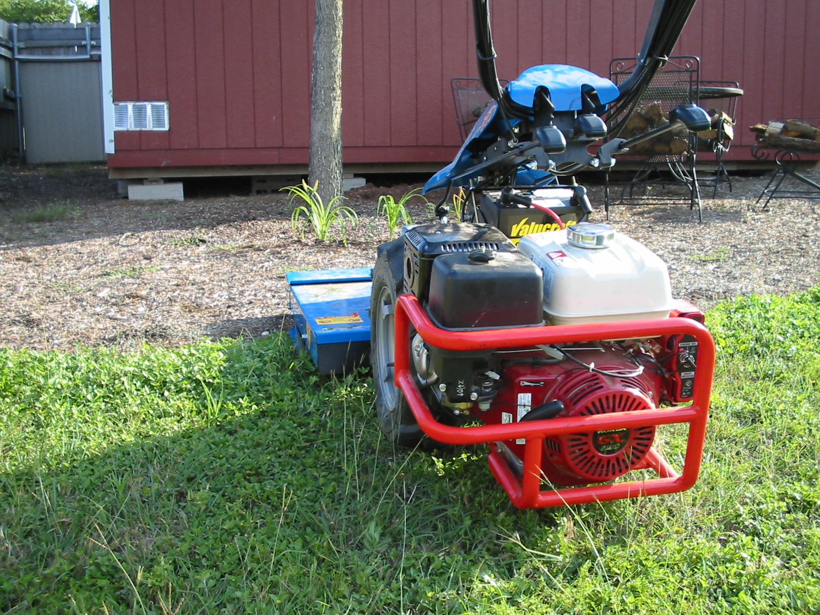

I just picked up a used BCS 853 with the electric start Honda engine, a quick hitch, a Del Morino 32 Brush Mower, and a BCS brand 31 Power Sweeper. The tractor has five hours on the meter, the sweeper looks unused, and the mower has two hours on it, and looks it. All for $3,000 cash.
On the bad side, it was originally purchased a two and a half years ago, used two hours, and then stored with fuel and with the clutch in the 'on' position since then. I went to look at it a week ago and the hour meter only had two hours. It would not start or even cough. Apparently they later flushed the fuel, changed the oil, put on a new battery and ran it for three hours to get it going, at which point I came back to test and then purchase it.

Off the bat it will be used to tackle brush and high weeds along a fence line, and in a tight group of trees. Both areas are too steep or tight to get a small FWD tractor into. Later a swivel plow, tiller, and probably other stuff. Let's not forget a 71" sickle bar for dam fun. :)

1. Clearly I am going to drop the tank and soak the carb, etc.
2. I have heard that leaving the clutch closed can cause the surfaces to rust. Is there a way to tell from use, or is this a "crack it open" and see type thing or don't worry about it? After running the brush cutter around my backyard for around fifteen minutes, it seems to shift gears just fine. I do not have the hang of "double clutching" to get the mower spinning, but it ran well too (as long as the engine kept going).
1. The wheels are 5x10x20 and the engine protective cage is almost on the ground. Should I go to the 6.5x12x23 wheels?
2. Earth Tools own adjustable axles look perfect. Anyone have opinions and/or experience?
3. Debris screen seems prudent with my intended use.
4. Turning using the brakes is harder than expected with the mower out front. The brakes work great with no attachment, but with the mower they only suggest a turn, the rest comes from me. Is that normal? I may have gotten spoiled from my commercial walk behind mowers that can spin on a dime (and tear the turf...) despite weighing in over 600 pounds.

Since the engine now starts and runs, if it were mine, I'd mix Sea Foam® additive with the fuel and let it run in neutral for 15 minutes. Dropping the tank and getting into the carburetor could lead to unintended consequences. Running in neutral for extended time is far better than holding in the clutch as the release bearing for most manual transmission devices is intended for only intermittent use. Continuous use (the bearing is engaged, spinning and working against the clutch spring) puts a lot of heat into the bearing leading to premature failure.
I don't think the Grillo tiller will work with a modern era BCS. My recollection is the PTO rotation is the opposite direction, plus the Grillo is a splined PTO and your BCS 853 is a tapered 3 dog PTO.
Yes to adding a debris screen. I am amazed at how much particulate matter accumulates on my screen when mowing tall grass, particularly grass in the pollination stage.
I have the 6.5 x 12 x 23 wheels and found that setup to be well adapted to mowing and the rotary plow.

Since the engine now starts and runs, if it were mine, I'd mix Sea Foamョ additive with the fuel and let it run in neutral for 15 minutes. Dropping the tank and getting into the carburetor could lead to unintended consequences. Running in neutral for extended time is far better than holding in the clutch as the release bearing for most manual transmission devices is intended for only intermittent use. Continuous use (the bearing is engaged, spinning and working against the clutch spring) puts a lot of heat into the bearing leading to premature failure.
I went ahead and did a carb job on it, followed by the Sea Foam routine you suggested, once I realized that the tank was "empty" when it still had fuel. Unfortunately I left the clutch and operator presence control clipped down for the whole time. Where did you read that keeping the clutch depressed was bad, versus putting it in neutral and letting the clutch lever open? I am looking thru the manual now and not seeing anything. I really hate to think I may have fried something letting the engine idle with Sea Foam for around half an hour. :mad:
