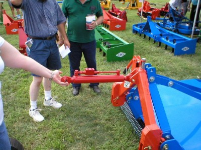

Do the top link/side arm cylinders drift much (or at all) from the desired position while in use? In other words, is frequent tweaking necessary to get the boxblade to stay in position? For example, if my loader bucket is in the air, it will slowly drift down to the ground. My understanding is that drift is more a function of the valve you use rather than the cylinder. I'm wondering if this is much of a problem?

OkieG, it's hard to say. I learned, when I had the B7100, that a certain amount of leakdown for the front end loader is considered "within specs". Mine leaked down too fast and they first thought it was the valve, but it turned out to be the cylinders. They tried seal kits, but eventually just replaced all four cylinders under warranty.
So I guess the answer to your question is that if either the valve or the cylinders don't seal completely, there will be some drift. With my B2710, I never had any noticeable drift either with the front end loader or the top 'n tilt. Guess I had good cylinders and valves.

To avoid drift (ok, reduce it) tilt and top link cylinders must be equipped with stop valve. That valve is mounted DIRECTLY on cylinder, before flexible hoses. If I'm informed good, it reduce drift, and eliminate stress on flexible hoses and tractor valve. Every setup, which I saw here on bigger tractors, alway have this walve. I guess that reason why I didn't see stop valve on any of your TNT topics, must be price. /forums/images/graemlins/frown.gif

I'm trying to imagine what kind of "stop valve" you're talking about. If it's a manually opened and closed valve, it seems that would almost defeat the purpose the hydraulic top 'n tilt since you'd have to stop and open the valve every time you wanted to make an adjustment. And if it's what we call a "check valve" that usually allows fluid to only run through in one direction, and that wouldn't work on a double acting cylinder.
Can you explain a little more so I understand just what you're talking about, or what I'm missing?

Sorry, I haven't picture. It looks like square block, mouted on cylinder, between cylinder outlets (connected by metal pipes usualy welded), and flexible hoses. It is actuated automatic by oil pressure when you act on remote outlet valve. It hasn't any handle.

Look at this picture of a top link.......that is a check valve on top

Thanks to both of you. I'm not sure I entirely understand how a check valve works in both directions, but have a vague idea anyway.
