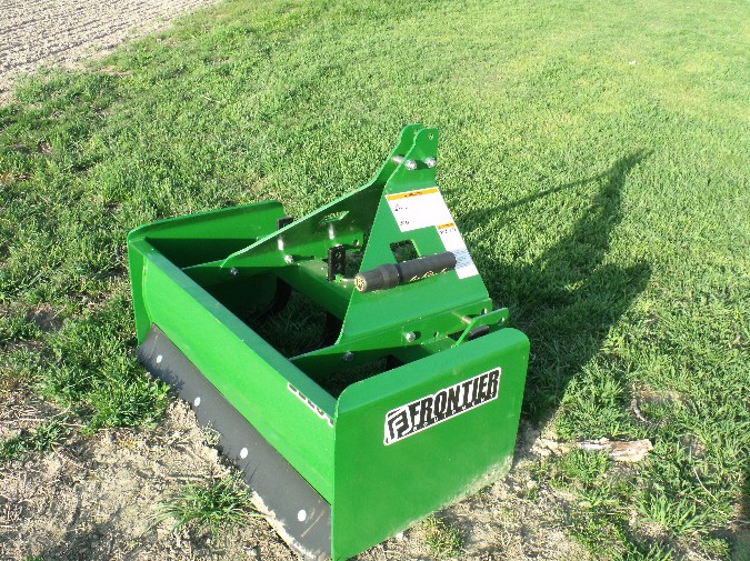

Is there any trouble getting them to stay on? i have tried concrete blocks and they shift around and get busted sometimes.
No. Except for once when I was really bouncing along one side fell off.
The frame on my Frontier allows the weights to sit in a pocket between the frame ends and the bar goes from side to side and just lays in on top of the side ends and the center framing..
