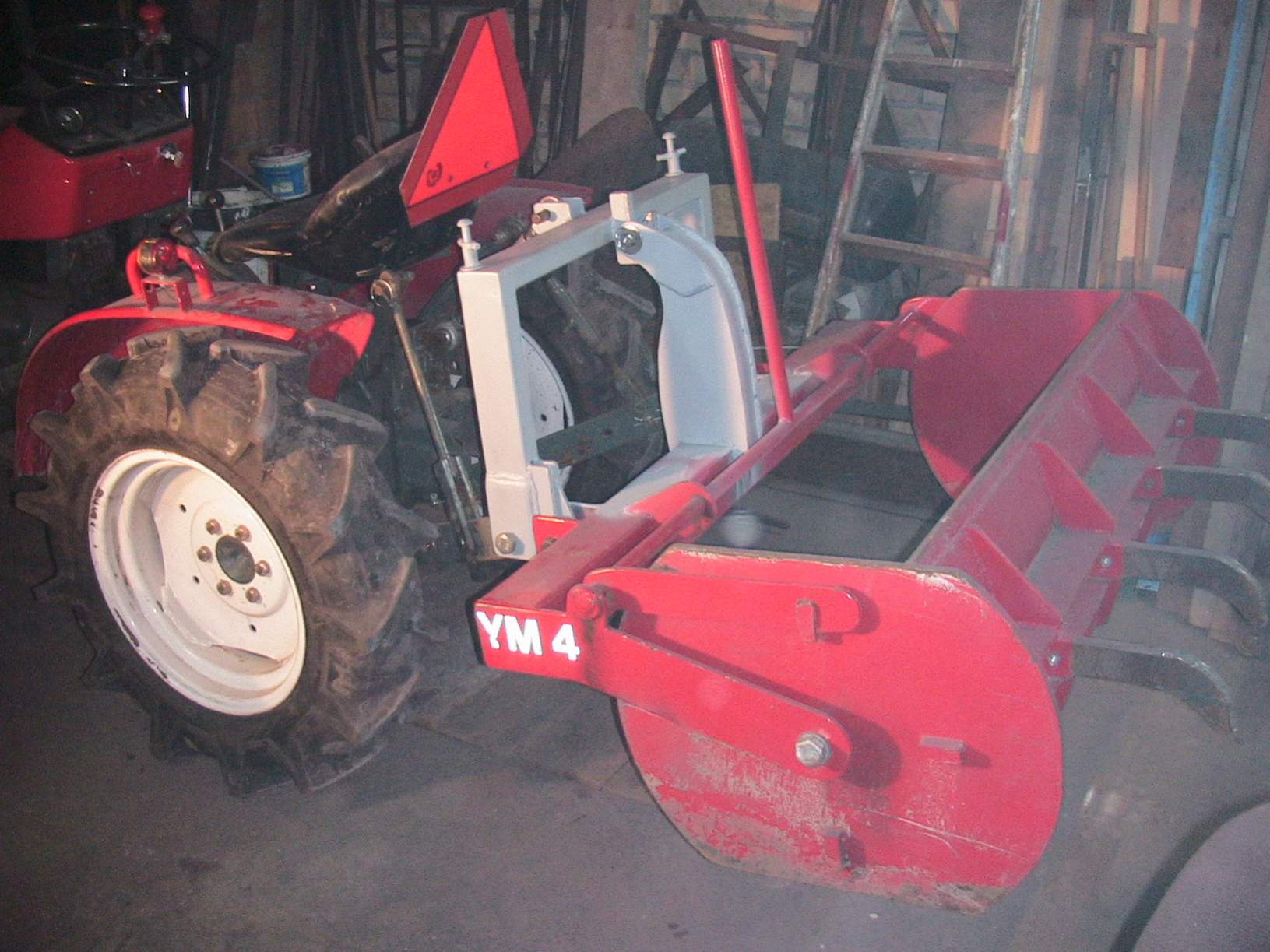

Kind of, i had mine made by a AG implement manufacturer.
Well, in reality it was private person.
The boss of the AG company allows his people to start their own initiatives using the materials and equipment of his company at cost so he doesnt loose his good people when business comes back.
So this guy knows how to build blades and ploughs and ... for big AG tractors and that kinda reflects in my boxblade.
I dont have the sort of equipment to handle 10, 15 and 20 mm metal pieces in an appropriate way. (besides the occasional thing)
So i figured they were more efficient, better quality and knowing what they were doing so should build something better at lower cost.
more here:
http://www.tractorbynet.com/forums/attachments/146726-custom-made-boxblade.html#post1693393
I could have done it myself but just calculating the metal parts and having them cut to size (you dont want to attack these plates with your handheld grinder) would already have cost me more than what i paid now.
So , if you have the time and tools why not? But as economy is low it is a great time to make deals and get proffesional fabricated things for less.

I built mine as I could not find even a conventional box here. But I really liked the versatility of a roll-over. I could not see myself liking getting on and off to raise and lower the scarifiers and I do not yet have rear remotes to make on hydraulic so a roll over seemed the best way to go. What is most important for your point is that I used all hand tools and nothing special. I only cheated once and had the main blade bent at a shop that has a big brake.
I felt that I had a need and set out to do it. It was not so hard, but it did take some time. I chronicled the build here on TBN. The link is in my signature. I had fun doing it and would do it again if I had a need. I have modified the top-link connection so that it fit my quick hitch that I made. That information is in the QH link below.
I definitely paid far less than the equivalent blade would cost in the States, but I also had the satisfaction of doing it myself.
