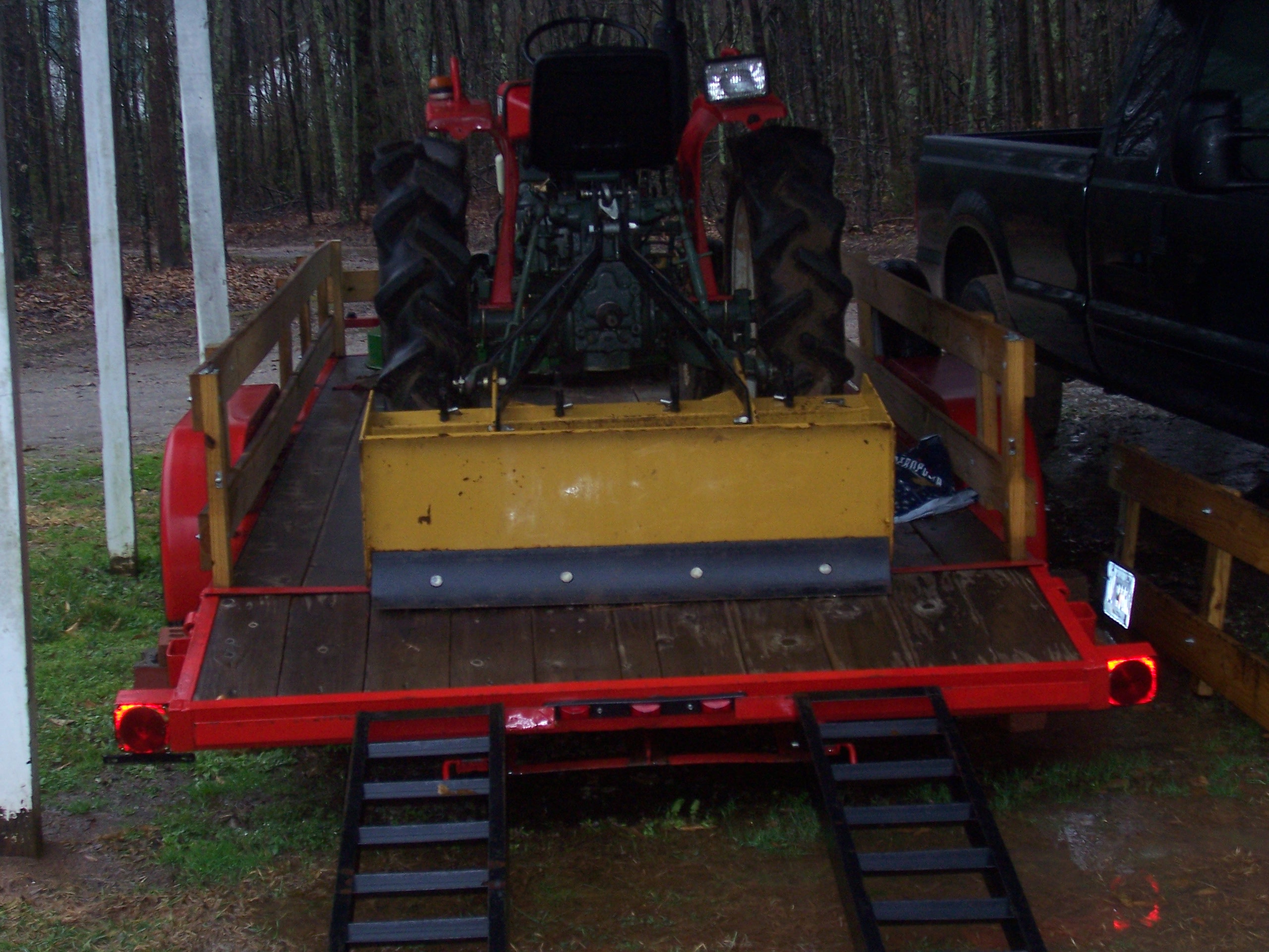

That is one thing I bought my compact for was to maintain my 3/4 mile DR. I just bought a BB that was the same width as my rear wheels. Make it easier not to catch it on anything your getting close to. I have seen the KK at tractor supply and is made as well if not better then mine. Which I don't use much now that I have all the problem areas worked out.

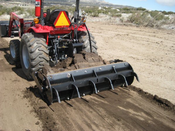

/ Box Blade Choice #6
Keep in mind that weight is your friend when grading. So I would be looking for the heaviest one that I could find that is the width that you want.
My Mahindra 3215 is about 60" wide, but I went with a 66" wide roll over box blade and am very happy with it. :thumbsup:
