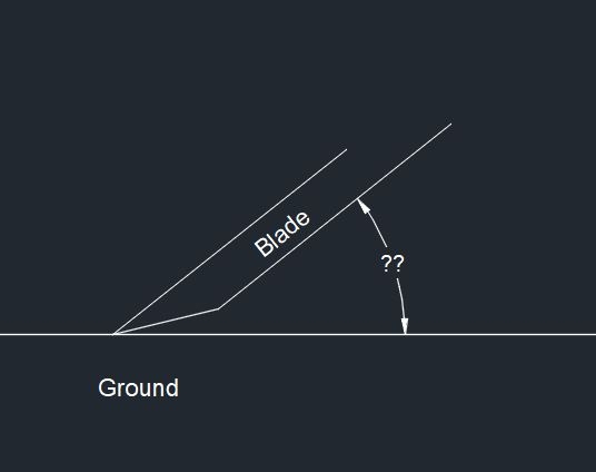

Hey Just wondering if there are standard angles for the cutting edge to be attached onto a box blade? I have 1023E and plan on building a 54" Box blade. I plan on using a strip of hardox for the cutting edge. I cannot however find a good reference on the cutting angle. If parallel to ground were 0 degrees and perpendicular to ground was 90 degrees. what should it be? thanks

70 degrees is a pretty normal angle for a cutting edge

HE is asking the angle of attack for the cutting edge.
A box blade dont really have any other angles other than that
And 70 degrees is pretty normal

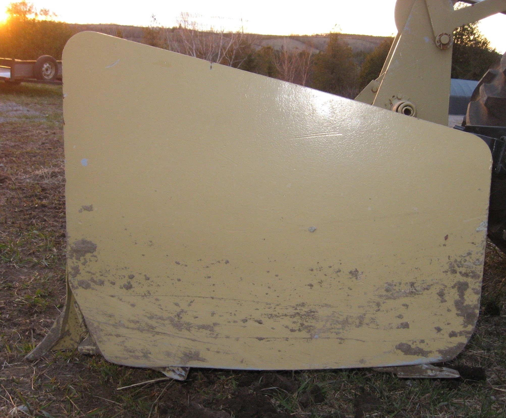

A picture of mine from the back side. I would have said the blade is nearly straight up and down but there is quite a bit of angle to it.

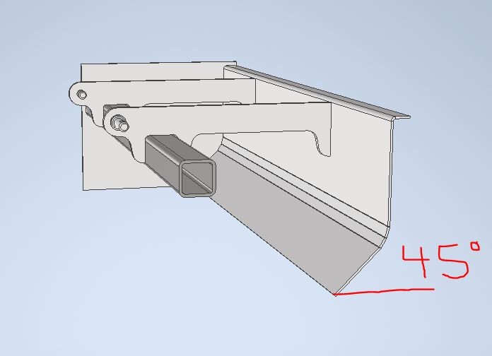

wow everyone thanks for all the replies! There is a bunch of good input, I attached an initial start to my cad model (its not done) . I'm wondering from what I'm gathering if i should do a 45 degree cutting angle. That may be a bit aggressive, but I'm unsure of the down falls exactly. as I see it it will pull sod/hard soil up instead of trying to push it. I understand that too much angle will bring soil up over the box? But my rear moldboard has a decently long vertical stretch. also by the the time the box is at capacity full of dirt I'm thinking the 1023E will be pulling pretty hard.
Also to handle a slightly more aggressive attack angle, I'm thinking about having a set of bolt on adjustable skis and also bolt on straight walls. I attached image of ski idea I'm thinking also. Also I see it that adjustable side walls/skis I can change the amount the blade protrudes past the bottom of the implement,
For the cutting edge itself I will be using 1/2" AR450 Hardox if im right. I will be grinding the bevel on the blade myself with a grinding jig... and patience

....to handle a slightly more aggressive attack angle, I'm thinking about having a set of bolt on adjustable skis and also bolt on straight walls....
No need for that, if it's too aggressive, simply extend your top link so you ride on the rear blade more...
A box blade is all about the top link length. Short it's aggressively digs in, the longer you make it, the less it digs and once you extend the top link enough to where it rides on the back blade, it will fill low spots and smooth out behind the BB.
