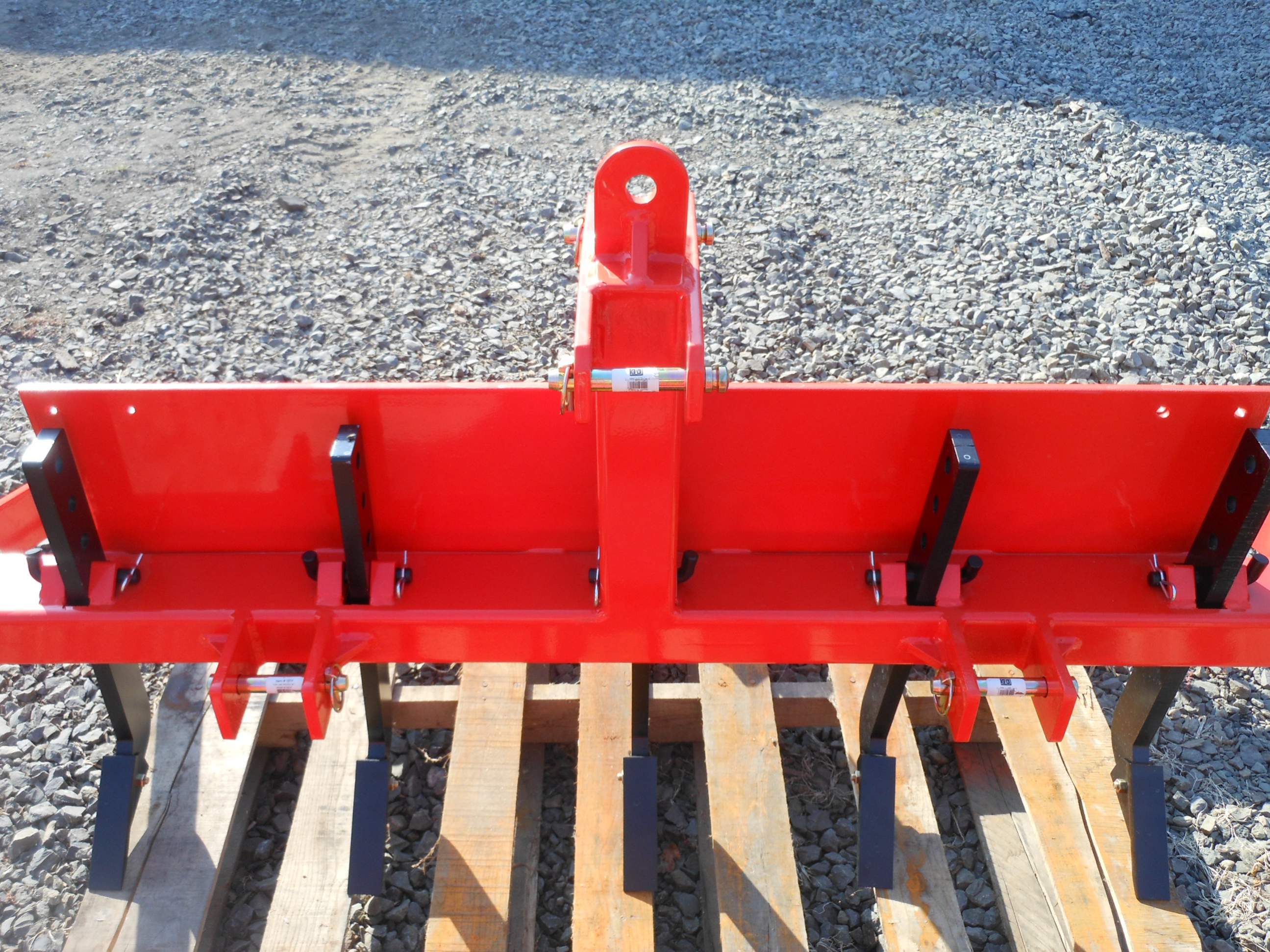

Yep, I've seen that before. I know of someone who turned his A-frame on his boxblade into a pretzel behind his Kubota. Here is a picture of what I do with my rakes. I use steel tubing with flat bar tabs welded on for the 3 point hook up. I would also look into adding a couple more tabs to the lower connection point so you have a clevis hitch, this will even out the stresses on the lower pins vs. using single tabs. Hope this helps!
That definately helps....good looking 3ph hookup you got there.

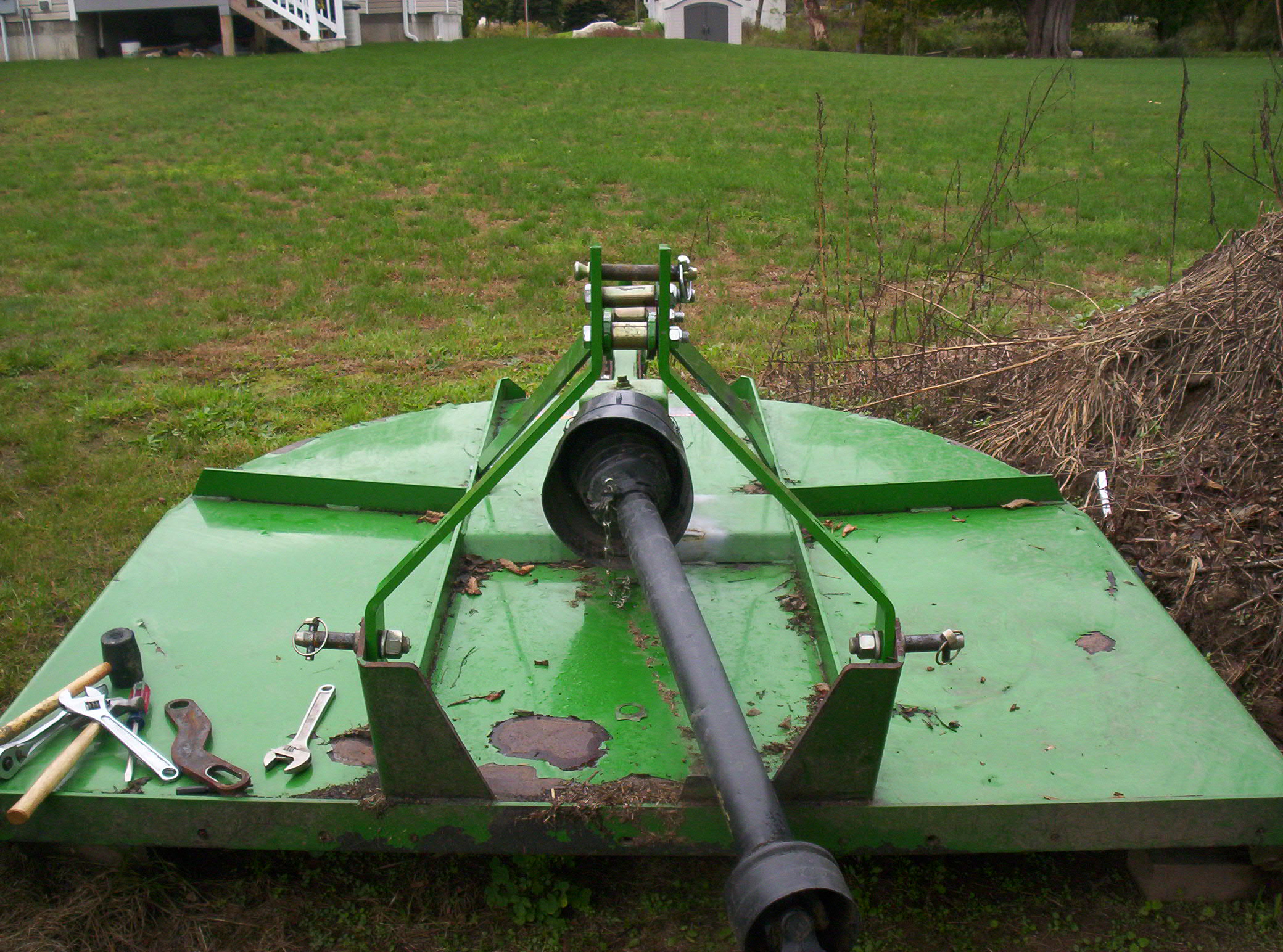

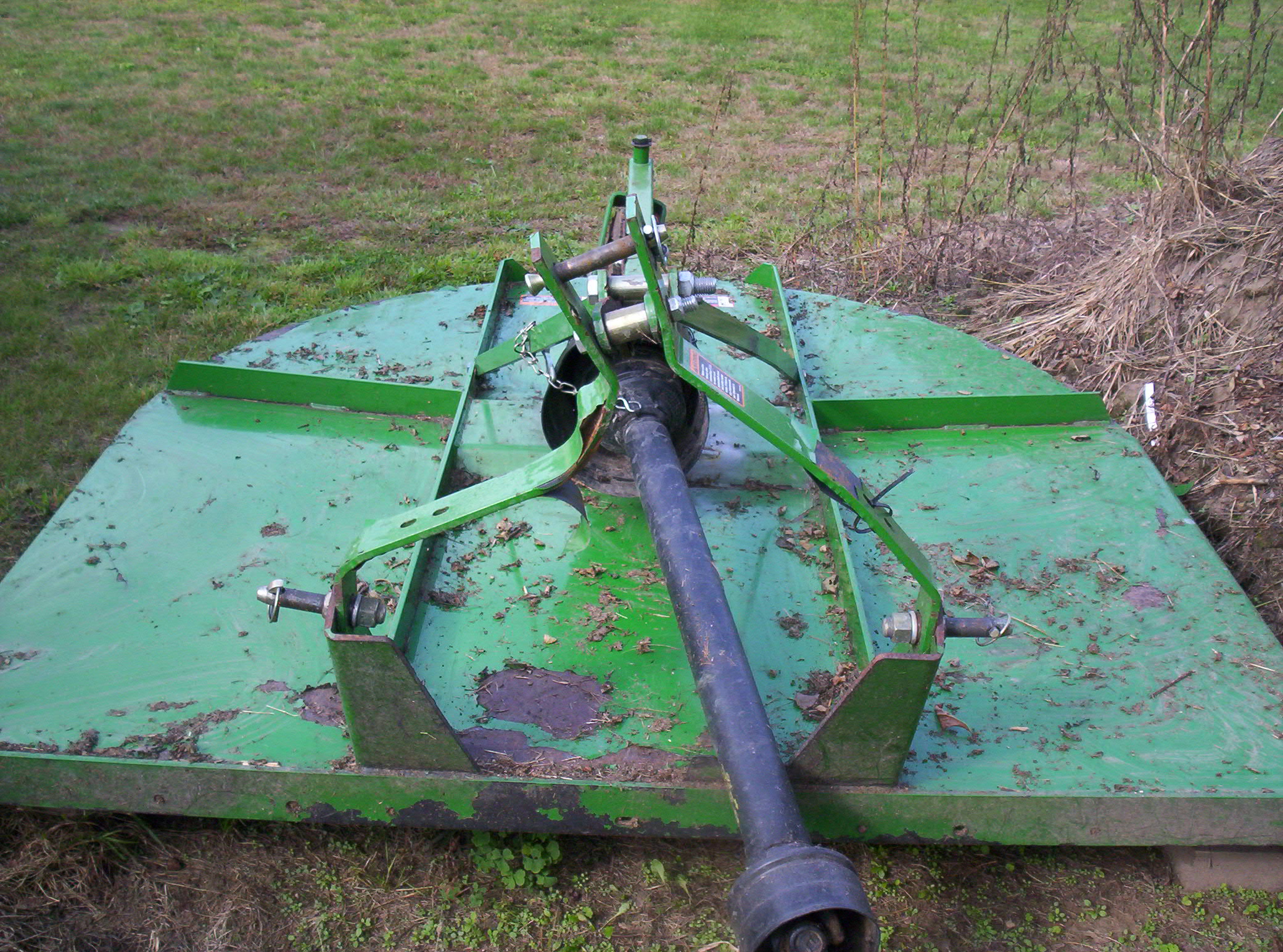

I had just replaced the cat pins with a cat 2 pin that fits a cat 1 bolt hole in the implement and it bent at the smaller end, the top of the rake was barely touching the right rear tire on the tractor but I would not drive foreward and risk puncturing an expensive tire. I am trying to find an "A" frame that is pressed out of plate steel just like the ones on a Howse blade, but not having too much luck finding one.
Been there, done that, lol. However my 70 hp JD 2555 is rough on box blades even in forward. I strengthened it repeatedly, and the only thing that hasn't broke is the plate style uprights. They would really not be hard to fab out of a piece of flat plate if you took a few minutes. Torch cut, torch heat to bend and drill and mount it on the boxblade. David from jax

Just wanted to post some pictures of the repair job.
/ Box blade damage #33
Very nice job! Did you put cat 1 pins back in?
