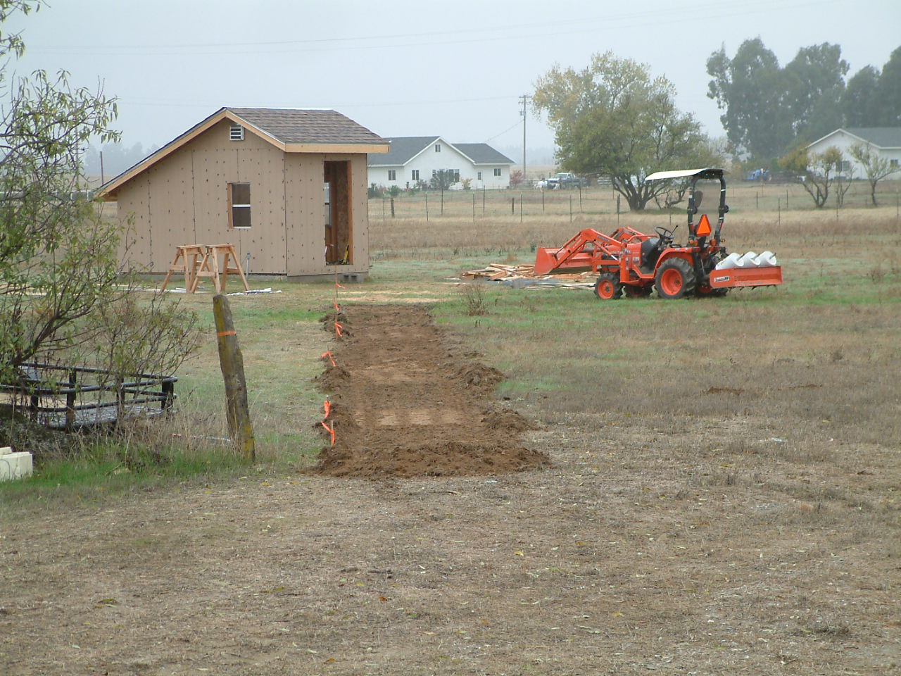

jbrumberg said:
To All:
To the readership- I am a believer in the 5 HP/foot rule for box blades. Can a 3K pound+ 29 HP 4WD tractor with weighted R-1's pull a 6' 550 pound box blade through rocky, clay based topsoil? Jay
I don't think you'll have a problem.
Here's what I doing right now with my 21-hp B7510HST/LA302 FEL--cutting a walk path from the back porch to the observatory shed.
That's a KK 4'ft box blade (about 240 lb) with 360 lb of concrete weight added to cut through the sod. It's rained a little up here in the North Valley the past week so the top inch or so of soil is damp. I'm using the BB with full scarifier bite in soil that gets progressively more rocky as I move toward the house. No problem so far. Just cut the turf/soil with the BB to about 3 inches deep and scoop out with the FEL.
I'll put a layer of sand and road base gravel in the excavation and then pack it with my water-filled roller towed with the 18-hp lawn tractor.
