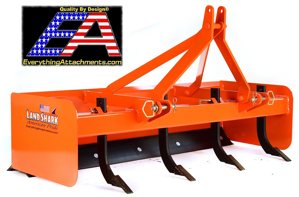

Here's my pick.
US Made including Made in USA Ripper Shanks and Cutting Edges.
The 48" Land Shark Box Blade is currently only $559 and the 60" is only $599.
Free shipping to a staffed commercial business or nearest supporting freight terminal within 1,000 miles of Newton, NC.
Travis

Travis - That looks nice. What is the height of the moldboard? I want to make sure I get decent lift/clearance. Thanks
Thanks.
The moldboard height is right at 16".
We will be adding more detailed specifications soon.
Travis
