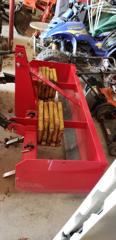

I use 400 lbs of oil well jack weights to make my box dig in good. I can easily throw a couple off if it's digging in to much. These are 40 lbs each, 5 on each side. 20190314_162445.jpeg
