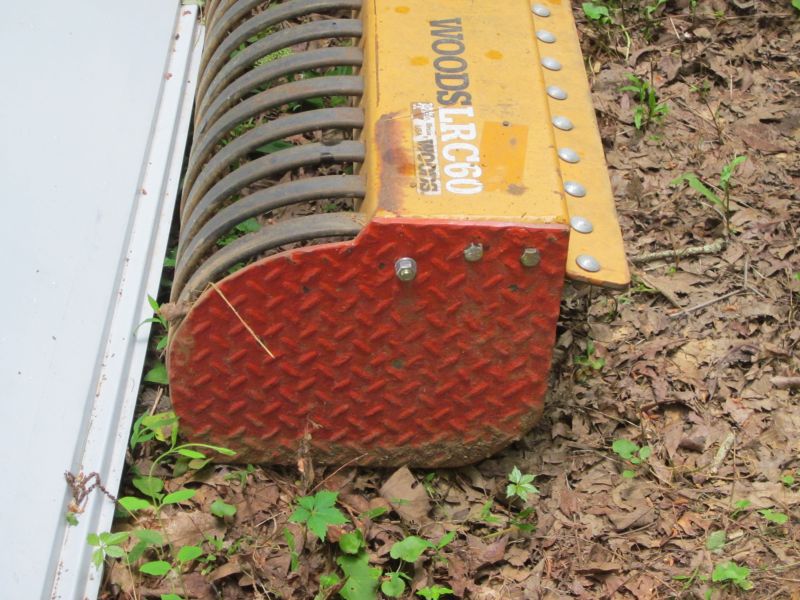

I put box end plates on my landscape rake specifically for the purpose of eliminating windrows which it was notorious for leaving before...
I know this is an older post, but I am intrigued by the end plates on the rake. My landscape rake is quickly becoming one of my favorite attachments and I did add wheels, which helped when going forward anyway (can not back up without raising rake because they do not have enough room to spin around and they dig small trenches).
I really like the ideas of end plates but wanted to know what others think particularly /pine? Even when I get my angle right, I lose some gravel on the unintended side. Not much but it seems like with these end plates you could keep it straight on roll on without losing anything.
Seems like you would also get a nice clean line/edge of gravel.
Thanks.

I love my rake and for an established gravel lane it is far and away the best attachment for grooming and recovering migrated gravel...some may say that a plane is best but a rake is capable of doing the same thing (with a few more passes) and most rakes can be angled which is not an option with a land plane etc...
The only negative of a rake is...it will tend to separate loose gravel from the fines...
The main reason I added the end plates is the windrows of escaping gravel (requiring more passes) which they stopped...along with hydraulic T&T they also perform the same basic function of gauge (training) wheels...!
When I first added the end plates (making a virtual "box rake") I thought I would be taking them on and off depending on what I was doing...but I have not removed them ever...and love my rake even more...!
Good Luck...

Thanks for the feedback, I was wondering if still working good for you and sounds like that was a big yes.
Agree, landscape rake is awesome for grooming gravel drive (and pulling out kudzu and briars, moving limbs and several other tasks too). I make it work very well with the gravel, but the plates just seemed like they would make it almost perfect, going to get some made next week. I will snap a pic and post when complete.
   / Box Blade Gravel What Am I Doing Wrong??? #38
Finally got this done and got to use it, worked well for me. I even ran the rake at an angle a couple of passes and used the end plates to scarify some short/shallow ruts, probably too much side pressure on them to do that often, but only had my rake with me on this last trip. I can see where windrowing might be beneficial sometimes, but majority of time not what I want. The plates left a nice edge of material where I wanted it.
Can’t seem to attach a pic, but the picture is pretty basic anyway. I just had some rectangular (angled off the leading corners) plate welded to a 4 in long piece of 3 inch angle and oriented such that the angle lays on top on the angle for the rake (that holds the tines). I drilled two holes in the new angle in line with the 2 existing outer most bolt holes that secure the tines. Took out the bolts and ran them thru the end plate angle and back through the tines.
I made the plates such that the tines run about 2 inches below the plate. As /pine said for his, they do also function kind of like the gauge wheels as well. I’m wondering if I should’ve made them about an inch or so shorter, but leaving as is for now, will be relatively easy (but not easily reversible) to cut an inch or so off bottom of plates.
Thanks for the idea and pics.
