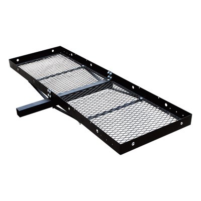

A hitch mounted platform carrier could be used if you put a receiver on the box blade, instead of just a ball. Put a box on it.

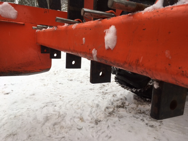

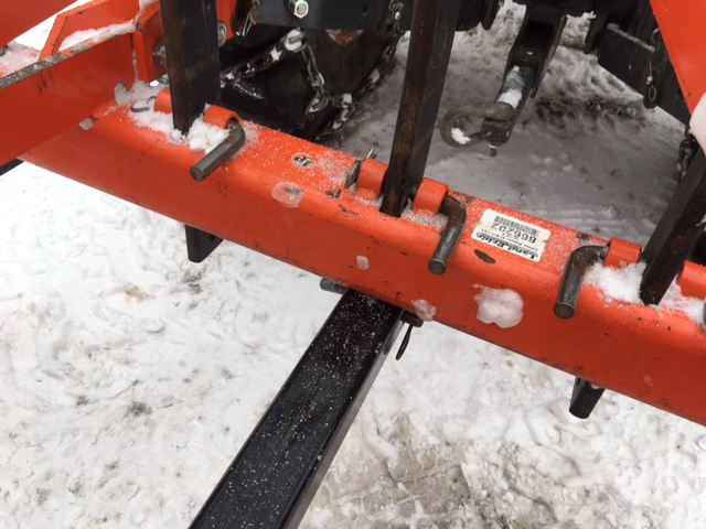

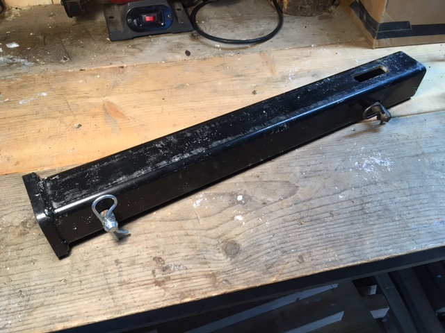

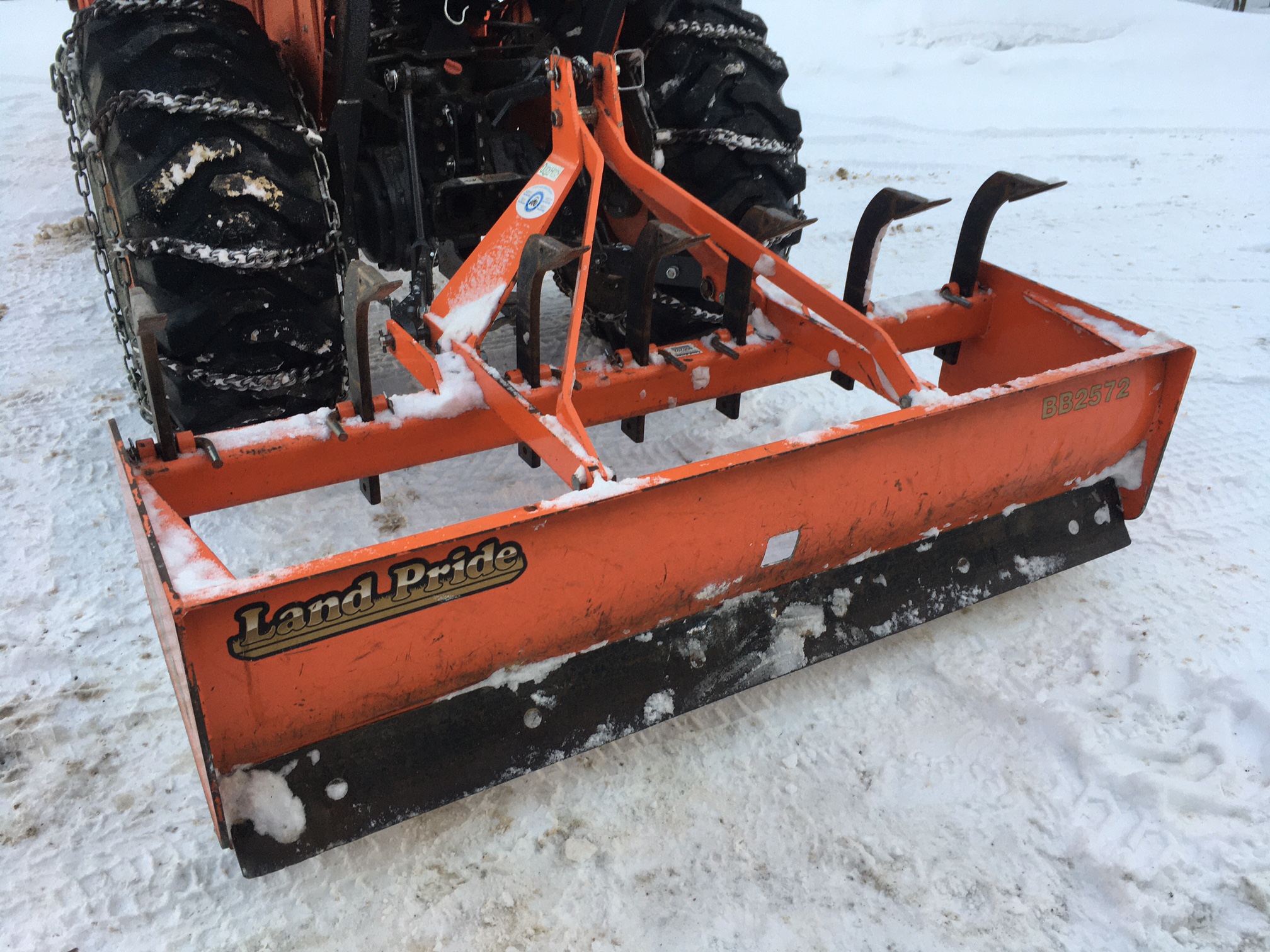

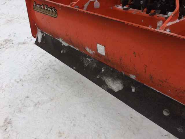

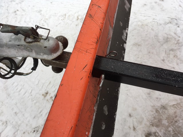

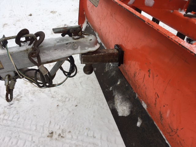

Well, I can't say I want to "show off" my work because my welding skills are less than stellar

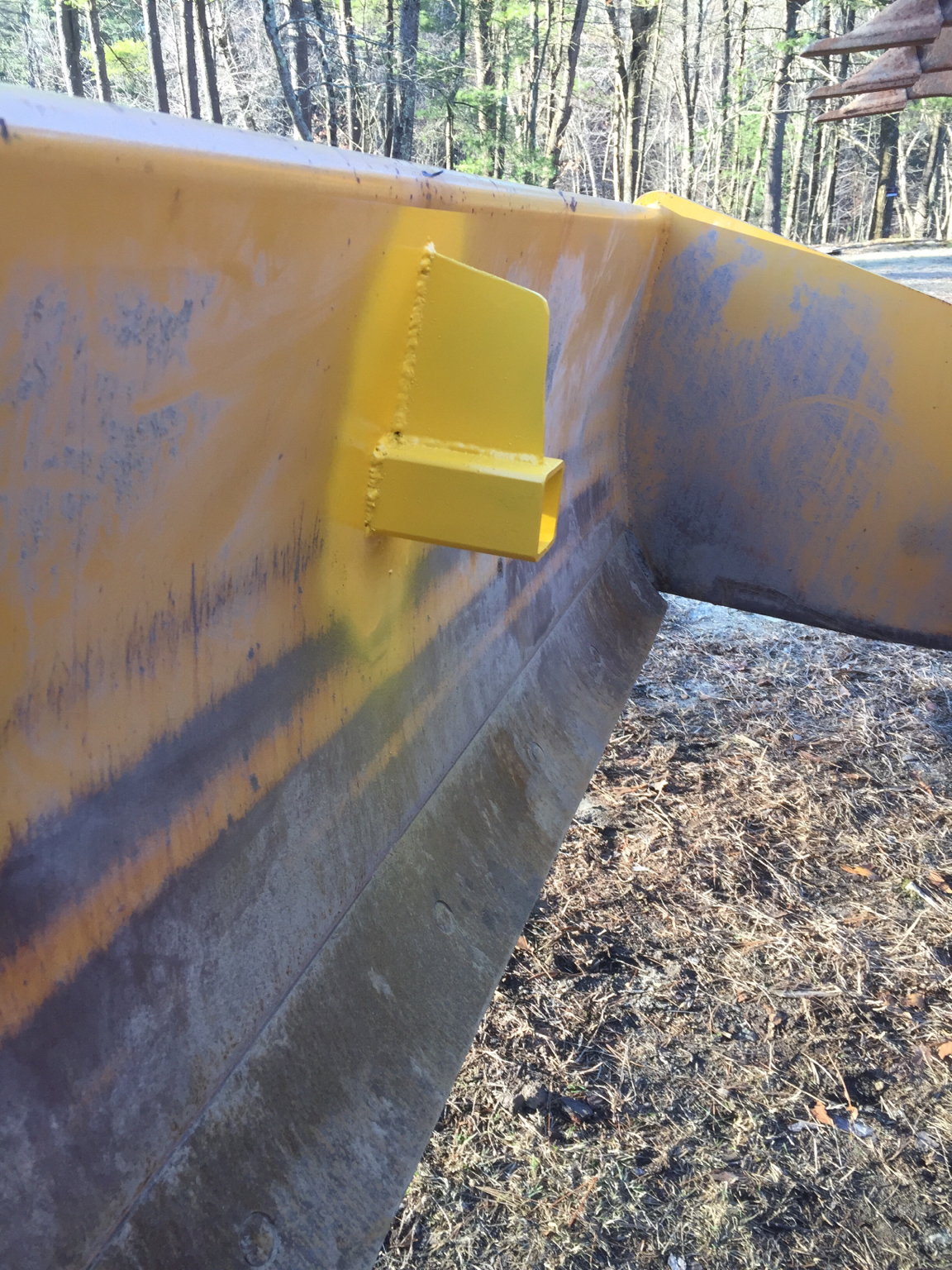

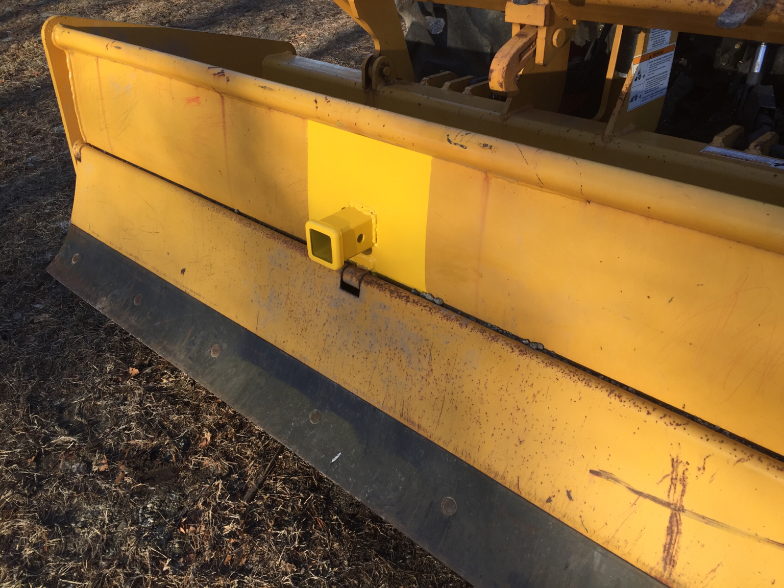

However, here is how I added a 2" receiver to my BB.

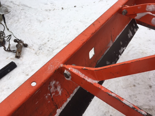

I marked out the location and drilled out the four corners, then sawzall'd the opening, and welded in the receiver. I added a support bracket as well.
The only real considerations I had to be mindful of, were keeping the height of the hitch above the hinge for the rear blade, and since the hydraulic scarifiers could hit the receiver hitch portion that protrudes inside the box, I just had to make sure the hitch itself was "between" scarifiers.
Since these pics, I've replaced the trailer hitch with a 6" (maybe even 8"?) drop hitch. It works excellent.

Piston that looks good! I have hydraulic rippers too. I was hoping to also be able to drag logs etc if needed. I'm wondering if I would need to add bracing from the hitch to the front of the box near the 3pt attachment. Obviously you didn't. Was that ever a thought or concern? Maybe I'm overthinking/over engineering?

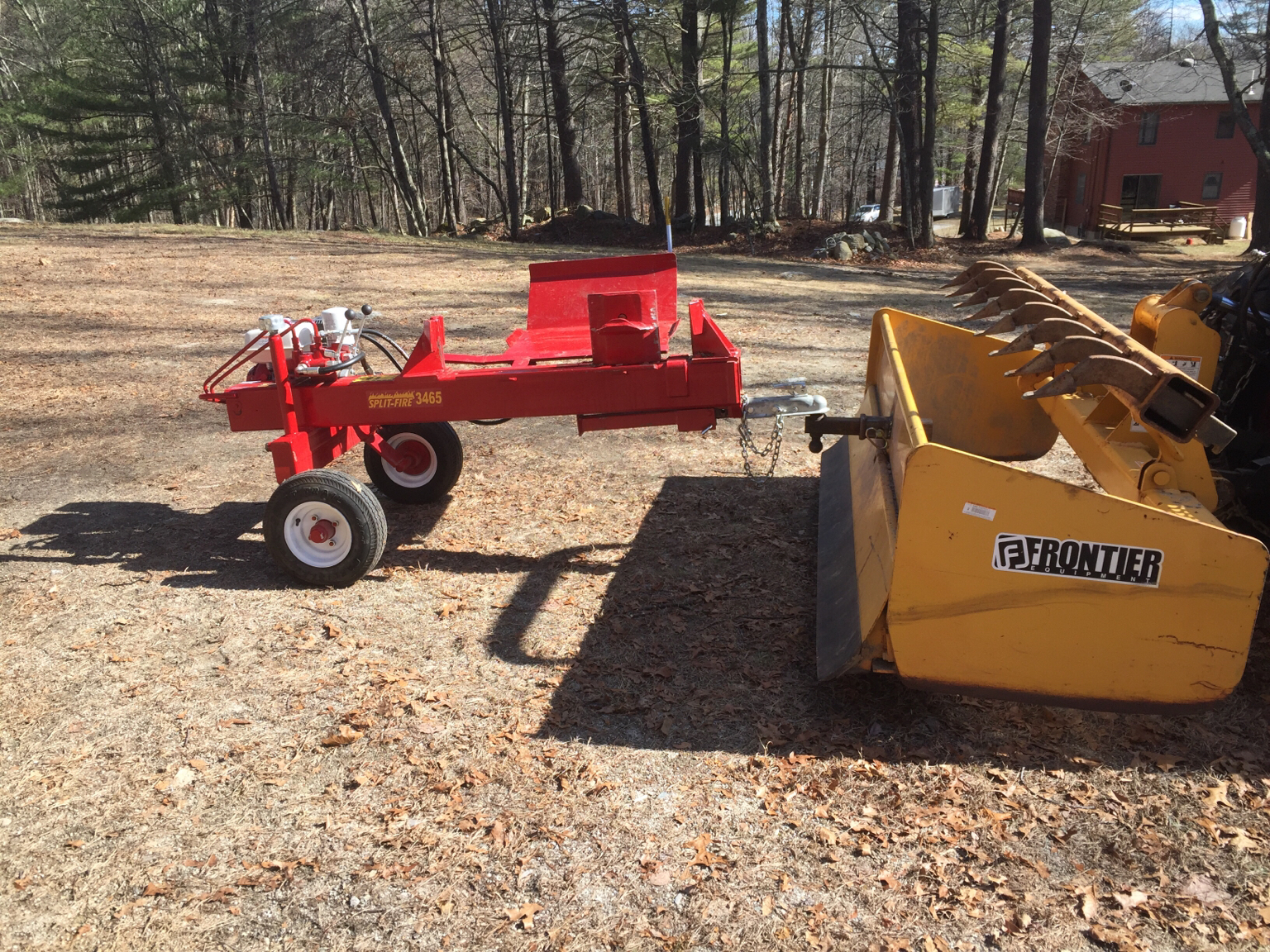

My intention for this hitch was mainly to use it for pulling my log splitter around. Of course the log splitter is relatively light at 500lbs or so, so keep in mind I'm not planning on skidding logs with it.
However, even with my elementary welding skills, using the bracket I feel it is structurally competent for considerable forces. I don't "think" you would need any more support than this.
I do tow around a small 700lb dump trailer but I don't do anything extremely heavy with it.

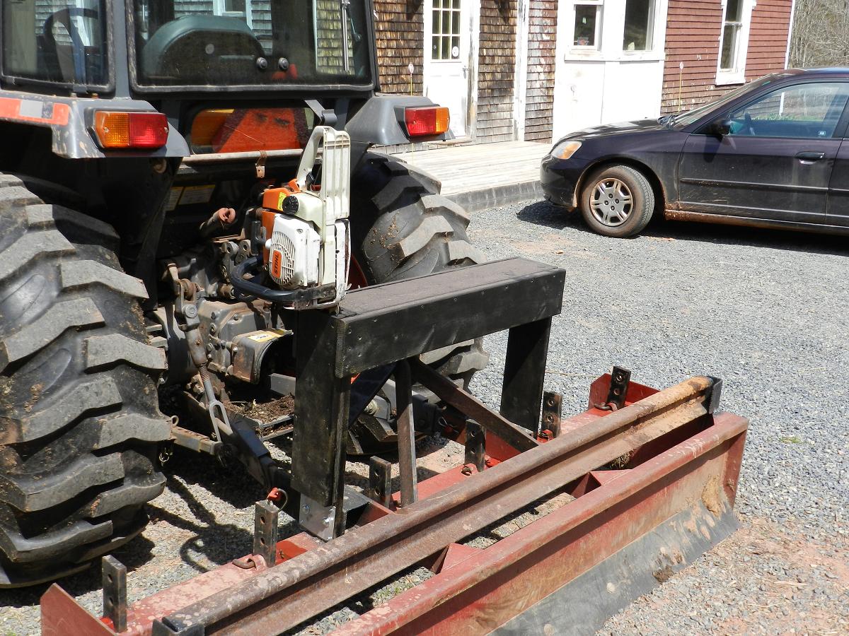

Ok I did the google search and found some good ideas. I like the receiver through the moldboard idea. Adding the bracing will be a must for my needs.
I had an idea the tray I'm going to make would sit above the BB however it would be easy to just extend it off the back as shown above.
