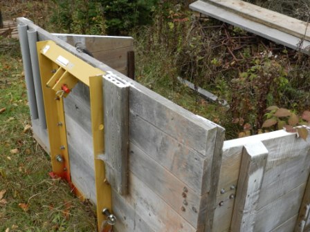

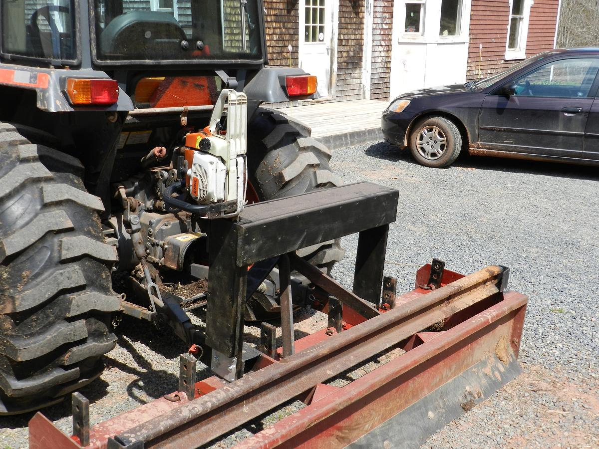

Adding receivers is still on my list, but I have added chainsaw scabbards to my carryall, box blade and chipper. Here is the box blade one:

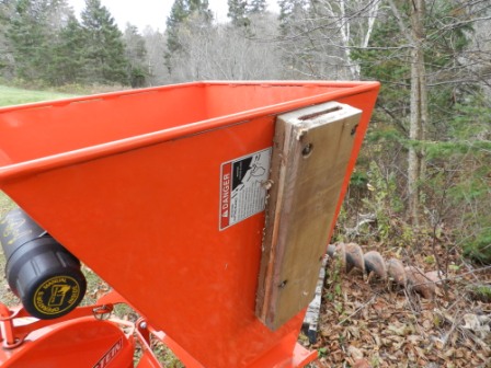

and, the ones on the chipper chute and carryall:

I'd be interested to know how the scabbard was attached to the BB. It's hard to tell what is metal and what is wood. The scabbard looks good and looks like an easy addition.
Except for the screws, the only metal parts are the two shiny metal plates at the base (you can see one) of the uprights. The rest of the bracket is made from 1x6 PT deck board leftovers, with a couple of plywood strips as spacers in the chainsaw scabbard itself.
If I were doing it again, I think I'd build in storage space for my other chainsawing gear...all the rest of the bracket is currently just wasted space. Or, maybe make it a bin for a logging chain or two... I may someday get around to doing some mods.
   / Box Blade Hitch add-on #15
Sorry, I didn't completely answer the question. The black, square pieces welded onto the BB and to which the chainsaw scabbard bracket is bolted were themselves a mod. Originally the BB came with pins supported at just the end, but these bent pretty fast. So, I had a neighbor weld on brackets with through-holes for lower hitch pins supported on both sides of the lower hitch arm balls. Because of the design of my BB, I think I could have attached my chainsaw scabbard bracket anyway, by drilling/bolting through the orange piece to which the aforementioned black pieces are welded.
I wanted the wooden pieces sandwiched between metal to make them more durable/stable, hence the shiny pieces (cut from an old aluminum scoop shovel that had given up the ghost).
Oh, I was lucky that the chainsaw still clears the back of the tractor cab and fender when the 3PH is fully raised; I didn't plan for that when I built it, so just lucked out!

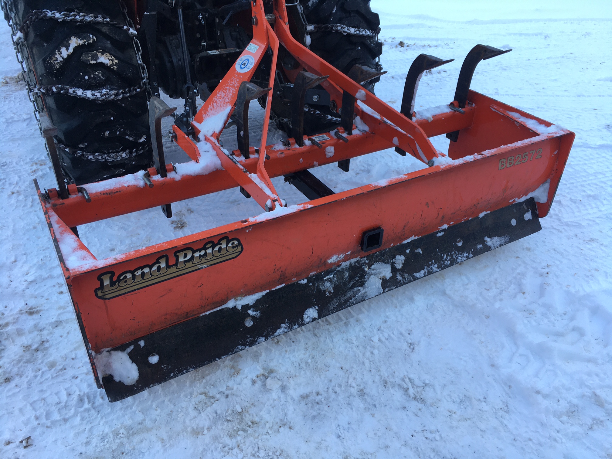

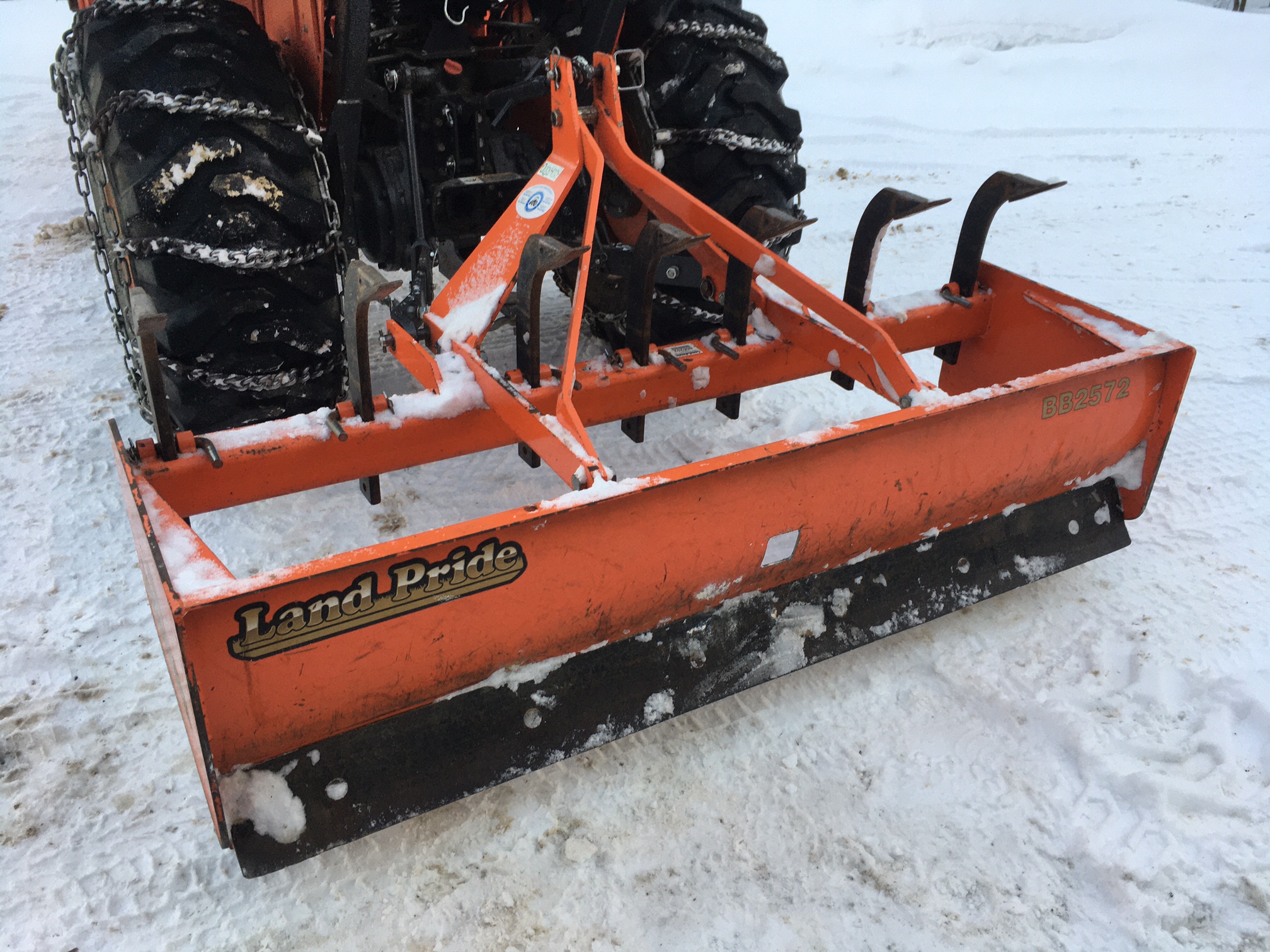

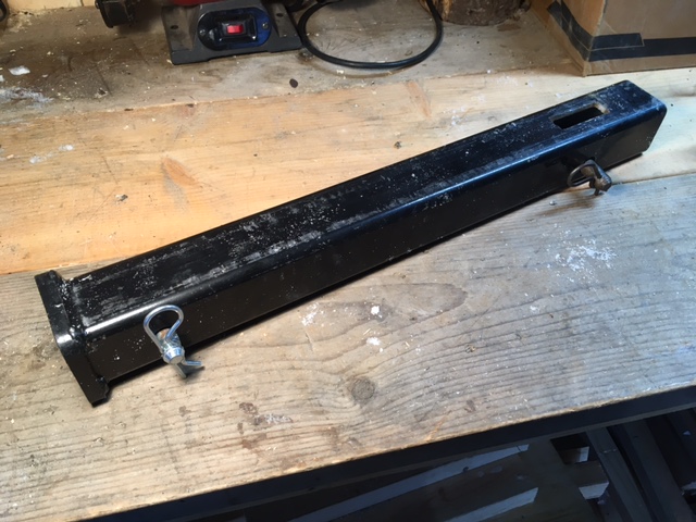

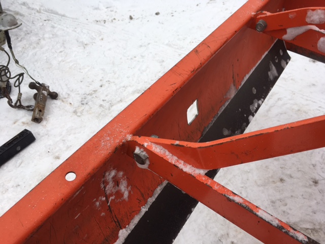

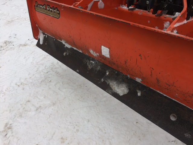

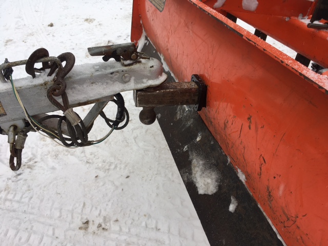

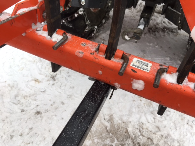

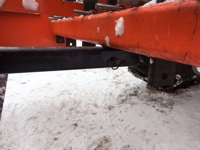

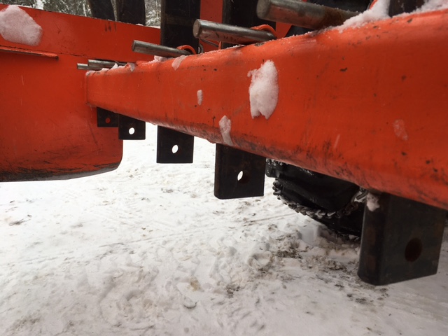

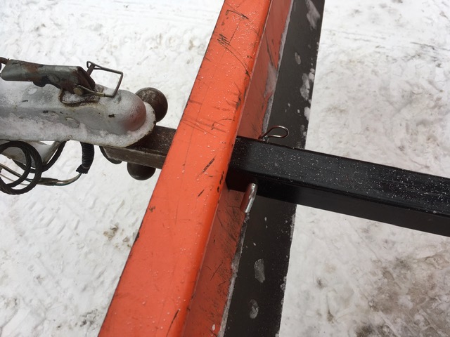

Old thread but got some ideas from here. I wanted to see if I could make my hitch tube removable when I wasn't using it so it wouldn't get in the way of material or be clogged up. I was able to use a 24" hitch tube that slides through the a hole in the blade and pins into the inverted ripper shank. Works well and I can pull it when not in use.
View attachment 685329View attachment 685330View attachment 685331View attachment 685332View attachment 685333View attachment 685334View attachment 685335View attachment 685336
Very clever idea! Thanks for posting.
