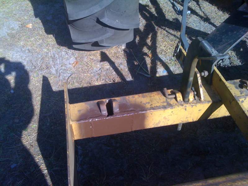

I did exactly the same thing to my boxblade, probably on a root. Saw it after I did some spreading some dirt and grading some old dirt piles that had trees growing in them. To fix, I removed the ripper, pounded the ripped section back into place, which required a little grinder touchup to make it fit. Then I welded it back together, and then welded a 3/8x1 flatbar on the bottom edge, so if it tried to tear again it would have more trouble ripping the back out. Seems to have done the job.

A couple of the repair I did to my box, I ripped a chunk out of the backside of the ripper tooth on both sides, one was bad the other had just started.
What I did was cut out a section and weld in back up metal , then I "v" the pieces I put in and made 3 passes with welder
I used that way for a while then I made 6 pieces of metal plate and welded in on bottom of channel, it lapped over the first repair
It work real well I used it until I found a real deal on heavier box, I sold mine and it is still being used with no problems
