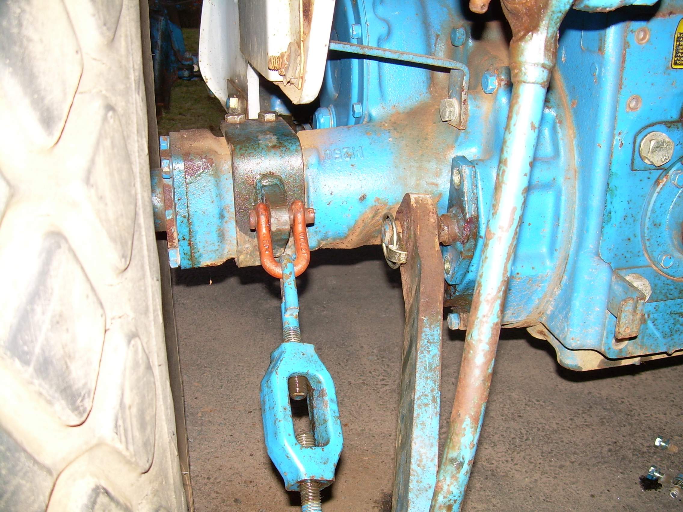

First of all welcome.
Yes you should have side sway stabilizers to prevent that, usually they have a turn buckle to snug them up and keep things tight.
Here's some pics, see if these look like yours.
JB.

/ Box Blade Oops!
JB4310
Thanks for the pics. No, I do not have the stabilizer you are showing. I have the lift arms, and the support rod? that goes up, but not the stabilizer with turnbuckle you have.
I'm guessing they do the same thing as check chains like has been said.
Thanks again
Nolan
