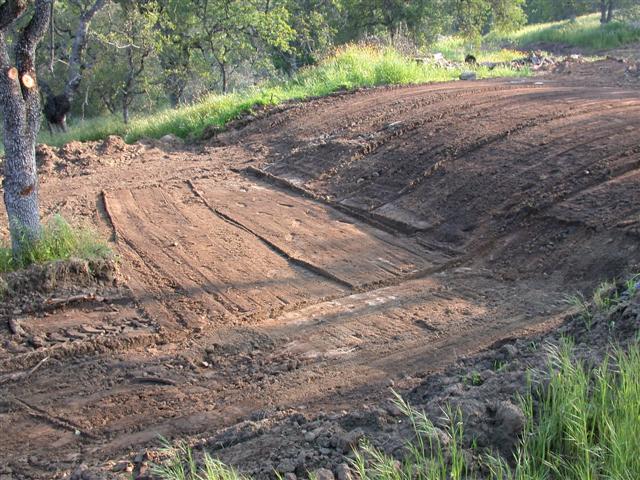

Yup, that sounds very doable too...although I don't know if you could get the same amount of weight that way? I was thinking of mounting the concrete buckets upside down on 3 vertical pipes that would be welded on the back of you box. You might have to weld a flat mount piece first, then weld the pipes to that. They only need to stick up about 8" to 10" (peter length /forums/images/graemlins/grin.gif) then slip the pipes as shown in that picture over them. That should not get in the way. You could also weld a re-inforcement strap from the front of the box to the back...2 of them and weld the pipes to that in the middle. Take them off when dozing with the bb...generally, I found I don't need the weight as much when doing that, more for dragging forwards.
</font><font color="blue" class="small">( I have been really successful bending ripper shanks straight with either the rosebud on a torch or using a good ol' propane weedburner as a forge.)</font>
Well so far after my modification I have not gotten close to bending or breaking a shank. I did a bunch of grading for my battery shed (solar system) last weekend and hit solid DG on nearly half the pad. Rand into a couple of Oak roots that caused the tractor's tires to slip but no damage. Also re-graded my road and managed to pull out some big rocks. Non of these obstacles made a dent...so I'm super happy with the mods. Attached is a picture of the area I'm working on. Next week I'll start pouring the foundation.
