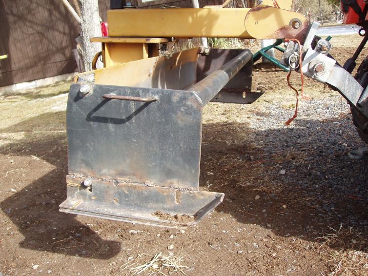

   / Box blade or grader blade #24

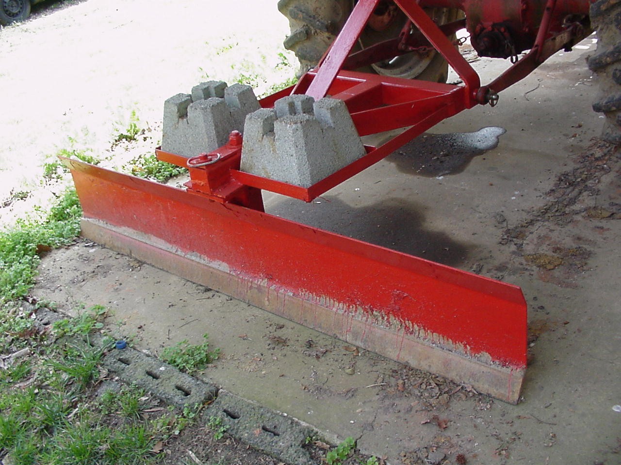

I just picked up a rear blade for a specific job I need done, but I will be making some sides for it that can be bolted on and off easily. Similar to the picture below but with out the round cross tube, will make it much better for moving material around and the angle iron on the bottom would act as skids. I'm big on multi purpose/use equipment. As far as the land plane goes, I built a small light duty plane/leveler, and I am impressed with what it does on my driveway. It is more of a "resurfacing" tool. Loosens up the hard pack areas and levels it and smoothes the gravel like it was just put down. It also works great for weed control. I HATE weeds in my drive way. When the weeds start growing in the driveway, I just run the land plane over it and it digs up and kills the weeds and resurfaces it again.

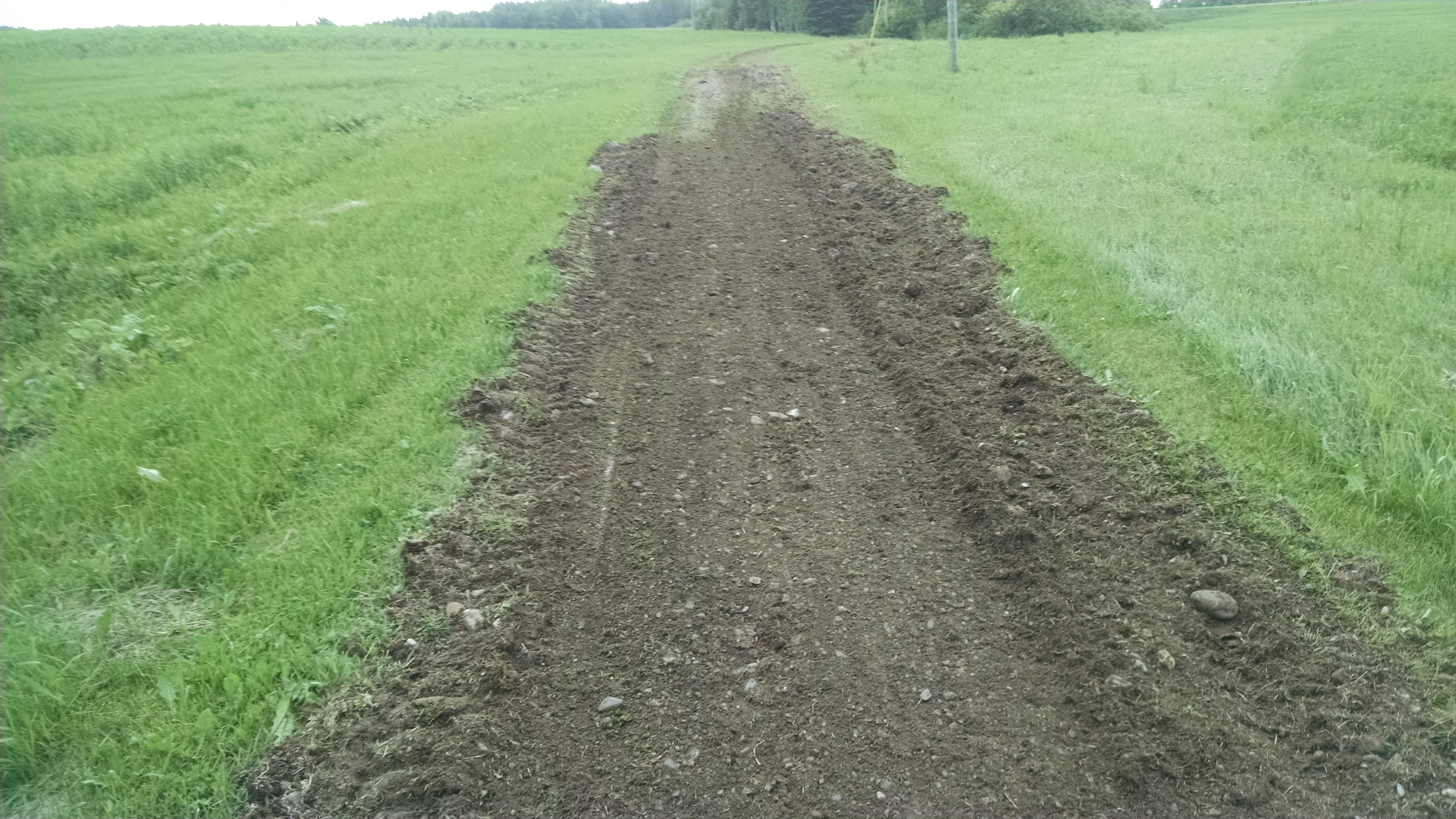

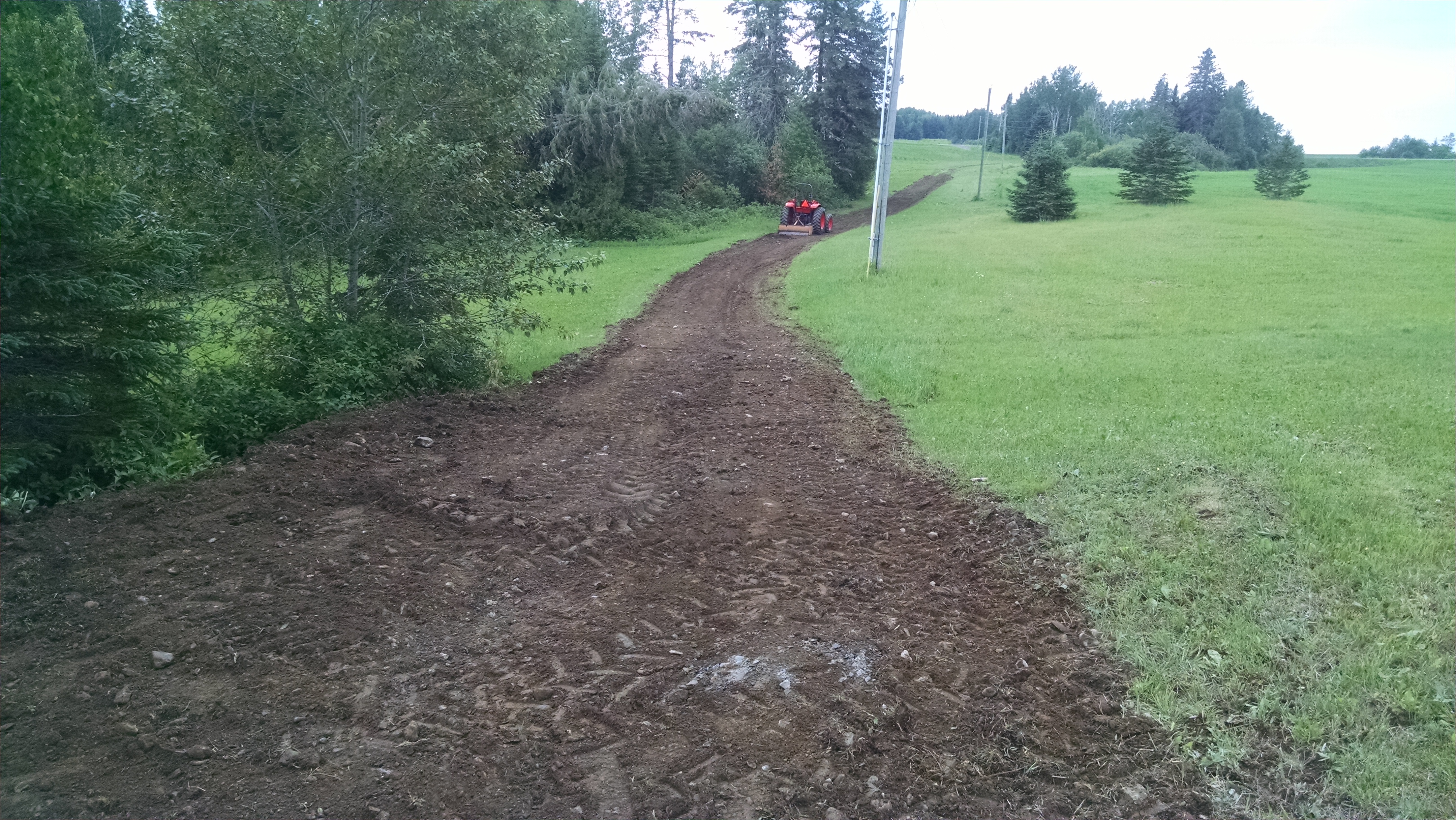

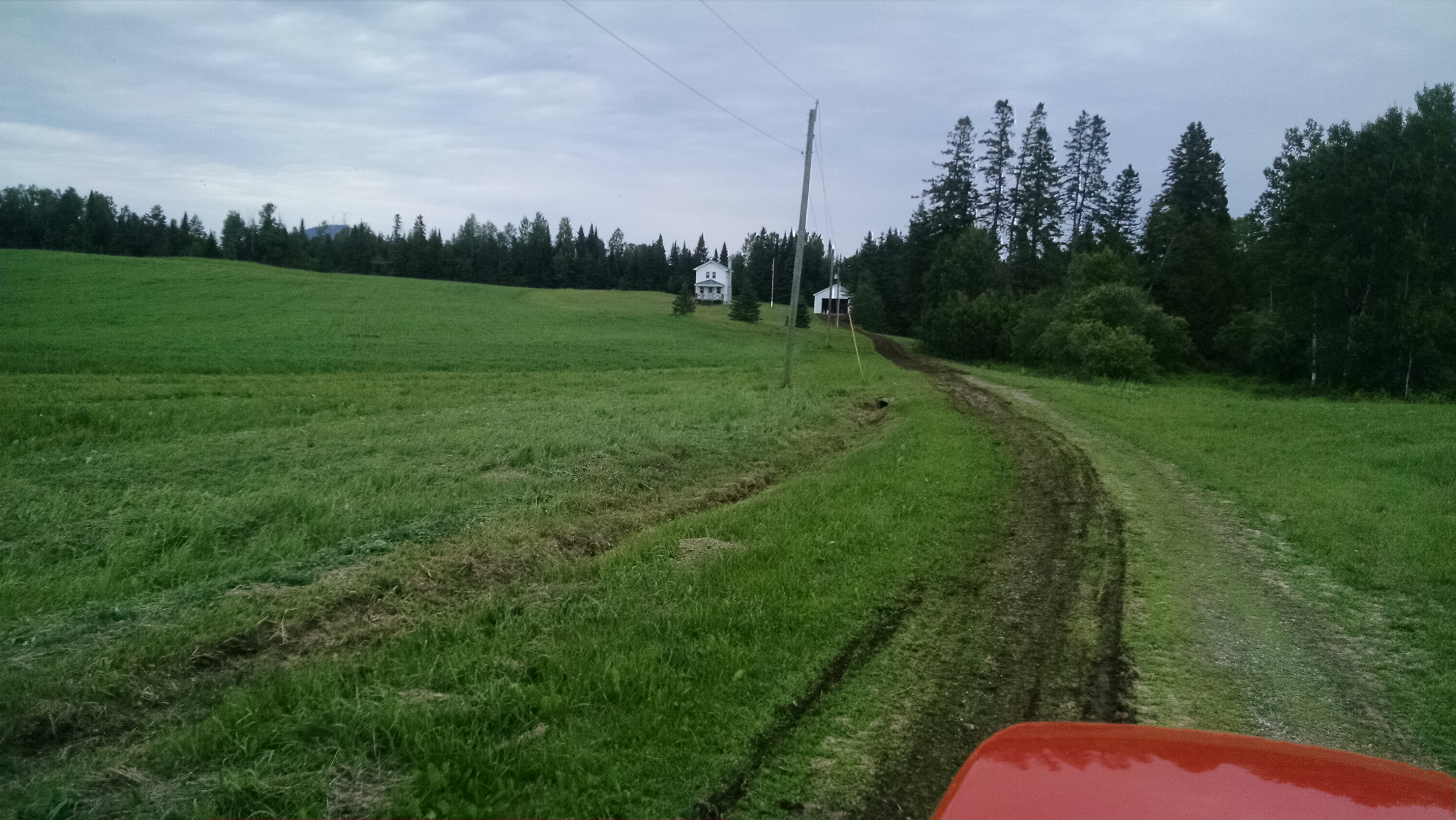

Today I picked up a 5' box blade at the local rental outfit. It's a heavy duty Woods... weighs about 450 lbs. I set the scarifiers on the top position and brought the top link all the way in. It took several (more like 5 or 6) passes to break up the top layers of sod, compacted stone and loam before the material was malleable enough to move and shape. It seems the more I dig into the material the more gravel gets exposed. There's a fair amount of loam in the mix which concerns me somewhat. I'll know better what I have after a few weeks of rain and sunshine. I'm only into it for about 4.5 hours and i have most of the driveway material broken up. I have it for another day. There's still a fair bit of shaping to do. I want to see if I can put a crown on the driveway and there's a few stretches where I side gulley might be in order. I think it's best to keep the tractor speed to about 4-5 mph while I scraping. I used low 3rd gear. It seems to spread the material better at that speed. Here's some pics. IMG_20180630_145833640.jpgIMG_20180630_145901569.jpgIMG_20180630_145906105.jpgIMG_20180630_151125107.jpgIMG_20180630_151558908.jpgIMG_20180630_151605256.jpg
