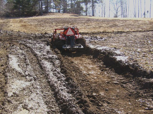

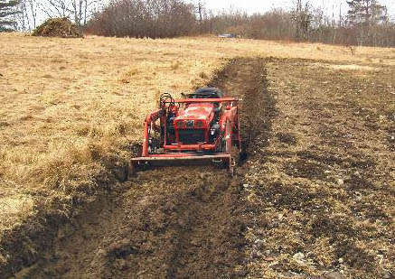

Learn how to use your bucket as it will do most of the tasks listed. Use a back blade with gauge wheels to level all things out.
Don't worry about your tractor size. It will do everything you want but may take a little longer. Adding chains will greatly increase your traction and is not that expensive.
Kubota B7100HST digging a ditch.

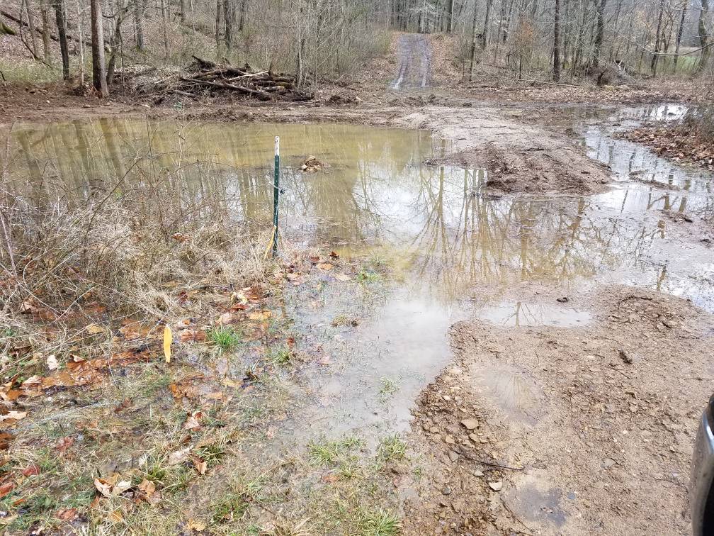

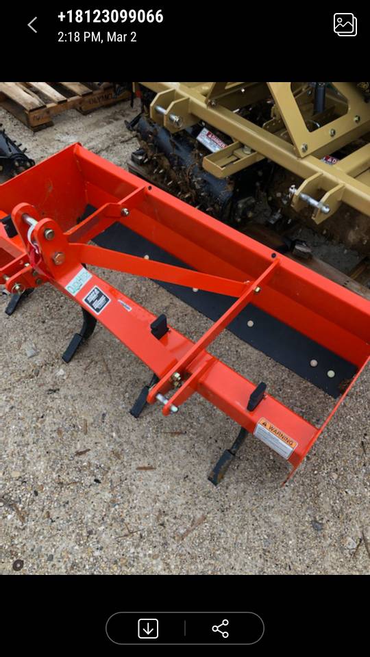

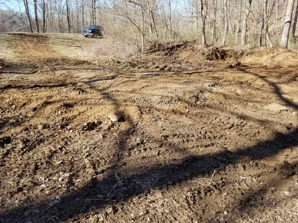

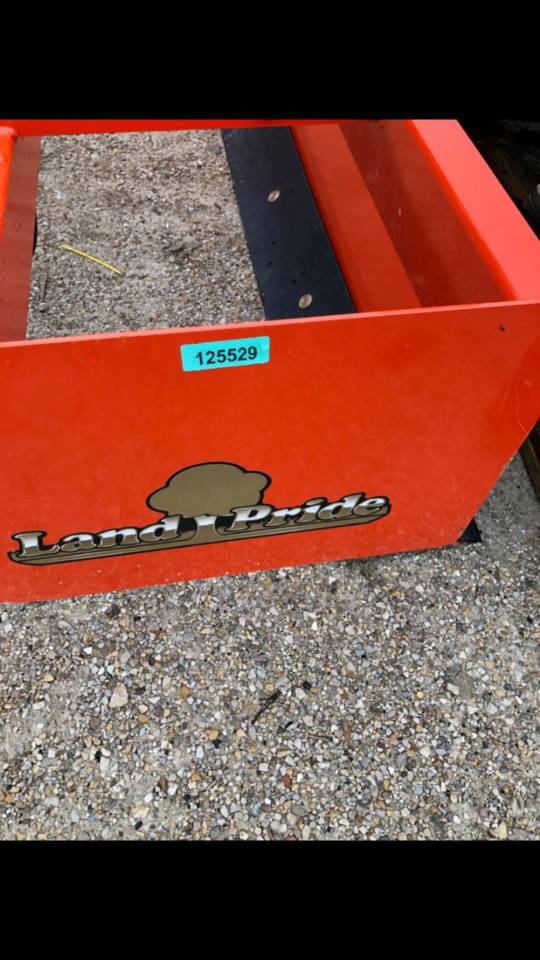

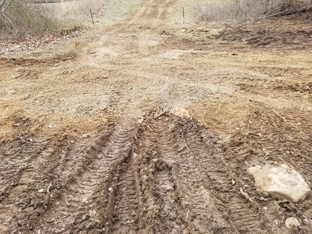

Hard to tell in the photos but I've been able to build up this small section about 6 inches higher over 4 days of work using my loader. It floods bad in the lower spots. The water is coming in off the neighbors hill and down my hill meeting up and running across. I picked up a box blade today used for 500 and will see if I can move more dirt with it. Still have a lot of mounds of rocky dirt I can push out. My idea is to make the entire thing level then dig a small crevice with my loader/box blade along my hill to divert run off to a nearby creek. Later I'll rent a mini excavator, buy a culvert and dig a deep trench at the end of the crevice I dig with tractor.
The dirt seems to pack well and stays dry just need to move more of it and get a ditch at the bottom of the hill to run it all off.
Is this too much water to fix with drain tile? Picture of the box blade I picked up today too. 20200229_143930.jpeg20200301_152743.jpeg20200302_132822.jpegScreenshot_20200302-141847_Messages.jpegScreenshot_20200302-141852_Messages.jpeg
