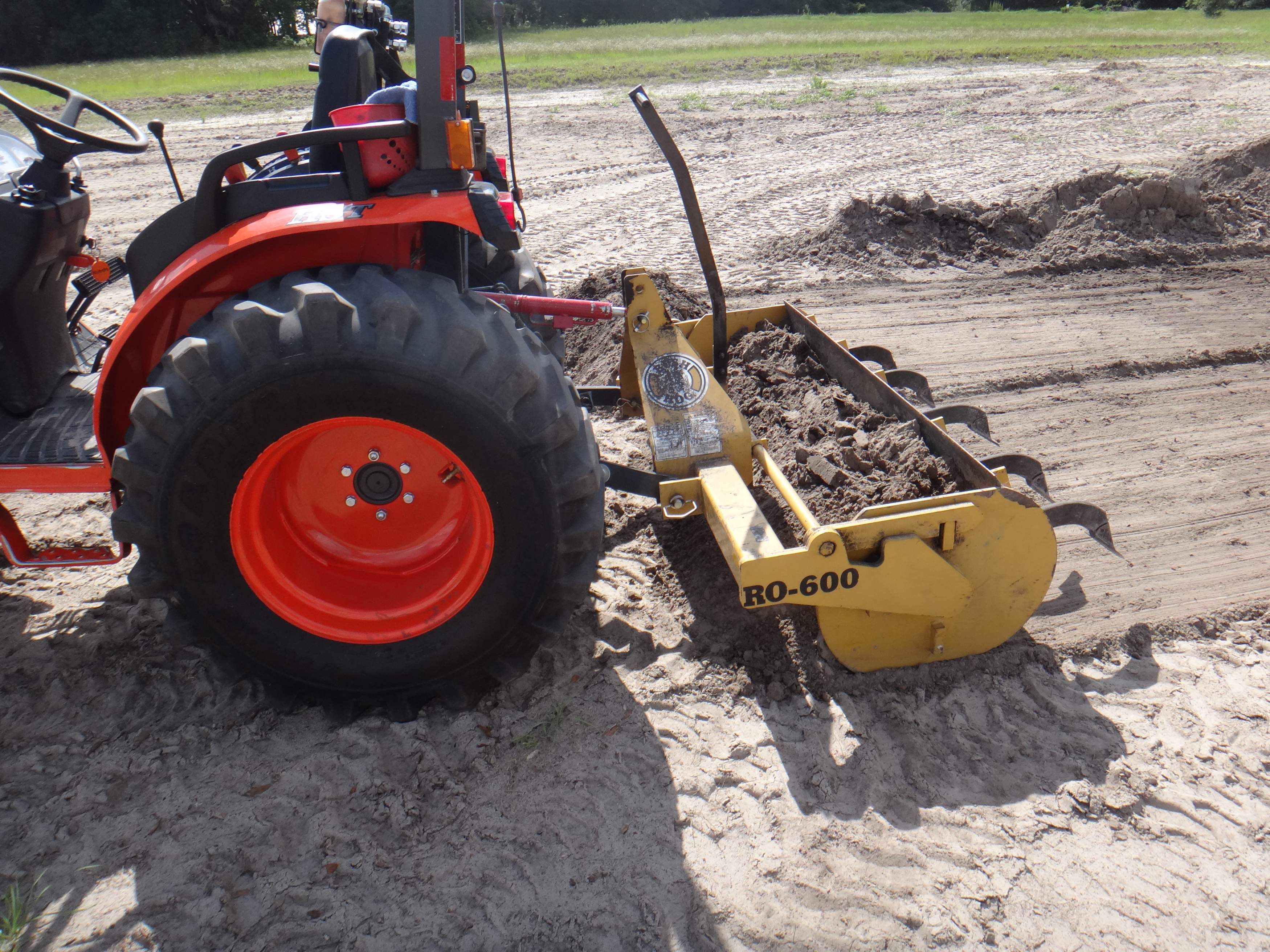

A HEAVY (100 pounds per foot of width, better 125 pounds per foot of width) Box Blade with scarifiers would be good. Buy heavy so you can dual purpose your Box Blade as Three Point Hitch counterbalance when using the FEL.
I like counterbalance weight equal to around 66% of FEL lift.
Box Blade scarifies are designed to penetrate only 5" to 6" for chipping out pot holes. If you go slow, scarifiers should not be damaged and will prize out big rocks down to 6", which is pretty good prep for pasture grass.
After a few passes with the scarifiers, picking up 3"+ rocks between passes, you can use the "box" to pull your sandy soil into the old and new depressions.
Consider both traditional "square" Box Blades and "Rollover" Box Blades.

Didn't think of looking at the ratchet rake the one in the picture looks like it would work well.
