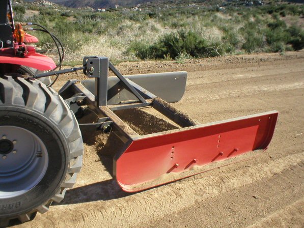

If the snow blower has worked well for you, then I would get the LPGB. but that is just me.;)

you have a "land plane" MtnViewRanch shows in a picture. in idea it sifts the dirt and gravel. letting dirt fall down and bring rock up to the surface. suggest getting one that has adjustable blade heights
