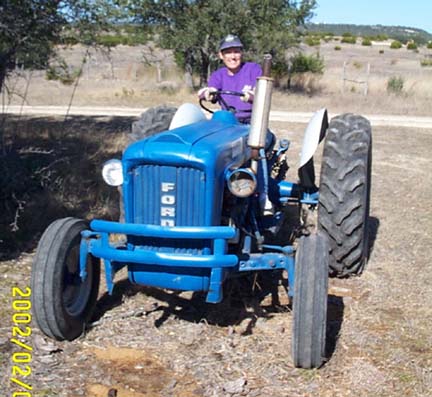

Soundguy, you may be just the guy I'm looking for. This was a picture of the Ford when I bought it. I haven't been too successful in digging up information on her. The fellow I bought it from told me it was a '58 and he had a decal on the side of the engine cowl that reads Ford 2000.
Tell me what you can about it. It is a gas 4 cylinder. I would appreciate it. By the way I still have her, the tractor that is, and the pretty lady on it as well.

Here's some info on the tractor....
TractorData.com - Ford 2000
Actual drawbar hp = 26.5

The sheetmetal is pointing toward 63/64 2000
Post the numbers and codes stamped ( not cast ) into the bellhousing flat on the left side, right where the starter mates up. there will be 2 tapped holes int he side facing of the boss i am talking about.. there should be a model iD number and sn, and date code..
The probelm with dating by sheet metal is that so many things can be changed around. The 134ci engine was used all the way back from late 52 thru 63 for instance... IE.. you could dress a 1953 NAA up in the wrong sheet metal and take a pic and make it hard to id it.. without seeing key aeas like rear axle hubs, and tranny bellhousing, and dash.. etc.. heck.. might have had a 172 or 192ci eng swapped in, and have a but load more hp.. more like my 840.. and be similar to an early 4000 .. etc. Post them numbers..

I get home at 11:30pm tonight.. when I do, I'll plug those numbers into my manual and see what ya got.
I have the post 65 thousand series memorized.. but not the 63/64 4 cyls thousand series.. or the early industrials.
The 63/64 2000/4000 and early industrials are kinda the red head step children.. as they weren't much more than updated 601/801 tractors.. ..with some exceptions onthe industrials that may have had different front axle setups.. etc..
Soundguy
/ Box Blade Rebuild #11
Eh.. droppe dby the house on the way back to work
21201
2= 134ci gasser
1= ag or industrial 1963-1964
20 = 4 wheel all purpose type with adjustable front axle
1 = 4 speed trans with pto
It's an early 64 model with the sn of 42338
(38xxx started 1964 sn's..)
Soundguy
