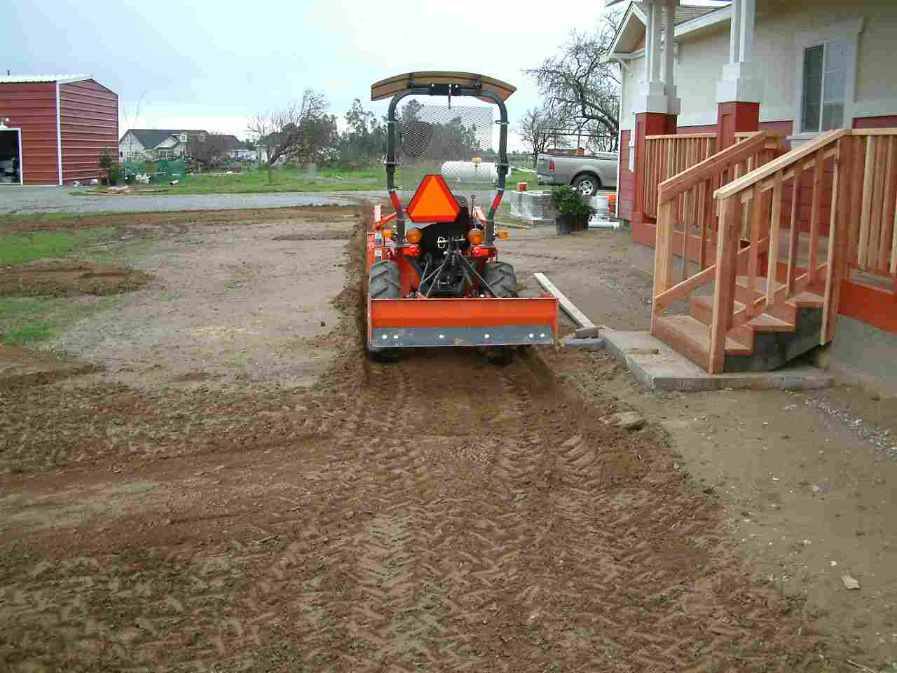

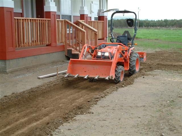

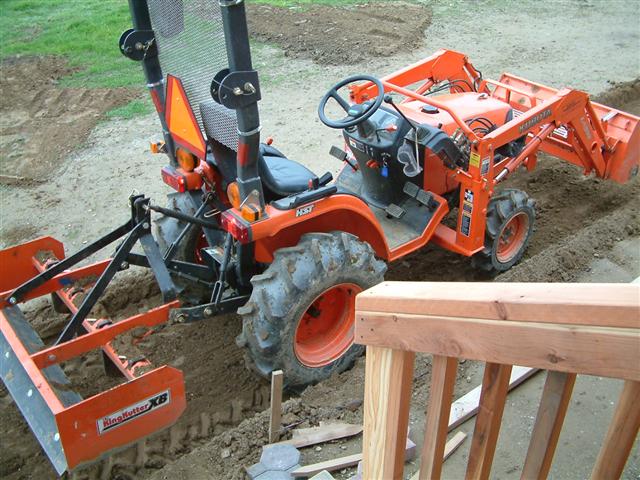

When I was landscaping my new house a few years ago using my Kubota B7510HST (21 hp engine, 17 hp pto), I used a 4-ft wide King Kutter box blade. Found this was the ideal size to excavate for paver block walkways.
I suppose my 7510 could have handled a 5-ft BB OK, but I never tried it.
