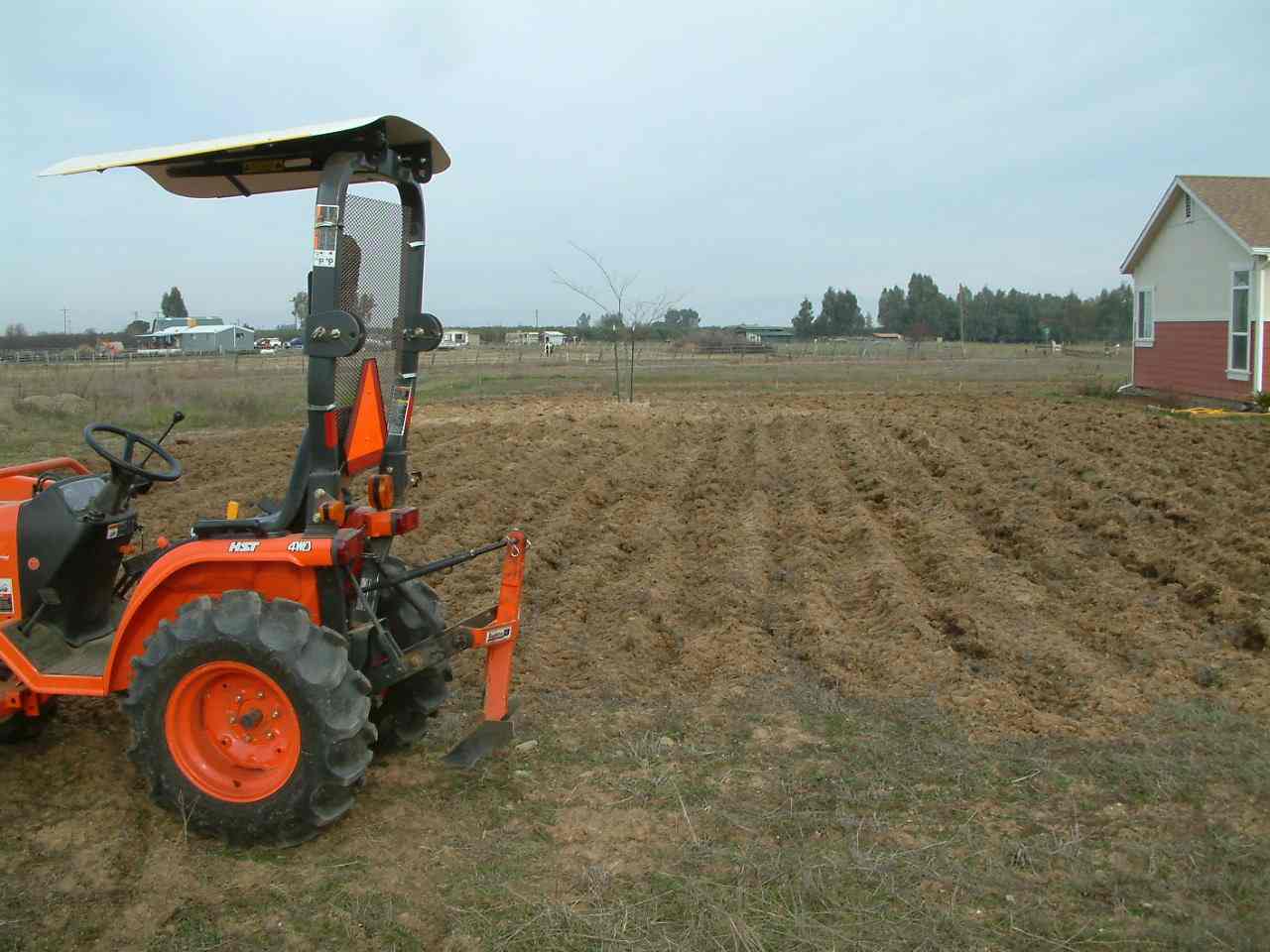

Box blade is the wrong tool for your job. Plunk down $140 and get a King Kutter middle buster/subsoiler combo and get the job done the easy way. You'll have other uses for this implement for sure.
I have a veg garden about your size. Took about 30 minutes to break up the first 6" of soil with the middle buster plow and my 21-hp Kubota B7510HST.
Of course, you need to rototill the garden after plowing no matter how you initially bust up the soil (unless your planting in sand). I have a walk-behind tiller from Home Depot and a pre-owned Yanmar RS-1200 rototiller (4-ft wide) to use with the 7510.
Right now I'm installing lawn landscaping around my new house. I used the middle buster about 10 days ago to break up the ground prior to rototilling with the RS-1200 next month and planting the grass (see photo).
